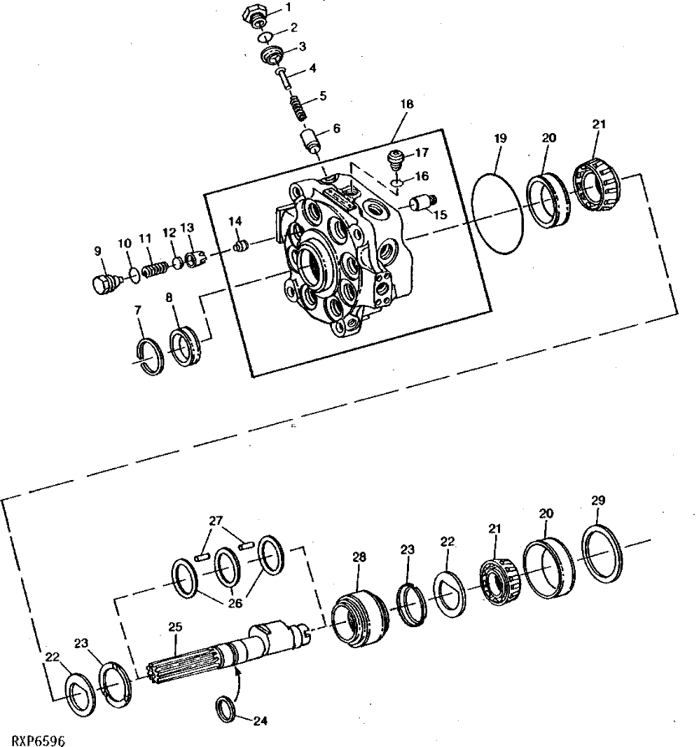

I don't know what wear plates your mechanic was referring to as I see NONE. Here's the JD dealer price I found RE565679 Hydraulic Pump View/Update 4,190.97 USD
/ John deere 410C pump
I believe that diagram is of the charge pump, not the main pump. the main pump has brass wear plates and comes apart in 4 sections.

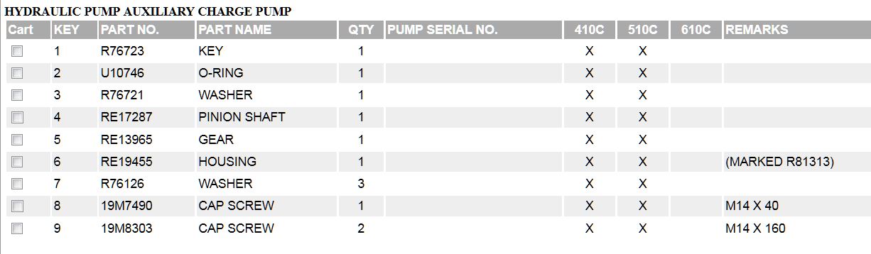

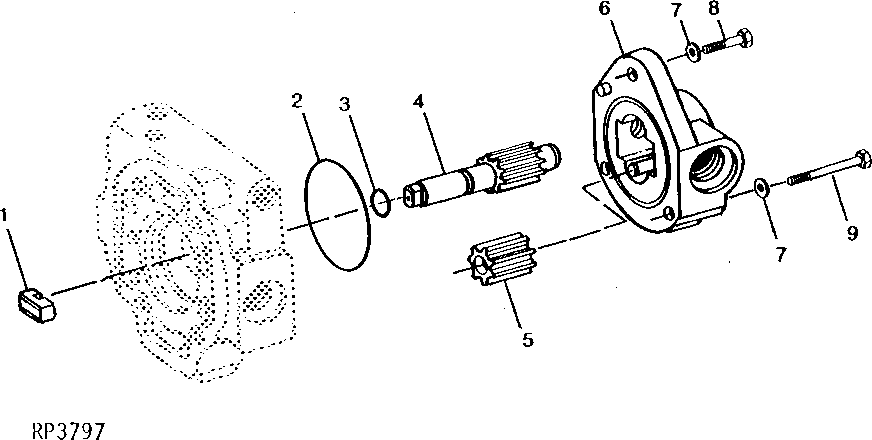

Possibly the other way around as the pump in original parts photo can't suck oil so it isn't a charge pump. The charge pump I saw for a 410C is a gear pump with no wear plates. I'll post a photo of the 410C charge pump. Are you positive your machine is a 410C??

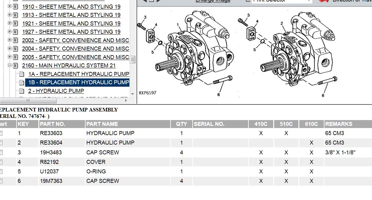

According to JDparts.com RE33603 subs to RE565679 which is the pump in the 1st parts photo I posted. Did your mechanic actually show you the wear plates in question? If your pump housing isn't cracked then more than likely your pump can be resealed.
