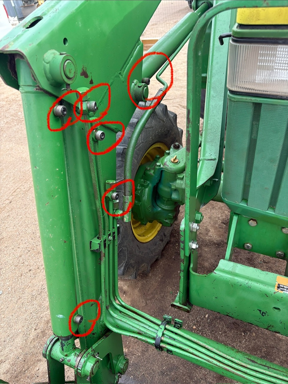

I have a 2000 John Deere 990 with the 430 loader. I removed the three hoses from the left side of my loader and being the dummy that I am, totally forgot to take a picture of the hoses and routing prior to removal. I have the new hoses, but I need help with the hydraulic routing. I'm searching online for manuals and videos, but I'm wondering if anyone owns a JD 430 Loader and if you'd be willing to snap a few pics of the left arm and hose configuration and send them to me? Thank you in advance.

It's pretty simple - look at the right side connections and you should see which lines go to which cylinders and match them.
E.G. the lift feed is one line feeding both sides, same with the bucket curl. just look at the metal lines/right side to see where the hoses go and match that.
