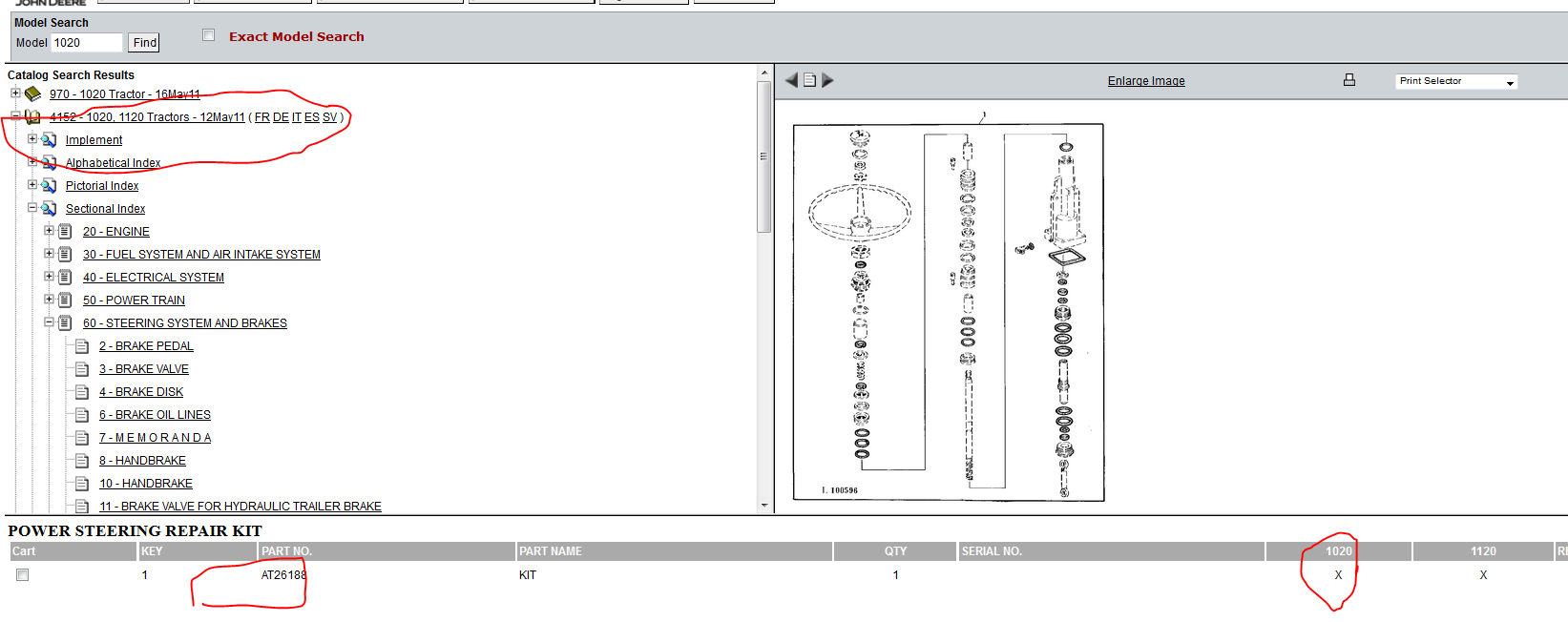

AT26188 subs to AT315816 which should fit your tractor just fine. Please overlook my poor control of mouse while attempting to make red circles as I have nerve damage that limits good control of my hands.
/ JD 1020 power steering
#82
I can see verry well. Thanks for the scheme and for giving me a lot of usefull information and online help. Did you use the JD parts catalog?!
Now I wait to be delivered the repair kit / meantime I use the tractor whit the new longer PS: haymaking, hay shooting, baling ...
/ JD 1020 power steering #83
You're very welcome. Yes I utilize parts catalog. Having being formally employed by a JD dealer for over 21 yrs and served as a parts person for part of that time I understand JD's parts system better than the average person.

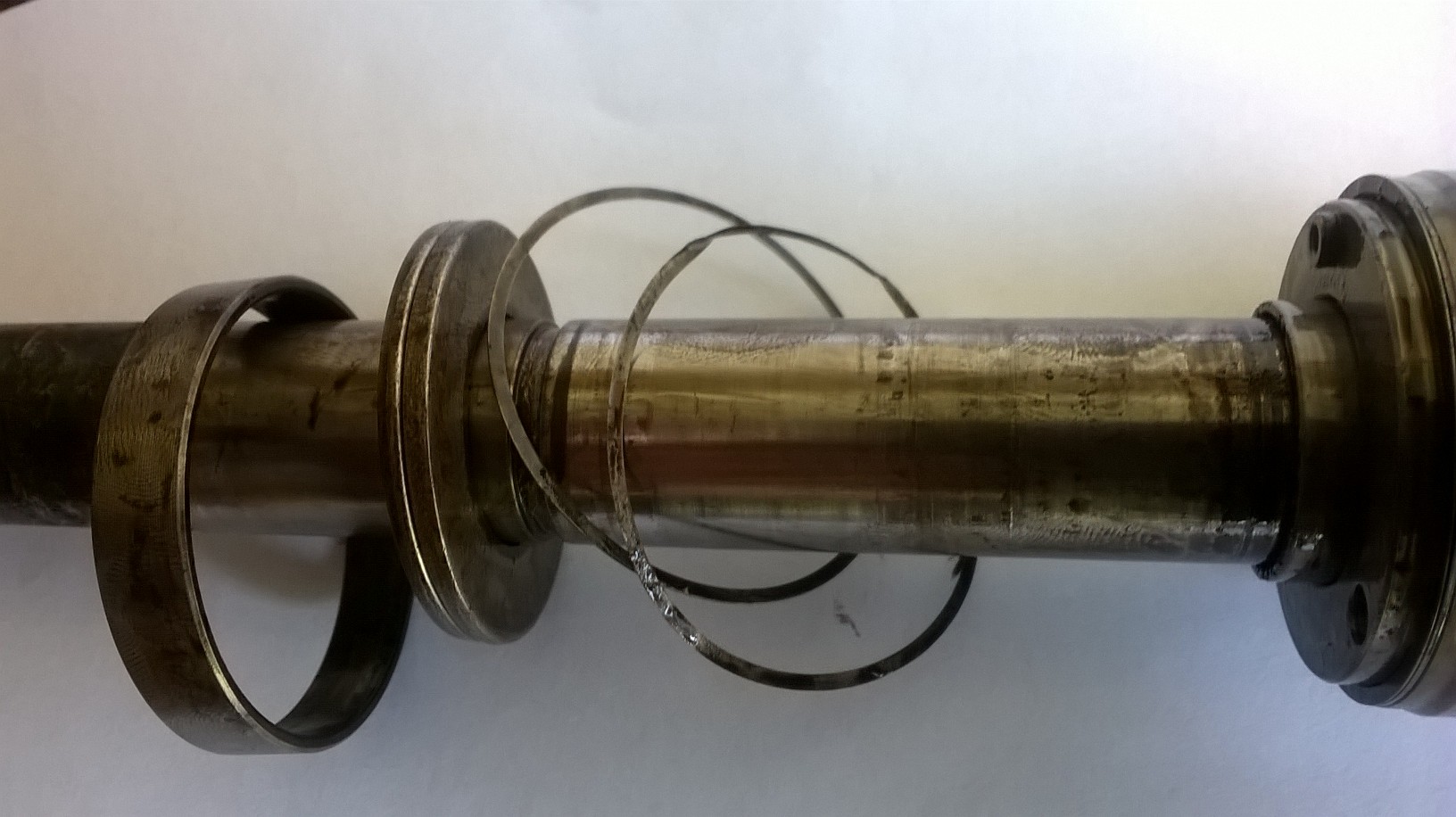

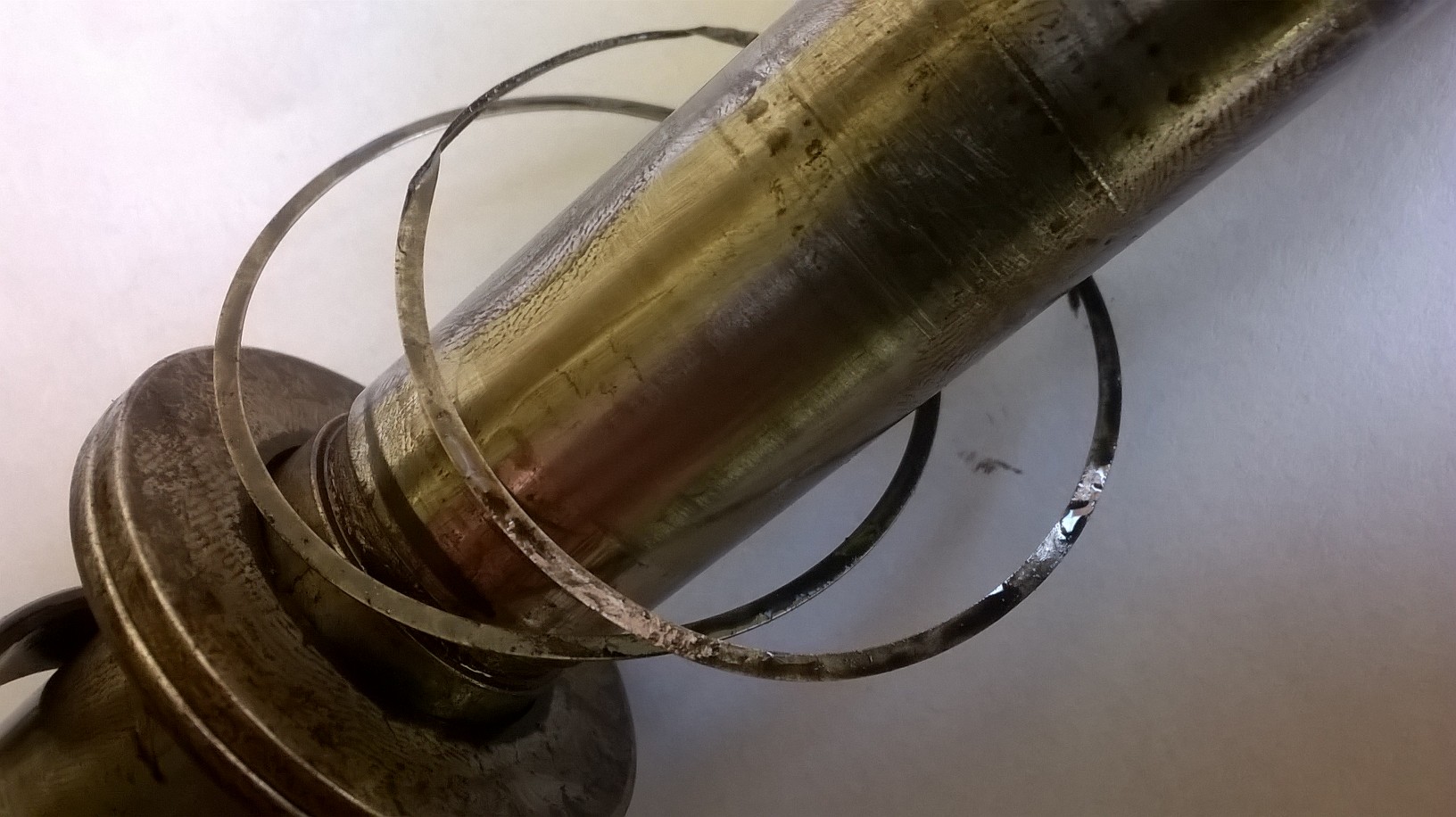

#85
Hi,
Could you please look from the code of the thick rings from the pictures - I tried but I could not idebtify them correctly from the online JD part catalog---
Thanks,
B.J.
/ JD 1020 power steering #86
B.J.
I don't remember ever seeing those metal shims in your photos nor do I find them in parts schematics.
Jim
#87
I found same codes...but when I searched on the Google on the major pages there are no photos and so I could not identify them. I am going to try again..

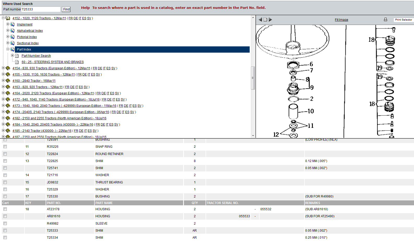

/ JD 1020 power steering #89
There are 3 different thicknesses of shims. .002" is part number T25333, .010" thickness is T25334 and .030" thickness is T31290. The parts breakdown for a 2240 shows the shim part numbers. It is the same size shims.
/ JD 1020 power steering #90
jd110
Thanks for the heads-up. Actually the part numbers you listed are in the 1020,1120 parts catalog but are included in parts key 18 which is the control valve and I never thought to look there.
