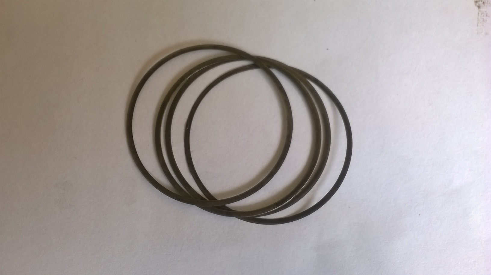

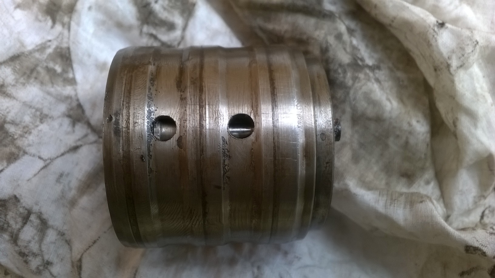

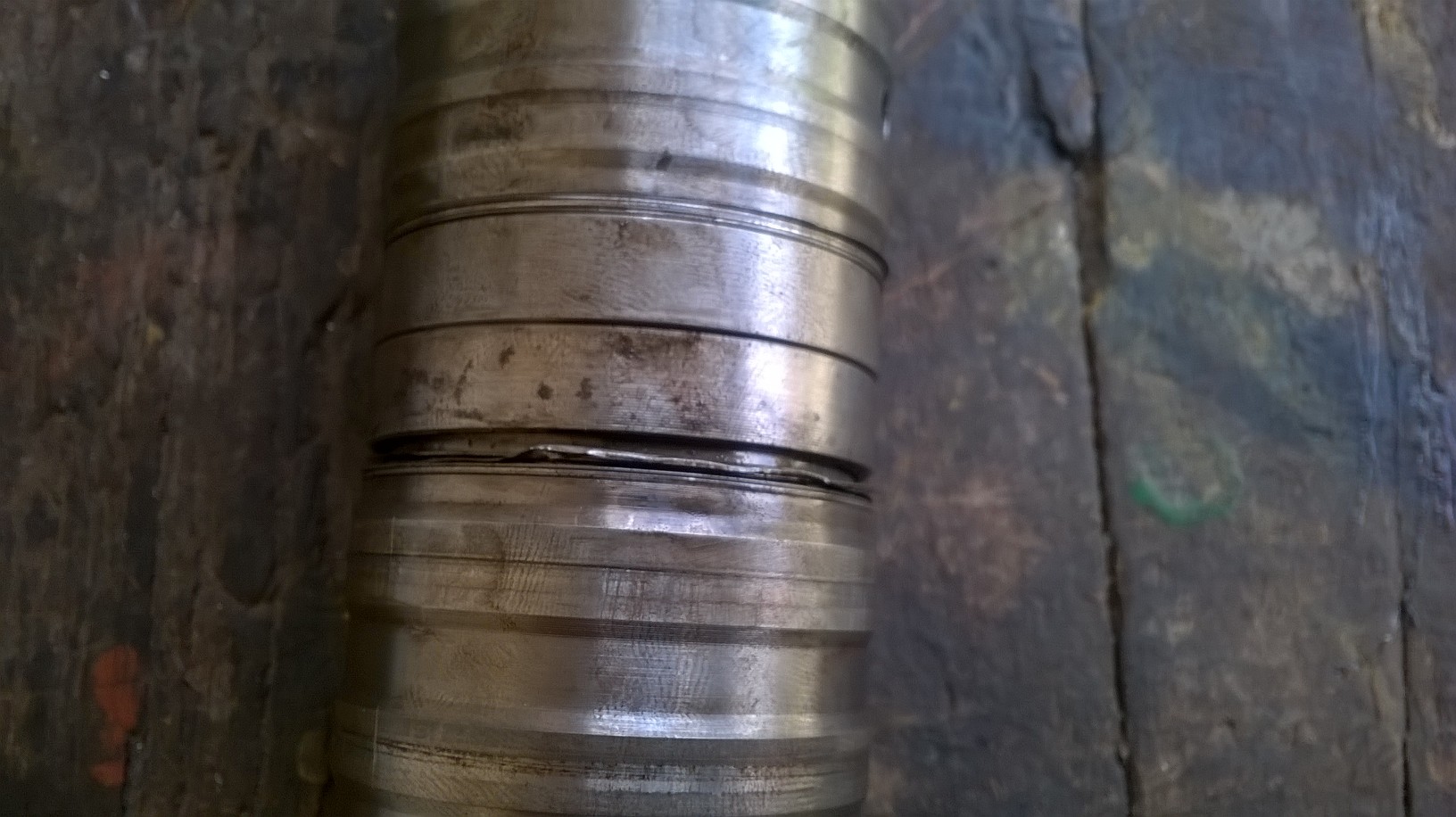

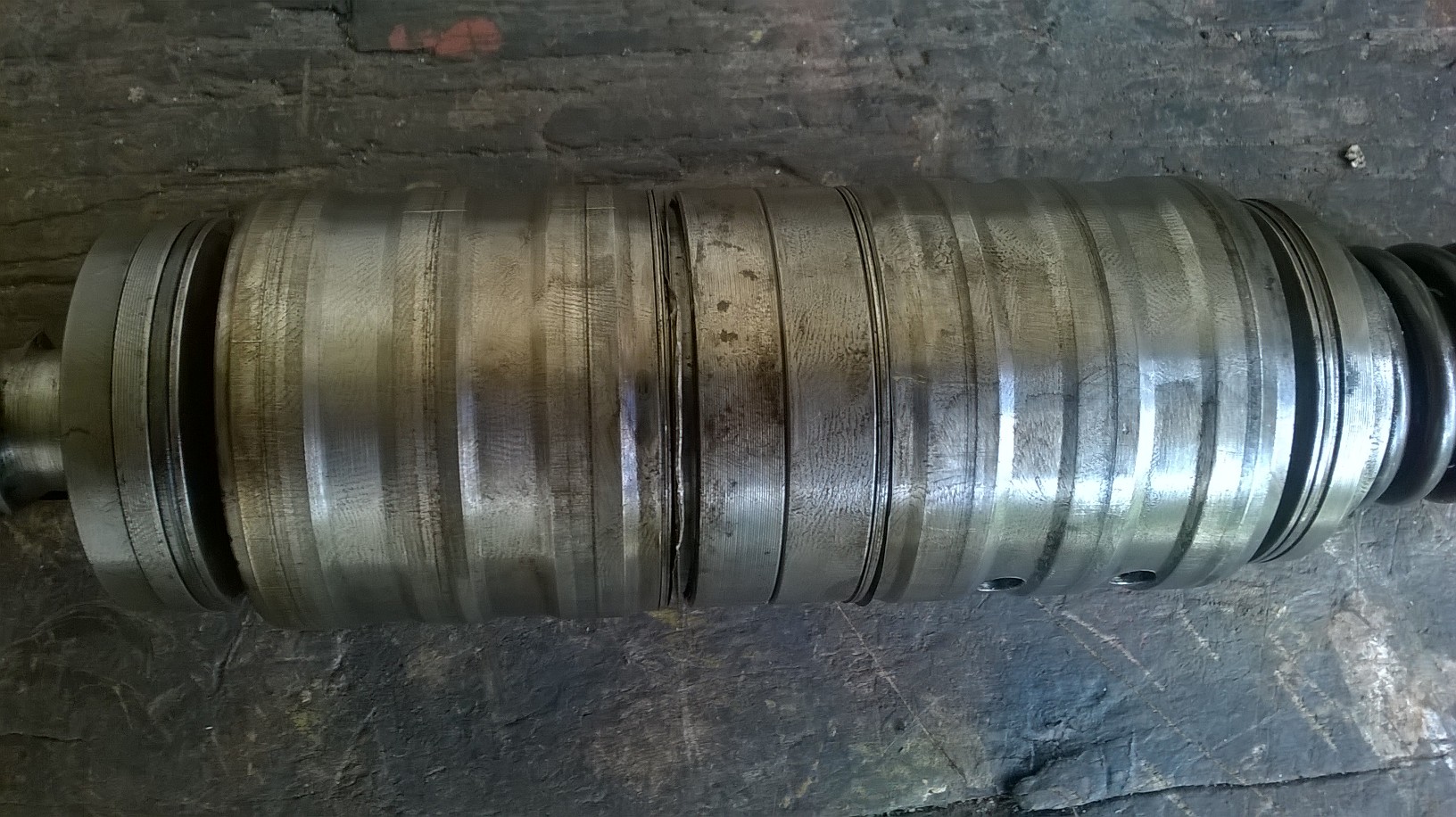

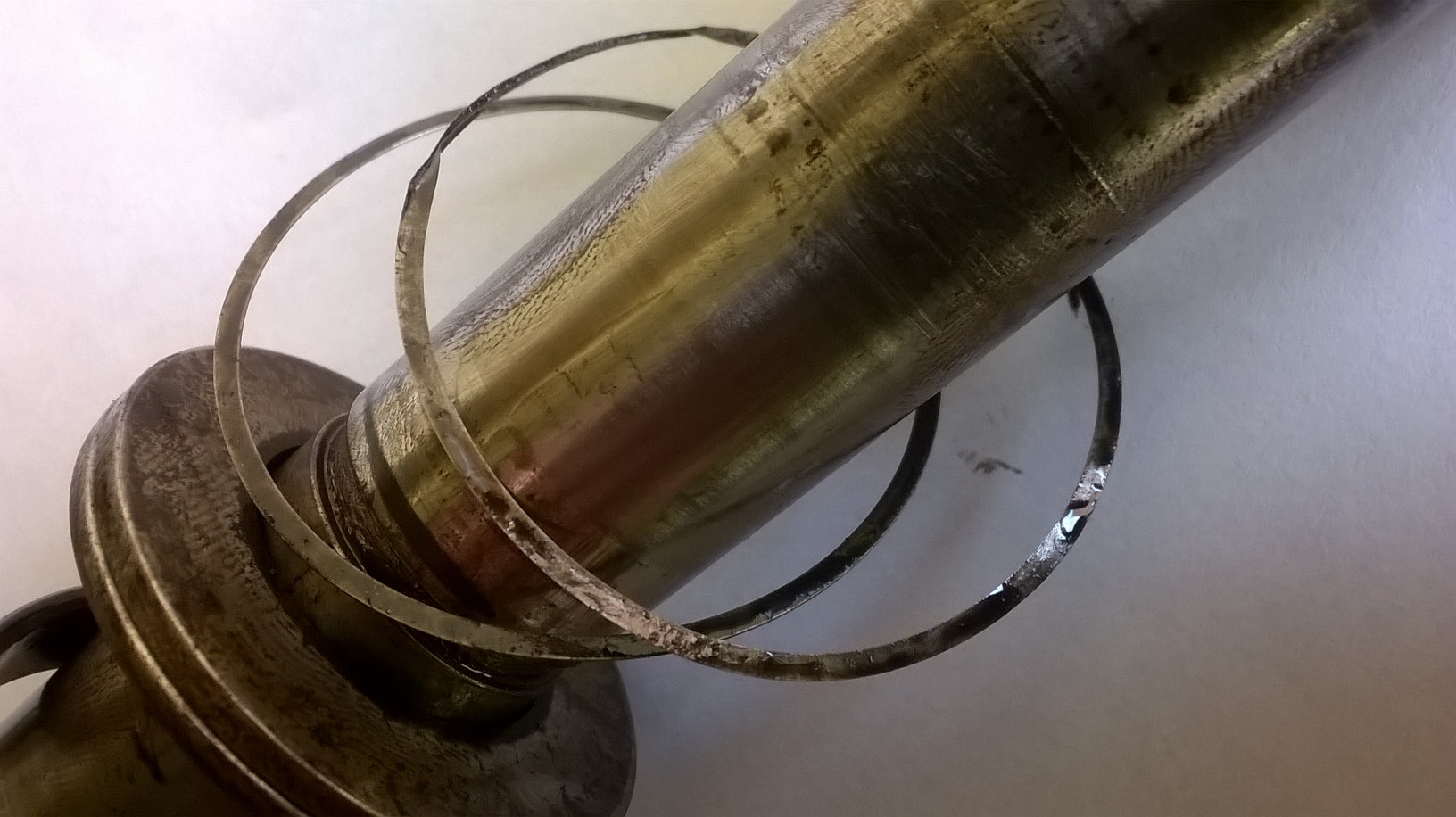

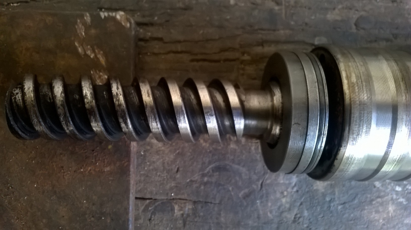

I removed the senzor shaft and the old, worn-out seal components. Now I want to replace it with the new seals and fix it with a totally new shaft, axle....
The Teflon rings are hard-how can I put them in their location... How could I soften them... should I put in worm or hot water before... or what should I do....
The L/D lever under seat is positioned in D, I need just to plug in the new shaft to its place and the job its finished?!!!!
/ JD 1020 power steering #142
Warm the teflon seals in warm water. Apply hyd oil to shaft prior to installation.

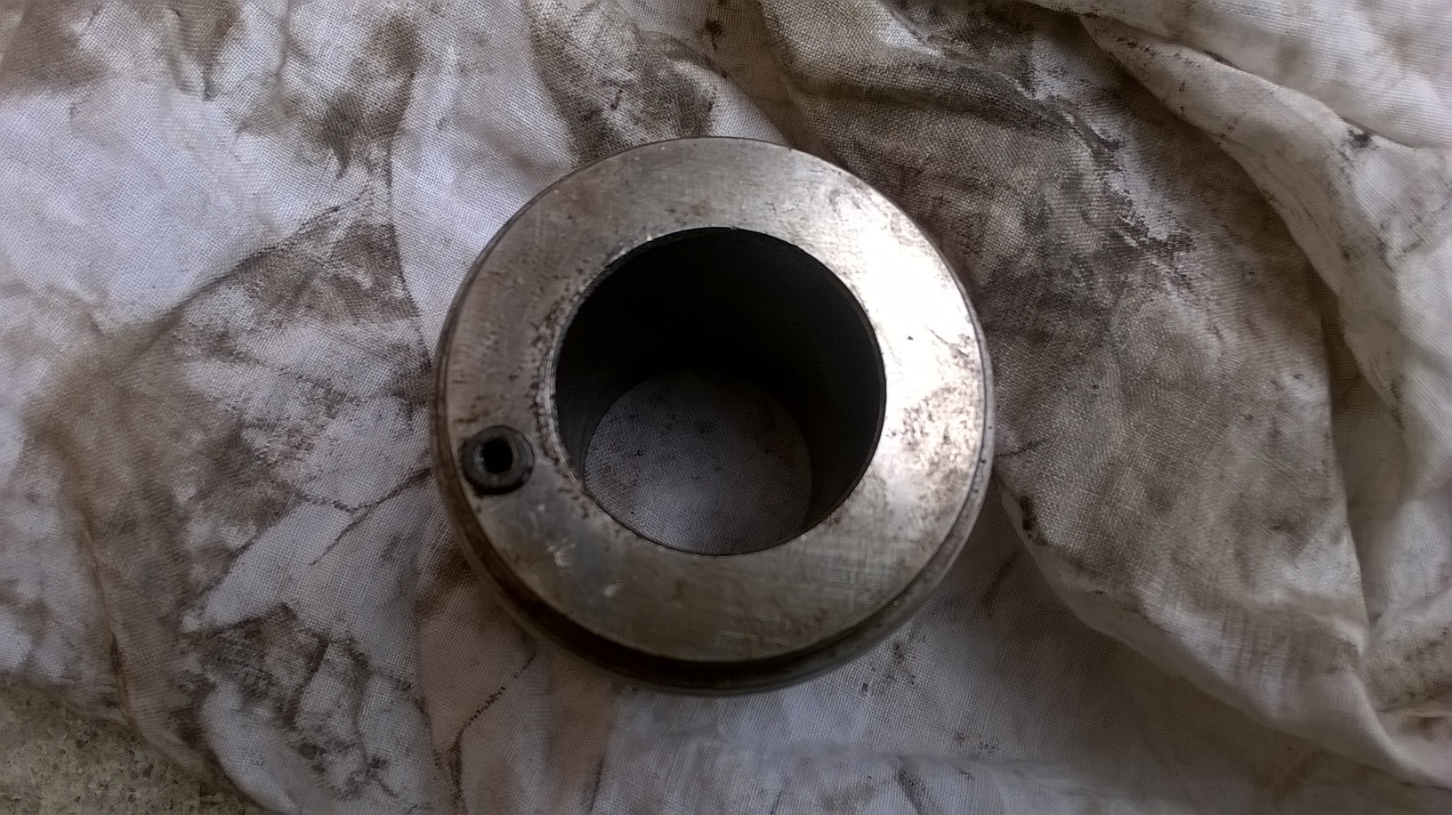

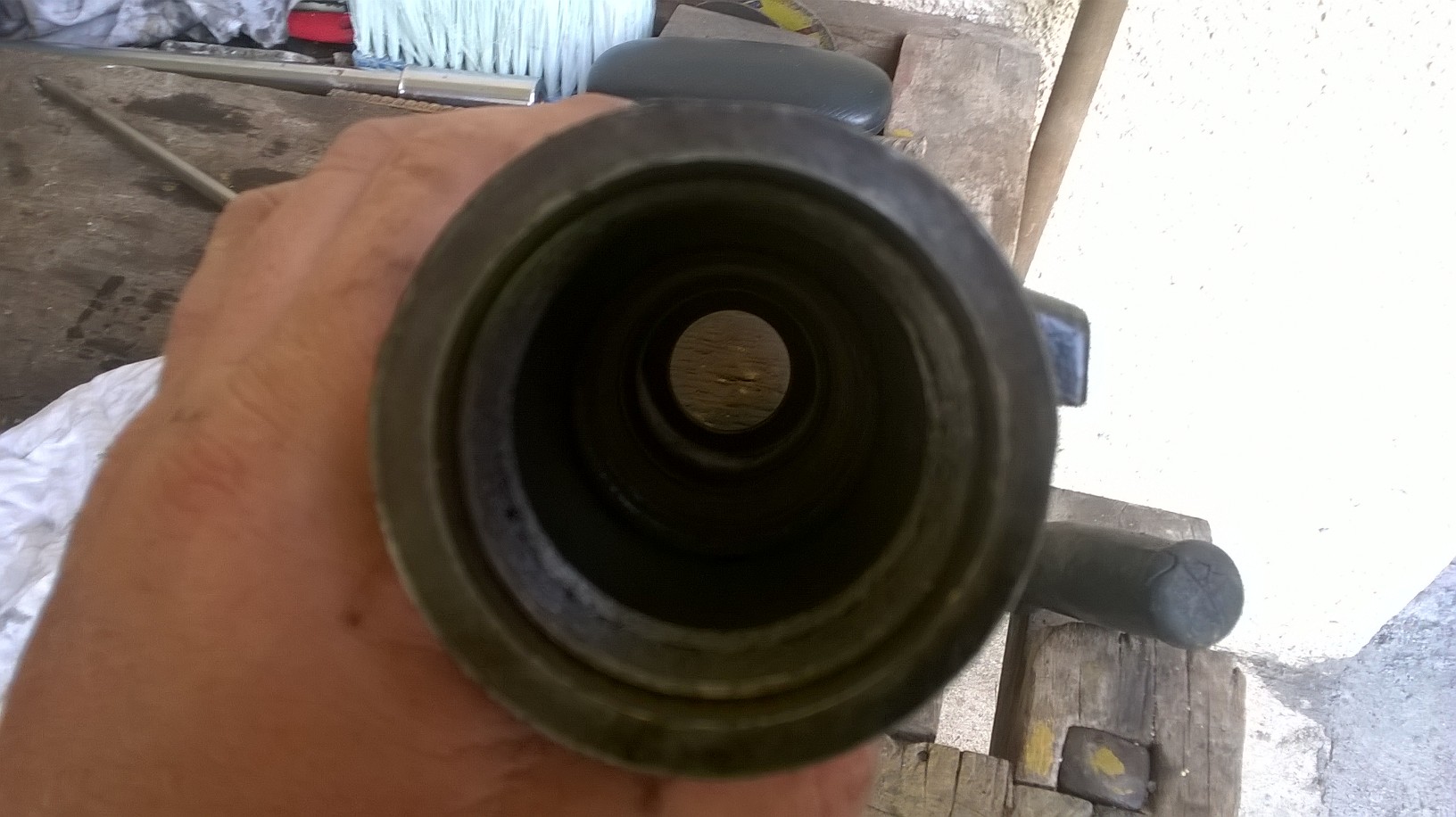

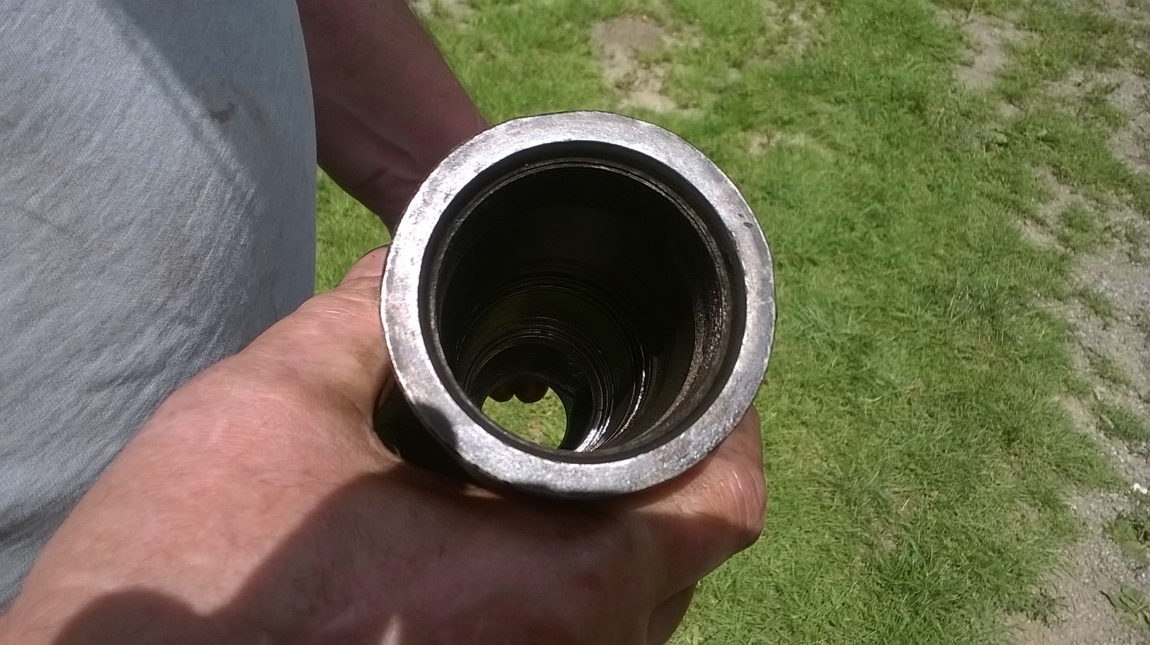

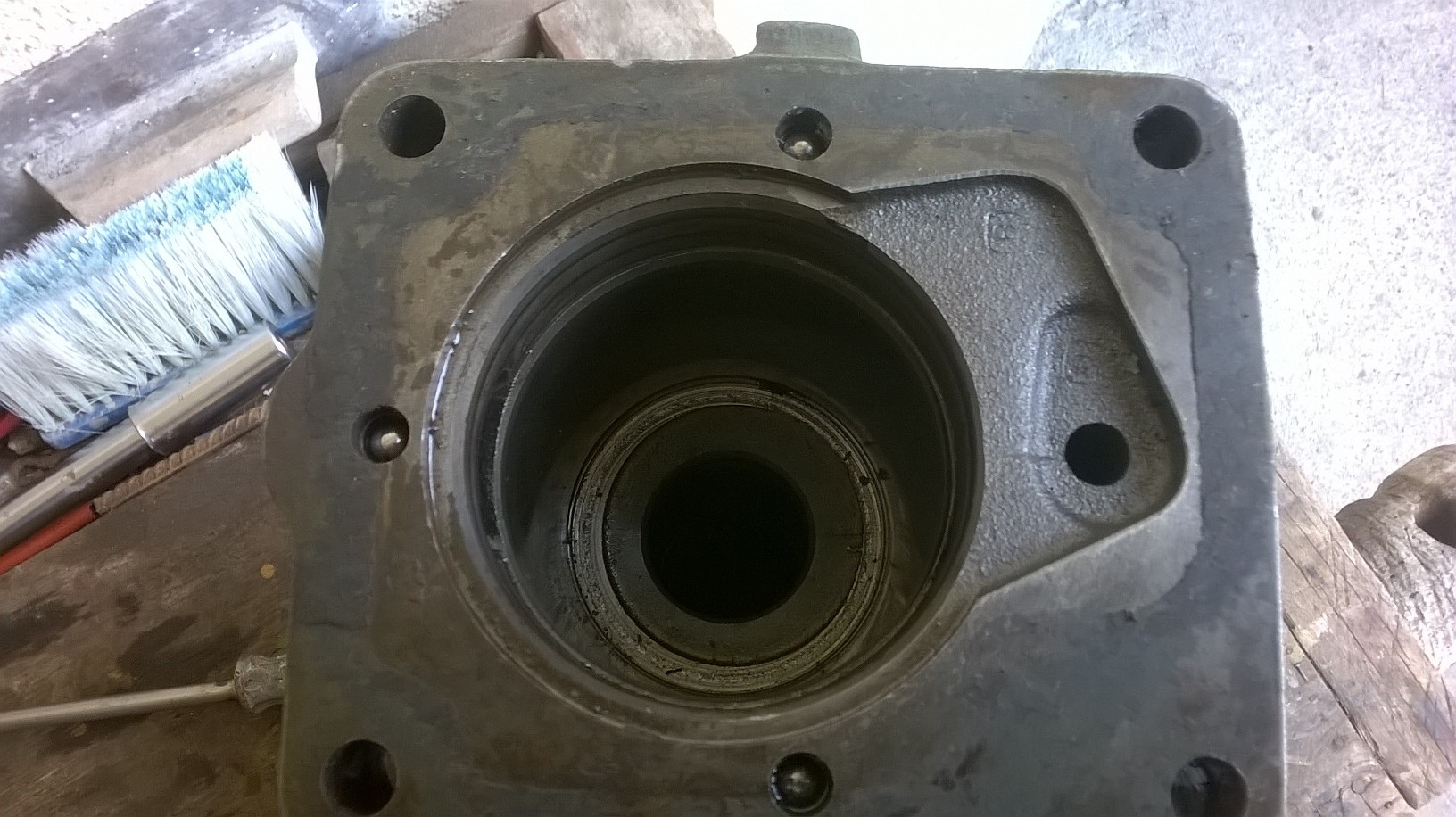

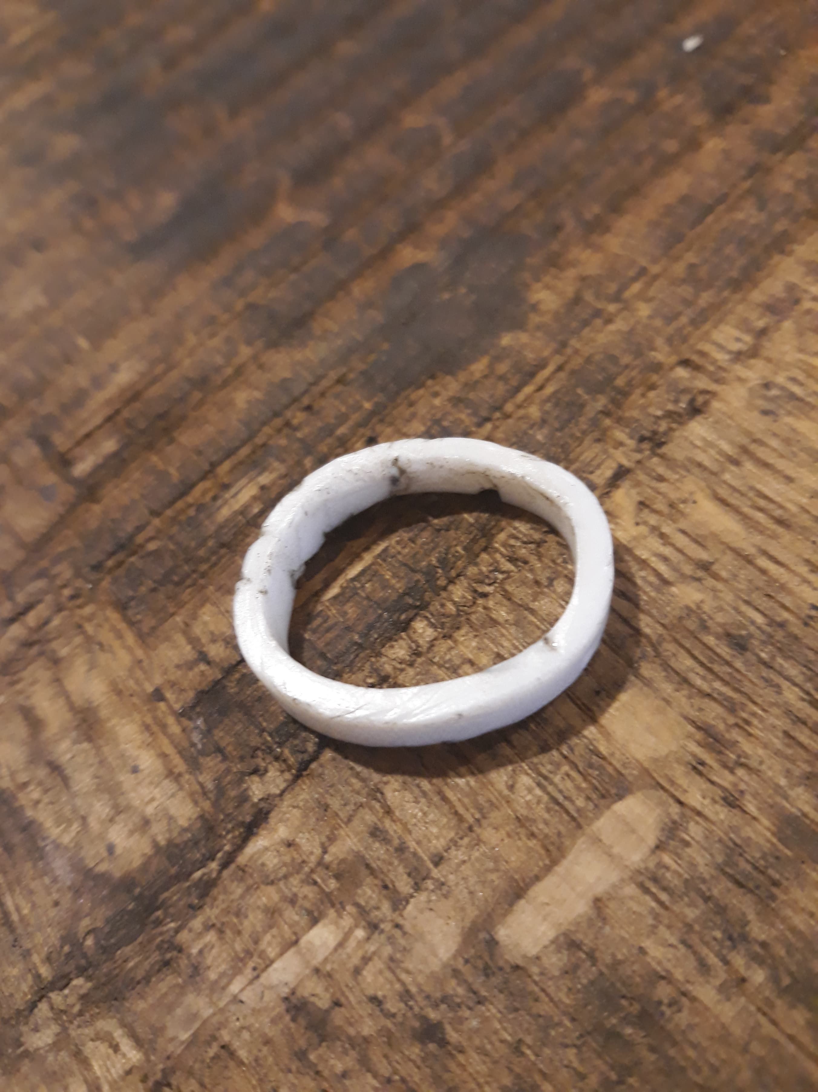

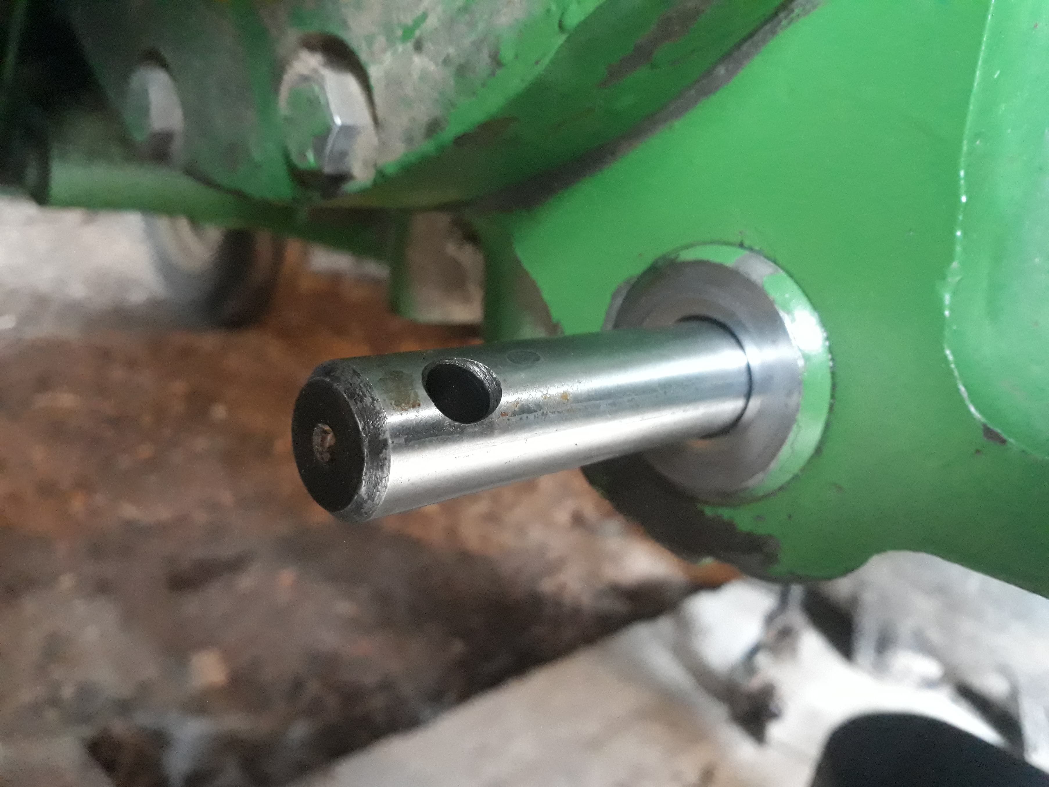

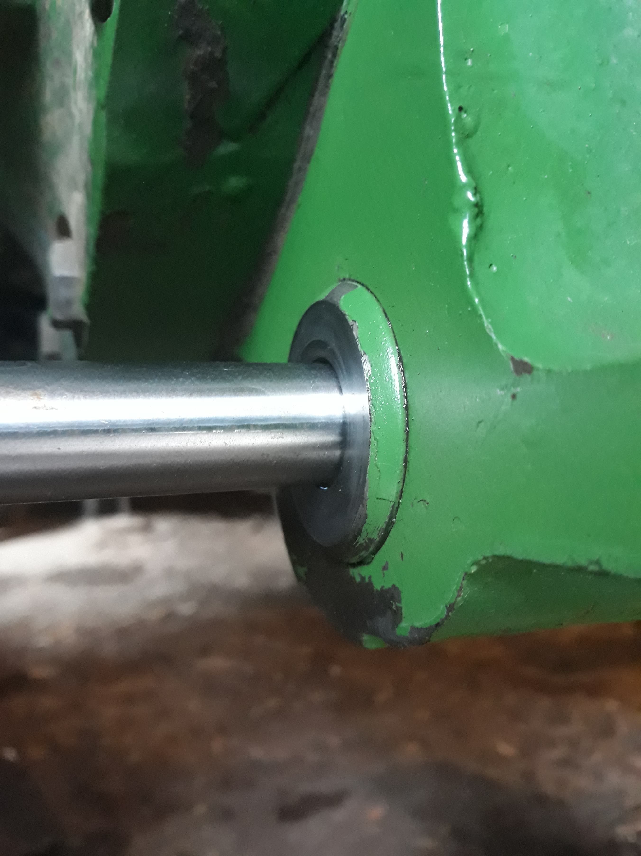

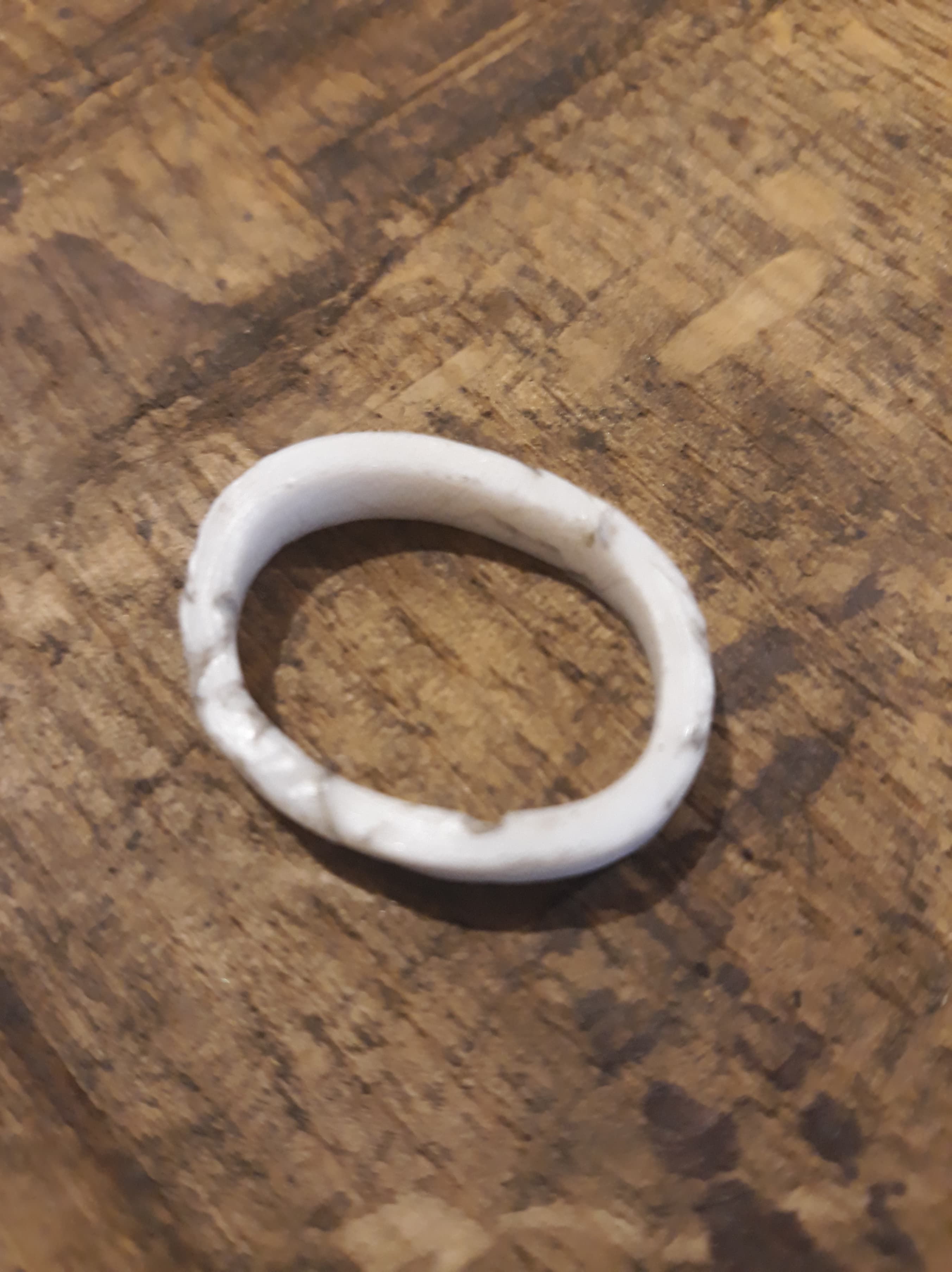

I have quite a lot of problems.... I put in the O-ring to there location, after that warmed the Teflon ring in hot water, but I did not really manage to put it in.... After trying more times, the ring was damaged.... Finally, I put the other ring, inserted the new shaft / soo one side is fixed and its seems to me quite good. Now I dont have more rings, soo I already ordered new ones.... Soo now one side of the shaft is fixed, and for the other side I wait for the new plastic rings....
In my opinion, it could be fixed perfectly and easily if I would pull out the entire T22097 bushing... I am right?!

Why do you think removing the T22097 bushing will solve your problem? John Deere specifically advises against doing that. The reason is the bushing is pressed in. R & R of it could cause it to wear the transmission case where it installs and cause a leak. Or too loose a bushing.
Did you heat the Teflon ring in hot water, then bend into a "C" insert and open back up to round?

Yes, I understand, I will put sims between tractor bushing and the lift arm... Different thickness of rings, wide and narrow ones, as is needed... We will make with turrning-machine... to have no clucking between the pieces...
You have right again - I also so thought to this but unfortunatelly too late.... If the ring is bended - the diameter will increase....:mad:
The old shaft was too worn-out, it was recomended to be replaced, and it was not expensive, it cost mee only 30 US dollar.

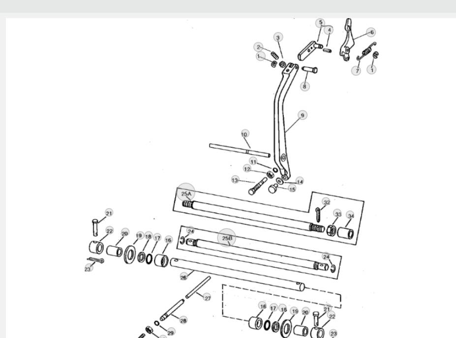

No 19 is the shim. Order 6 of them and add as needed.
Do not make them ! It s hardened shims and not washers !tapatalk_1584003070481.jpeg

Could you tell me a JD-code of the nr. 19 shim?
2 different thrust washers are shown. One washer is 13/32" X 11/16" X 0.035" & the other washer spec's are in photo below. Load control shaft diameter is listed at 0.815''

$30! I should check the cost for my 2030, I figured it would be 5x that price. When I bought shims, ID was too small. IIRC I only saw one P/N in JD parts. I'll have to double check.
Shaft for my 2030 is P/N L26937 $134.82 diameter .877. They list two thrust washer P/Ns. R42929 1.000 ID 1.850 OD .036 thick, and P/N R66197 .850 ID 1.440 OD .036 thick. I am guessing I bought R66197.

I think I manage to resolve the oil leak problem.... Put in the new Teflon rings, refilled with Hy Gard-oil and it seems there is no oil leaking...
Now I am waiting the lower lift arms, they are under reconditioning....
