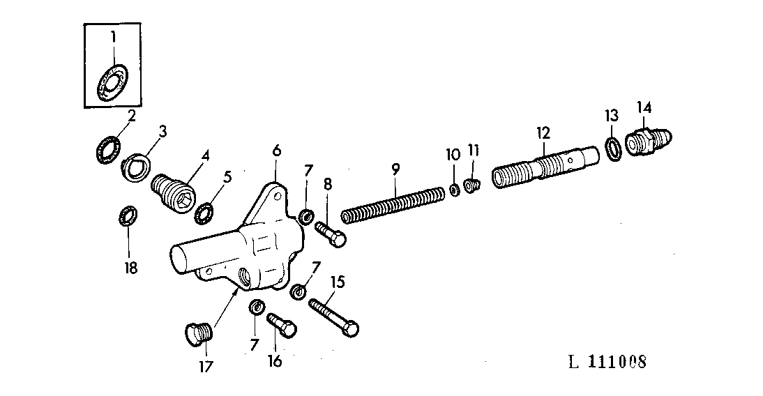

Hi,
I got the O-rings for the oil flow control valve.... So if I remove the three screews (8,15 and 16 from the photo), and I change the O-rings, replace the screews and the job is made with it_?! Is there any possibility to fall of any other pieces as the 3,4 from the photo?!
/ JD 1020 power steering #123
Any place there's an o-ring there's a n opportunity for an oil leak.
/ JD 1020 power steering #124
Hi,
If you are asking if 3 & 4 could FALL during removal of the valve, no, they are screwed into the transmission case.
#125
Thanks for your advice....
So I remove the three screws.......... I put the new O-rings to their places, screw in the screewa and I hove the oil leaking will stop....
/ JD 1020 power steering #126
YES! New o rings should fix the leak. If not, look for something like a crack or pin hole in the valve body.

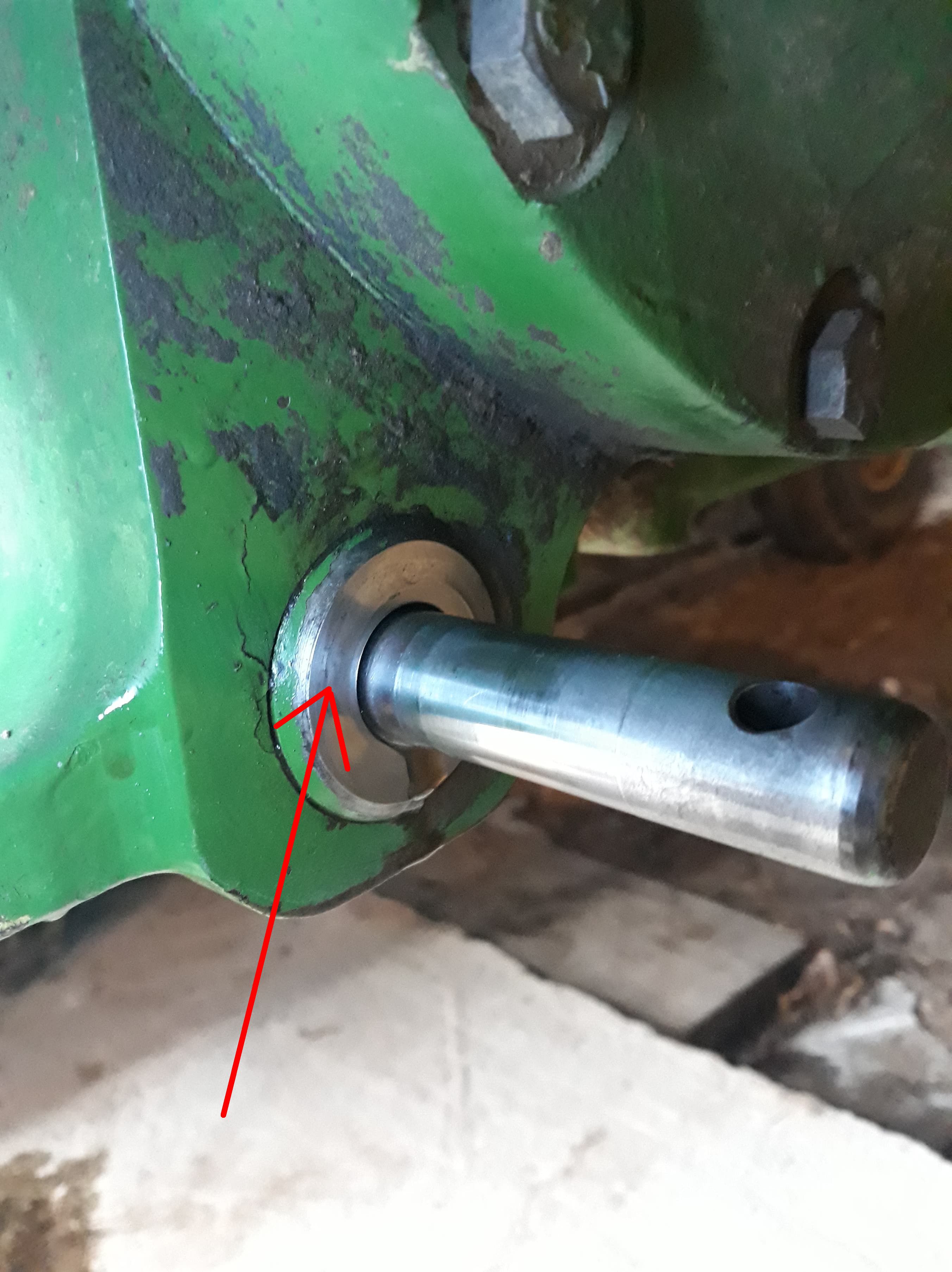

Hello, Jim, thanks for your answer...
My problem is that there is a hydraulic oil leak... in the back downstairs at the suspension of the 3-point... as you can see on the attached photos...
More exactly - at the joint of the shafts.... One of the axle is to blab out...
What could be done? How could I sealed and stop the leaking of the oil? I dont really understand how the shafts are inserted in???!! I cant see nothing from outside / screws or others....
Lot of thanks, J. Benedek, JD 1020 owner

You tractors oil leak is a common problem. The leak is at the load/depth control shaft. One needs to drain the hyd oil,then remove both 3 pt hitch draft arms,place L/D selector lever under seat into "D" then slide shaft out either side,inspect shaft for wear,R&R seals,lube shaft then reinstall it,install 3 pt arms & shim out any side to side to side motion of the shaft. Install hyd oil.
Seal part # is T22098 & o-ring part # is A4730R

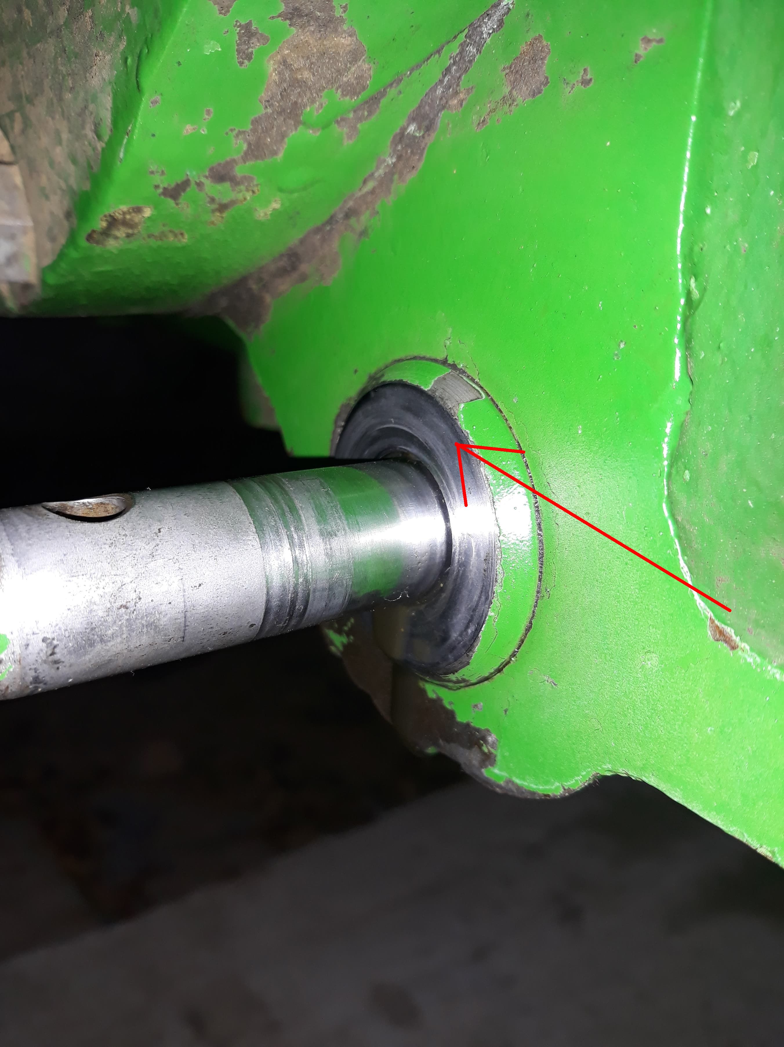

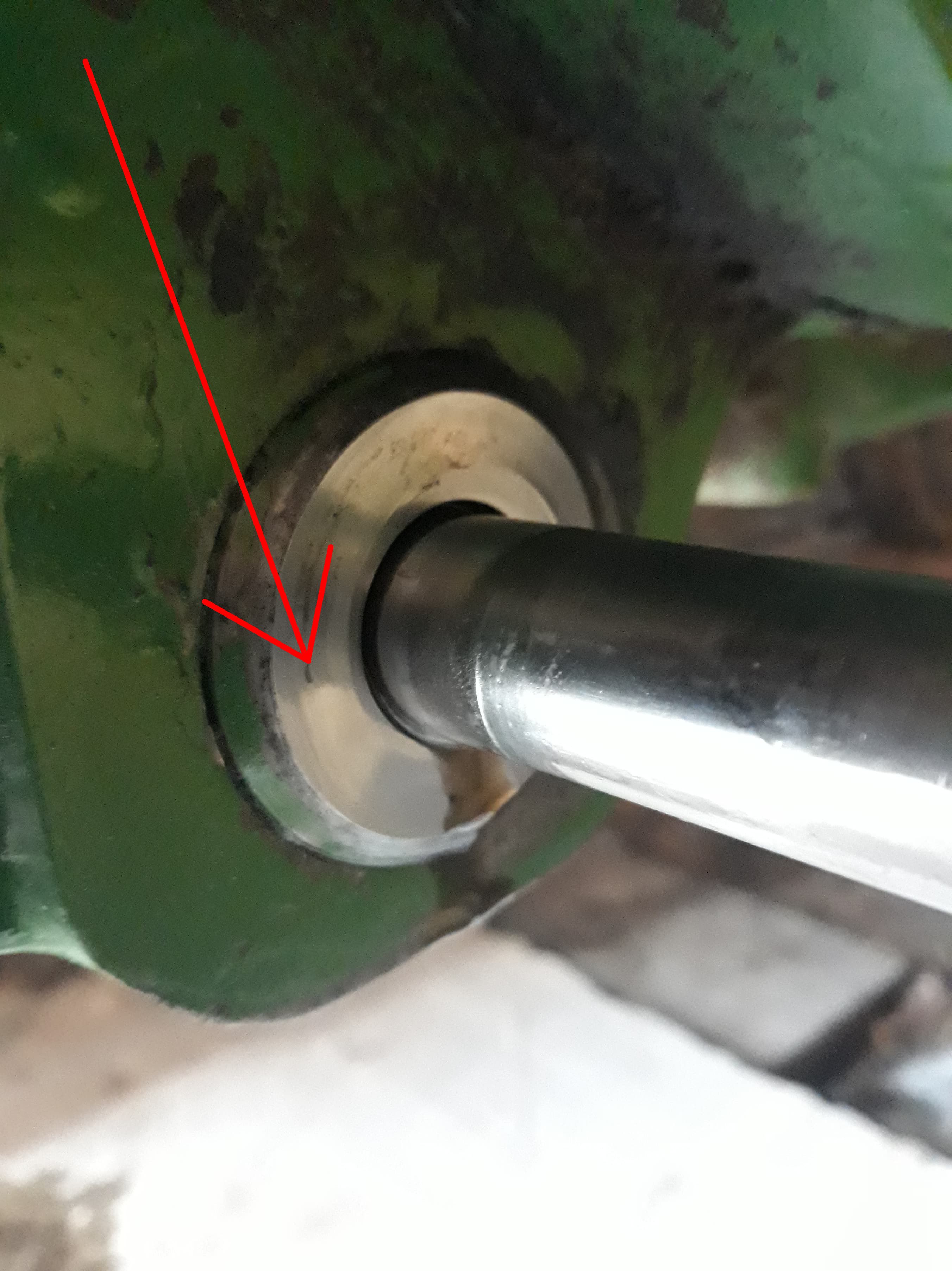

#136
Hello, Jim.

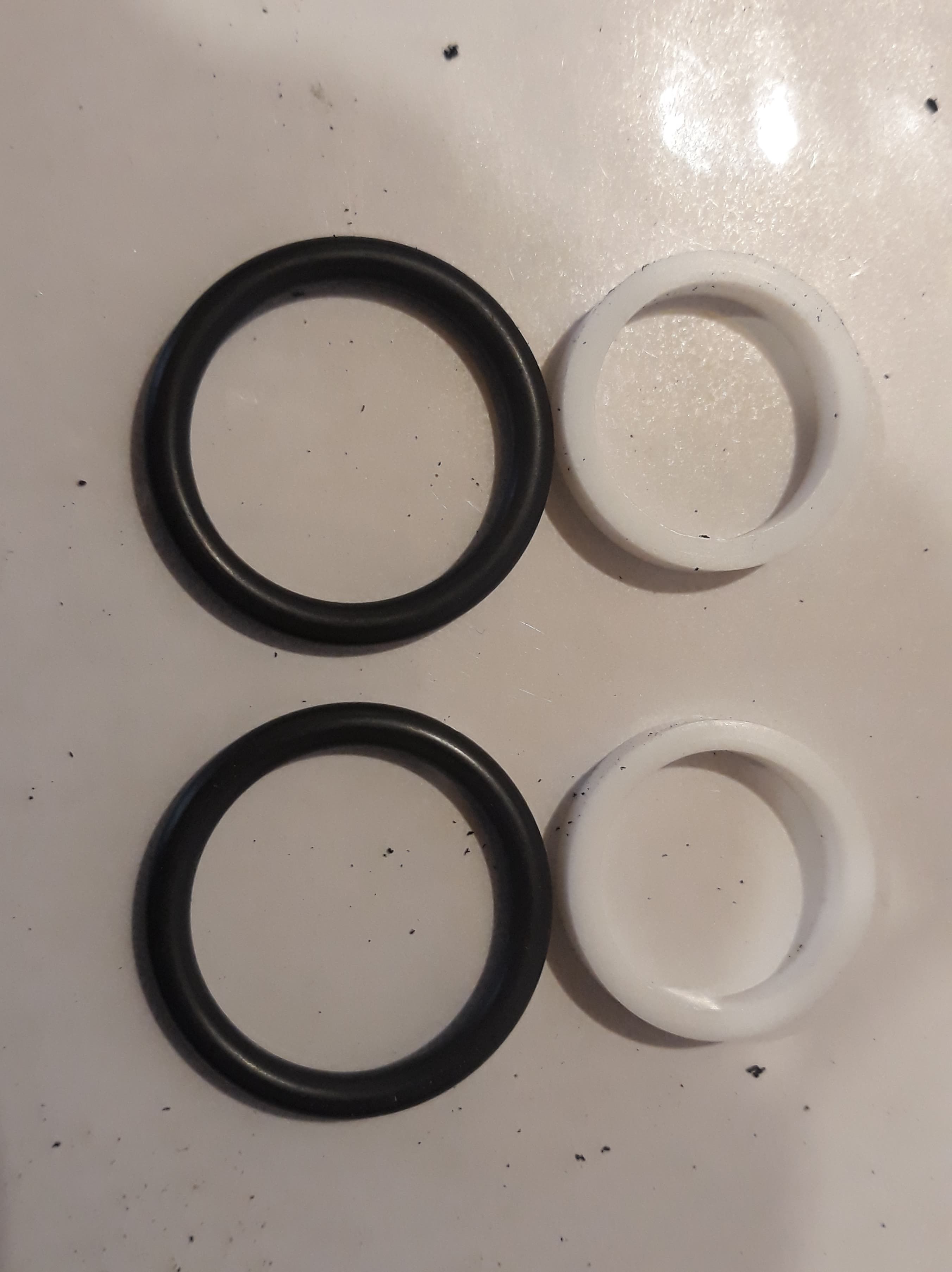

I started to fix the oil leakage problem... as you can see on the attached photos. I bought original pieces, O-rings and teflon washers, but I would like to ask something..
1. I desassambled everything, but there is a piece - which is marked with red arrow on the photos - is like a ring, bushing T22097 or something... If I dont take that out, I cant change the seal components... How can I remove this piece? On the diagram you sent me / I thing this could be piece nr. 19... am I right?
2. I have now one pair of O/rings A4730R and a pair of teflon washers T22098. But the O/rings have bigger diameters than the teflon washers and the shaft diameter? Is this normal, it has to be like this?
/ JD 1020 power steering #137
From viewing your photo's shaft appears to have sufficient wear to need replacing. Yes o-ring fits inside groove in bushing then insert Teflon washer inside of o-ring. One needs to utilize a pick similar to dental pick to remove old seals. Bushing with red arrow aimed at it is T22097
