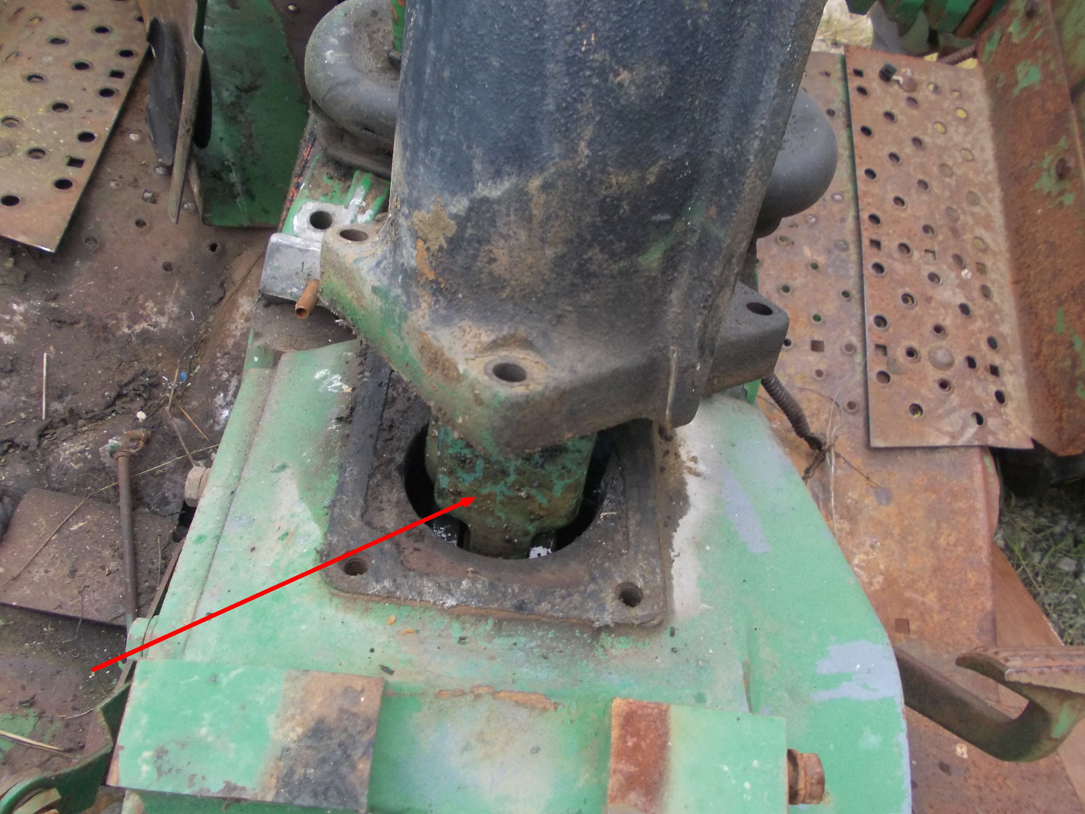

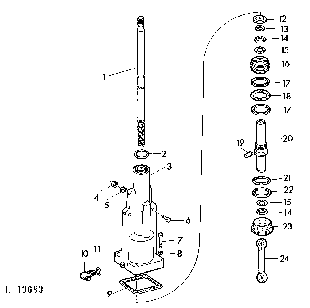

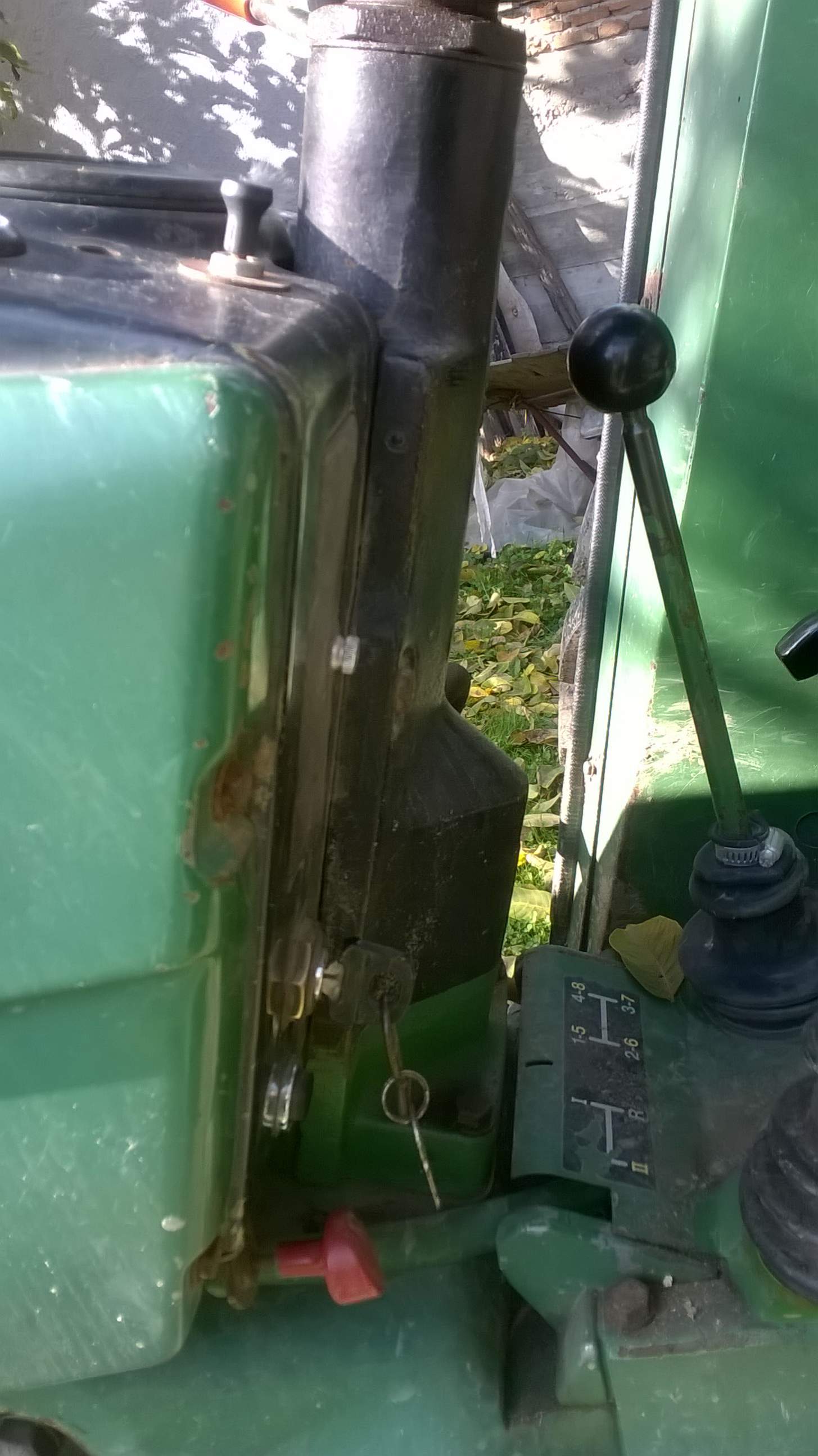

Are you refering to the pieces from the attached photos?!
View attachment 445100View attachment 445101View attachment 445102
And the part key 3 / the gasket - why is....against the oil-escape or against only the powder....
There cant be oil pression - thats whay I ask about this.... Tomorrow I will dissassemble that cover..... The steering is working, but almost only manually..... verry rarelly the PS is working.... Its seems to mee as if some piece sometimes tight or constipated...and moving hardly.........
Some models used open center steering system. The cover was different with a return port in it. The gasket works for both versions. Your tractor has return oil in the cavity you will open up when you remove the cover.

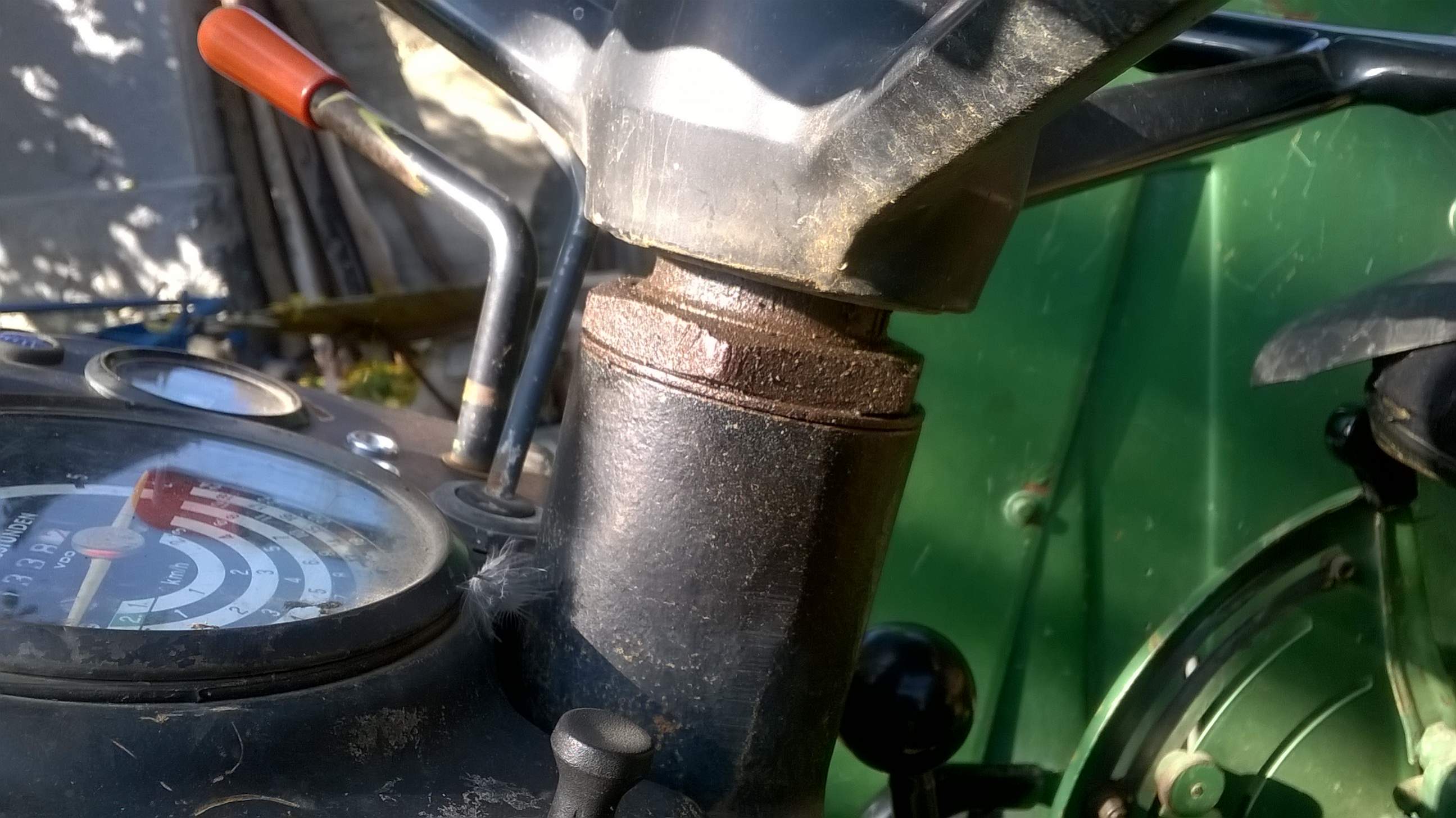

Hy, Jim.... Finally - today I removed my JD 1020 power steering column... And now its at repairing....if they succeed...
BUT - the hydraulic oil looked like very used - its like the coffee -so probably contains water.... and it has very bad smell... Its mainly an oil-condensed water emulsion...

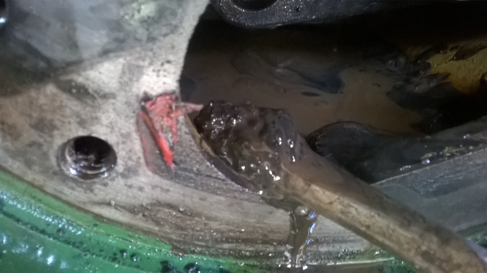

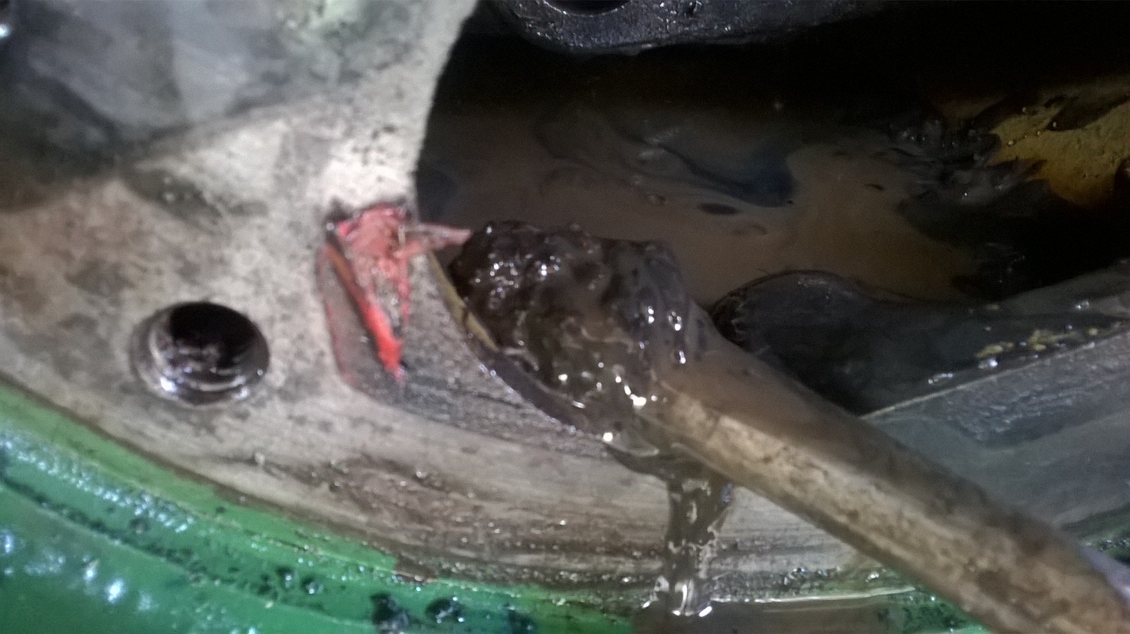

Hi....Thanks for answering...

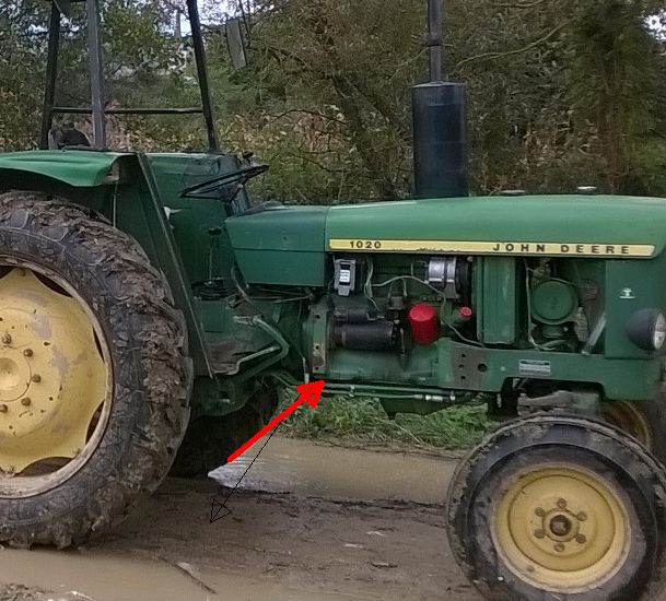

I attached some files... First two: oil and water under PS column....and oil-water mud... Do I have to clean it...? Do I have to do it again later , periodically?

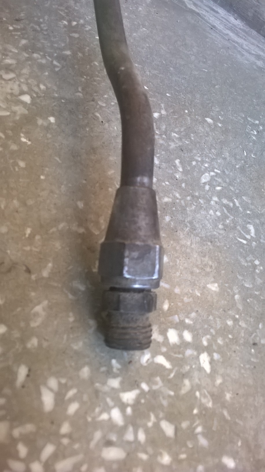

3 and 4 photo: the used oil from the PS...like a coffee... Photo 5 ....the breather, but its closed with a screw...is it a big problem, or it has to have an open hole? Photo 6-8: oil mud... The last photo: I suppose that the oil pressure from to PS unit comes out on that two holes? So maybe the oil mud and water mix could be only a subsidence, which is not a part of a high pressured hydraulics system?????
/ JD 1020 power steering #27
Looks like some serious oil mixture there, and not sure what I'd choose to do in your case. But a minimum would be to fill with a cheap oil (maybe even some filtered used oil) to circulate through the system, then replace with good oil. Hope for the best with new transmission oil filters each change.
I believe it is part of the hydraulics system, unless the German-made tractor is different. Hopefully you have a service tech manual for the 1020 and can find that out from the hydraulic charts.

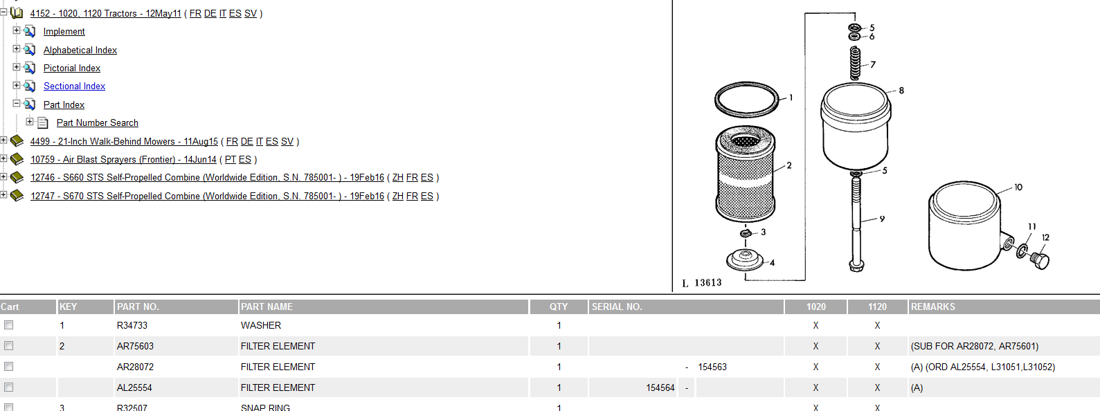

I going to change the transmission oil and the oil filter.... if I read corectly, the filter code is AL25554, or 60/240-1, or AR28072. I do not have a service manual for this JD type.

If I was getting a hyd filter I'd choose AR75603.
AL25554 Filter Element - Filter Element ADD 19.36 USD
AR75603 Filter Element - ELEMENT,OIL FILTER ADD 8.03 USD

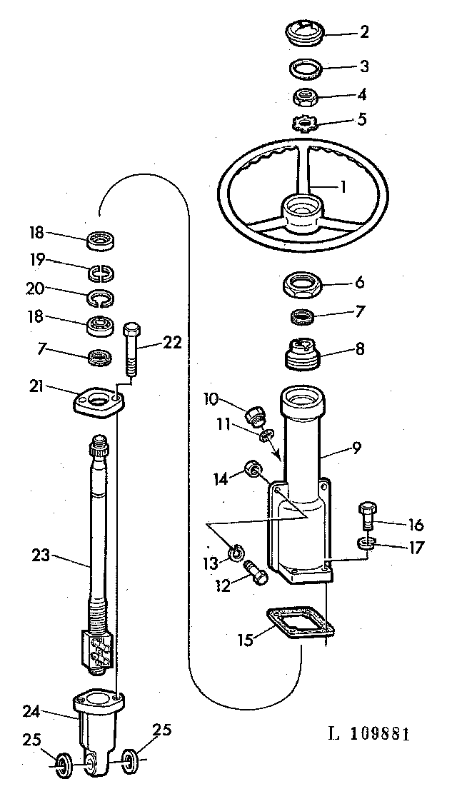

The most difficult thing to do is getting the 6 large o-rings in their appropriate lands in the housing. If valve bodies are removed from steering shaft one needs to keep track of shim locations.
#33
I understand what are you talking about.... At last - the mecanic was not able to disassemble the power unit.... only he took out the screw-cap and he could not do anything further.... So - the other pieces did not come out and he could not continue the disassemble....
As he says there was no retainer ring, no securing screew or other pieces like these.... He talked to another mecanic - and he said that he should not even tray to repair, because this piece his much difficult than Danfoss tractor hydraulic, which is used in other tractors type...
After you how can be disassembled the other pieces from the PS cylinder? By rotating or pressed...or with hammer?
You need to screw/out also the bottom part, too or it can be disassembled from the top? Sometime ago you mentioned that not every case need to be disassanbled completly, it is enough to remove only the top part.....
What is your opinion - should be tray to do anything with it or - should be better to fix it back as it is now.... We need the tractor as soon as possible because works on fields are starting.
/ JD 1020 power steering #34
After steering wheel is removed and adjusting nut(parts key 8) is loosened from housing then turn steering shaft to left then whole valve/shaft assembly on shaft will come out of steering valve housing so 6 big o-rings(parts key 18) can be inspected/replaced.

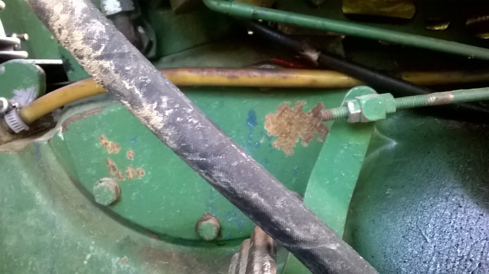

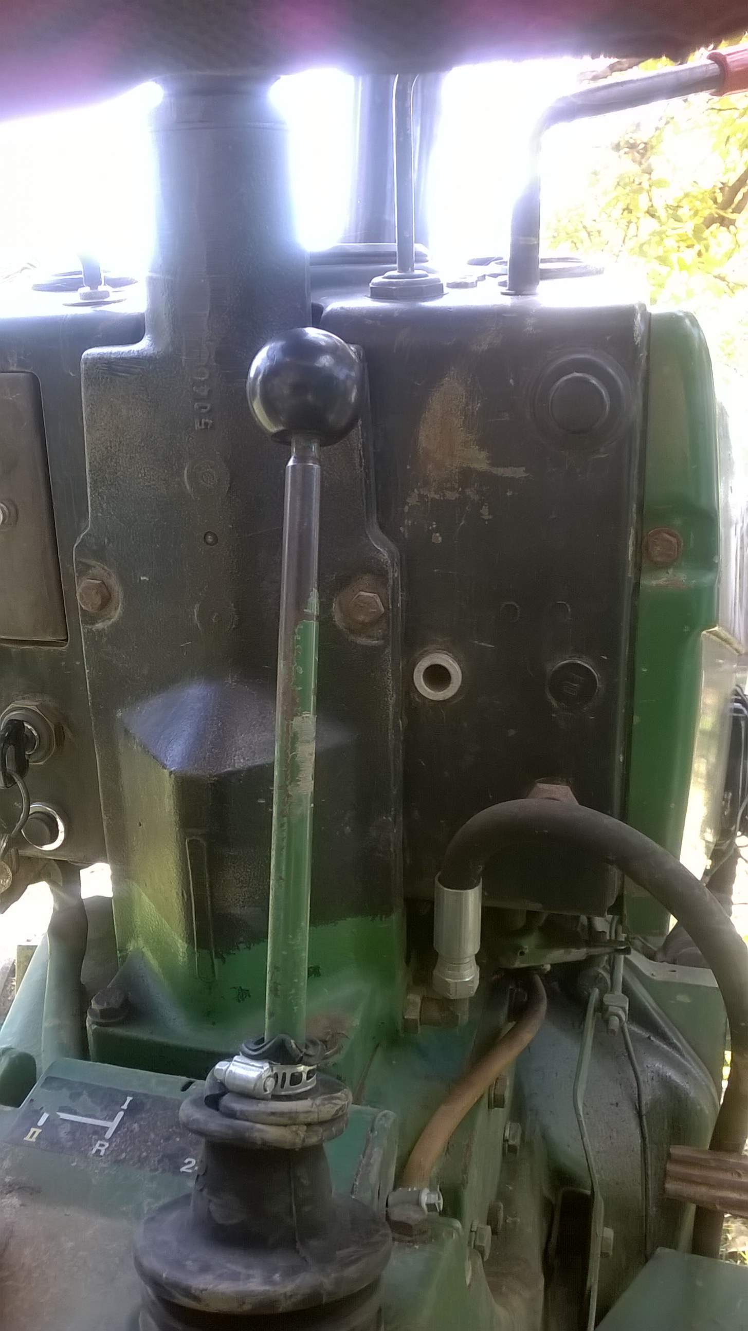

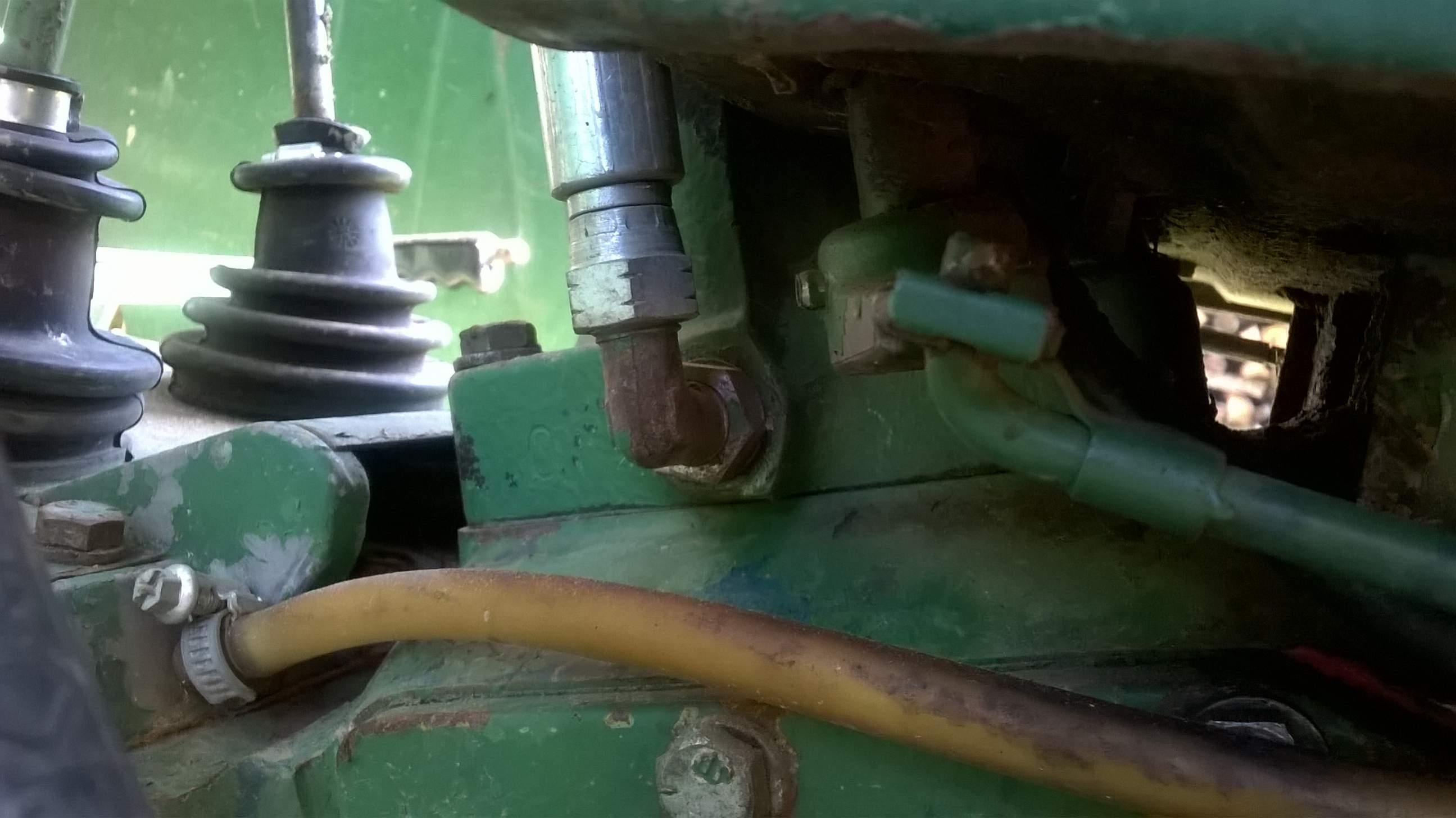

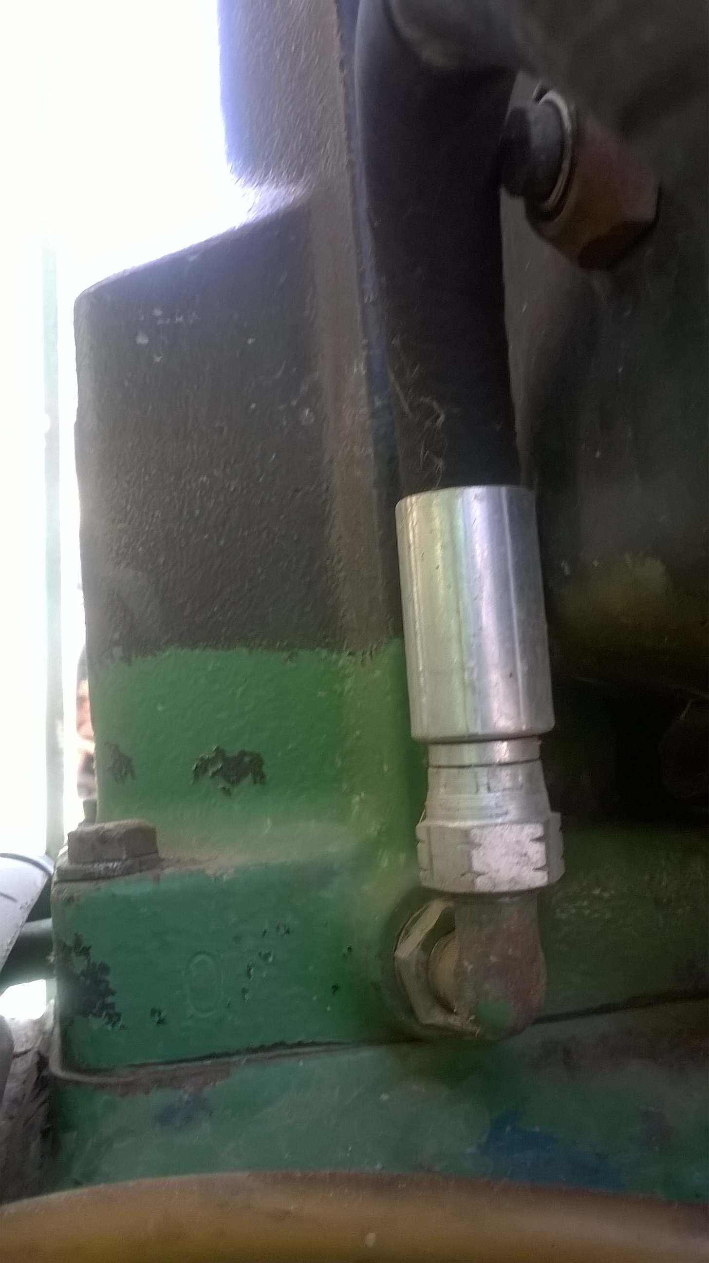

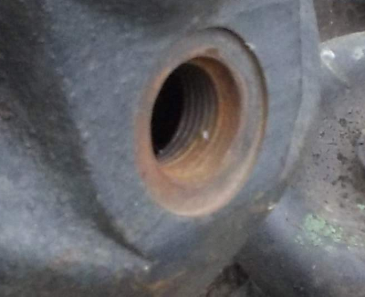

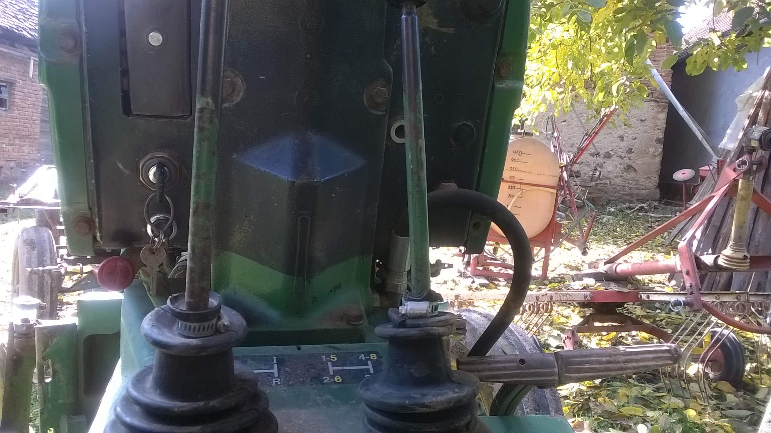

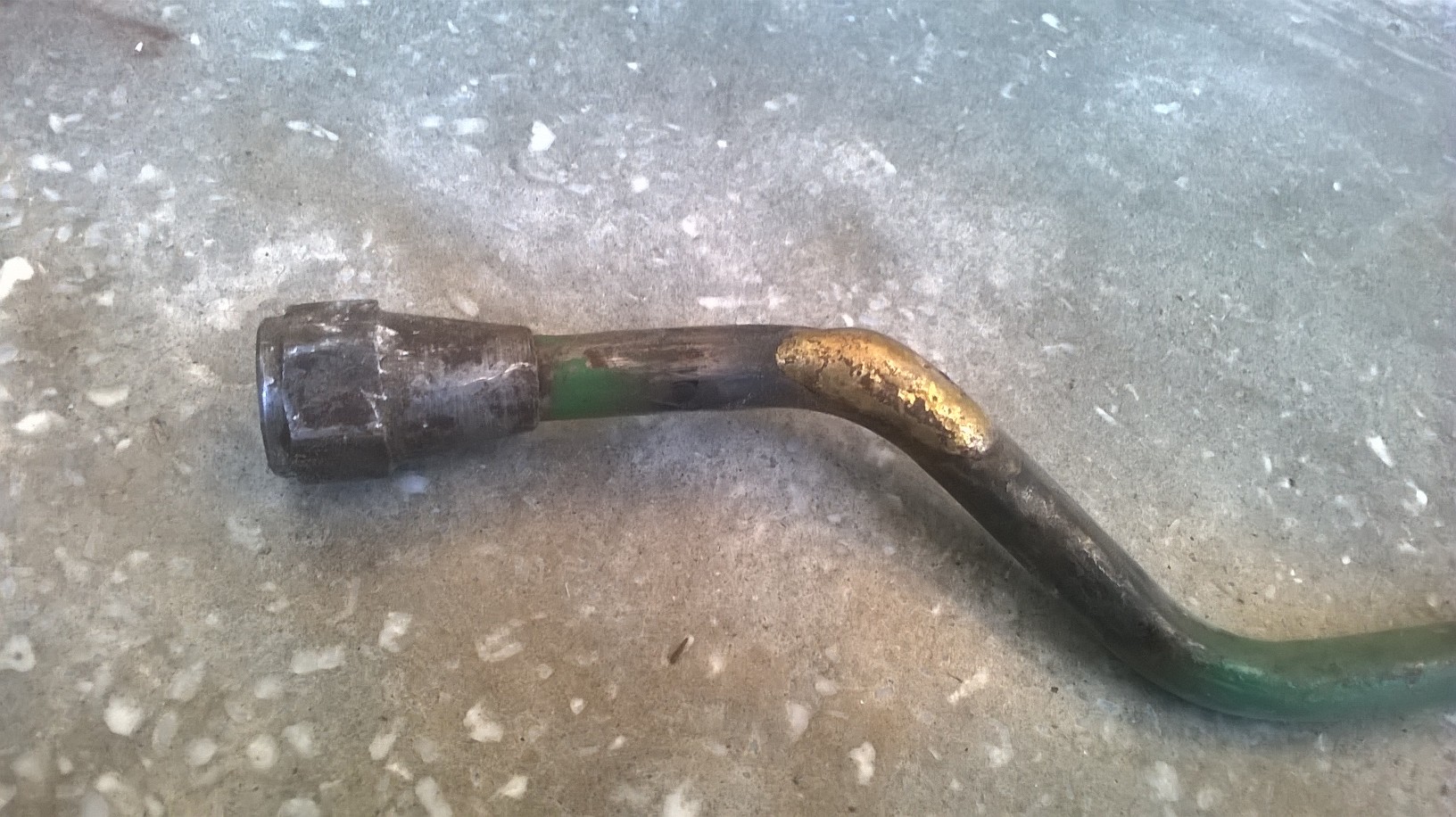

This morning I tried to lift with cool hyd oil - it was working a littke bit better than with warm or hot hyd oil, but it is not good at all.

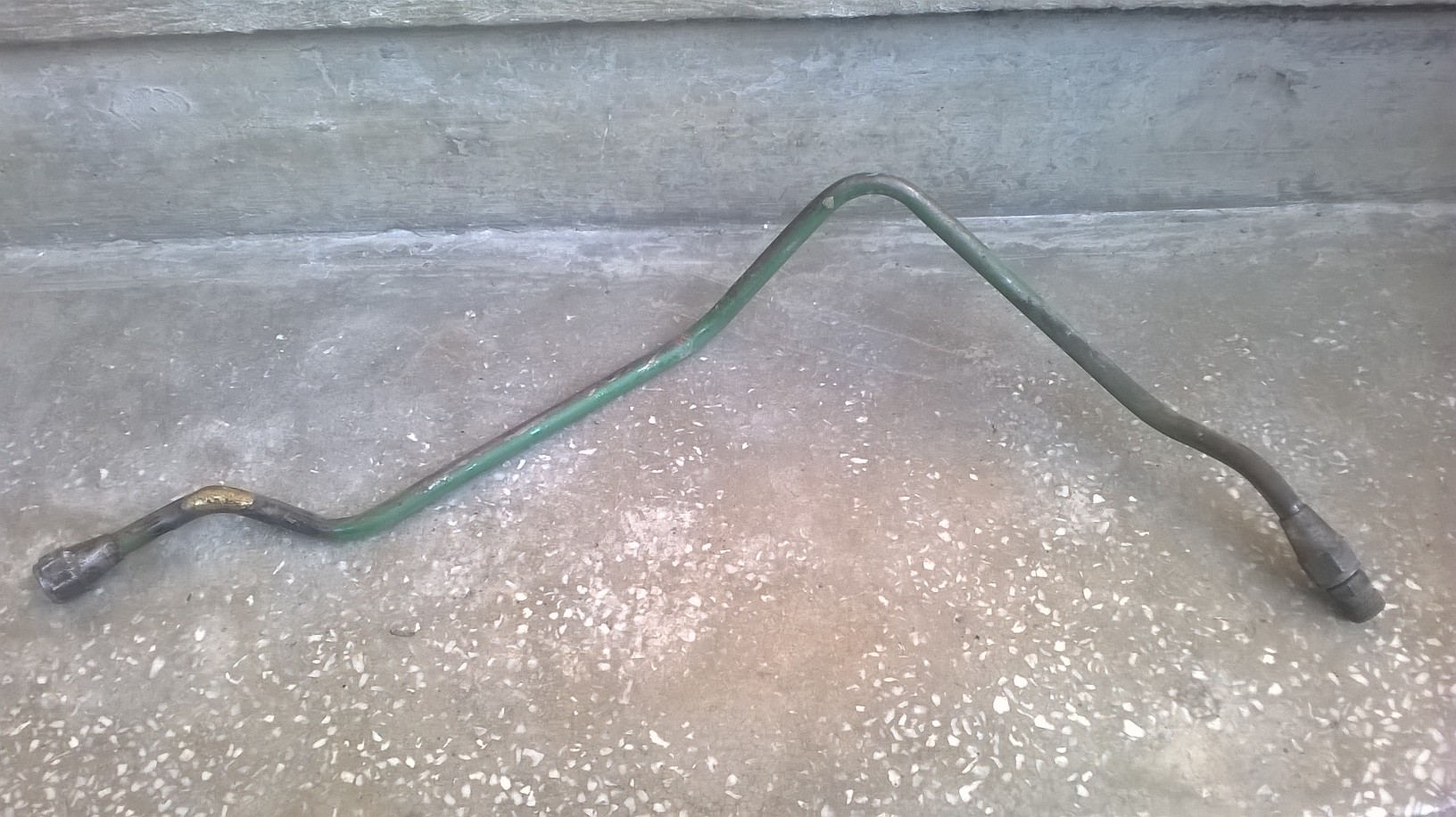

I already checked the oil level - its good. If the steering O-rings leaked, than if I close the pipe which goes to the PS (photo 2), than the 3 point needs to work in this case, no?!
WP_20160306_16_26_40_Pro.jpgWP_20160306_16_26_26_Pro.jpgWP_20160306_16_27_01_Pro.jpgWP_20160306_16_27_13_Pro.jpgWP_20160306_16_27_22_Pro.jpg
The parts key 15 from the scheme must be the rectangular screw behind the hyd oil filter. And the 7-9 parts key will be the a big hexagon screen, above the filter cover (photo 4). In the photos nr. 5,7 you can see a valve / this piece can provoke problems?
Others, the hyd oil system contains 35-38 litre oil - 8/9 gallons. After draining out - will remain a little oil in the system...5-10 litres? IN this case, I need max 30 litre new hyd oil to refill the system (7-8 gallons)... Do I have right?
I plan to change the old oil to new no name oil, put new filter, after that again drain the oil and refill with JD Hy-Gard 10W-30, and change again te filter.
And after this operation the 3 pt lift will not work, than it means other problems, like hyd oil pump problems?! Does exist an other pump on the oil system / you mentioned something like trans pump_?!
Yes to all 3 of your questions.

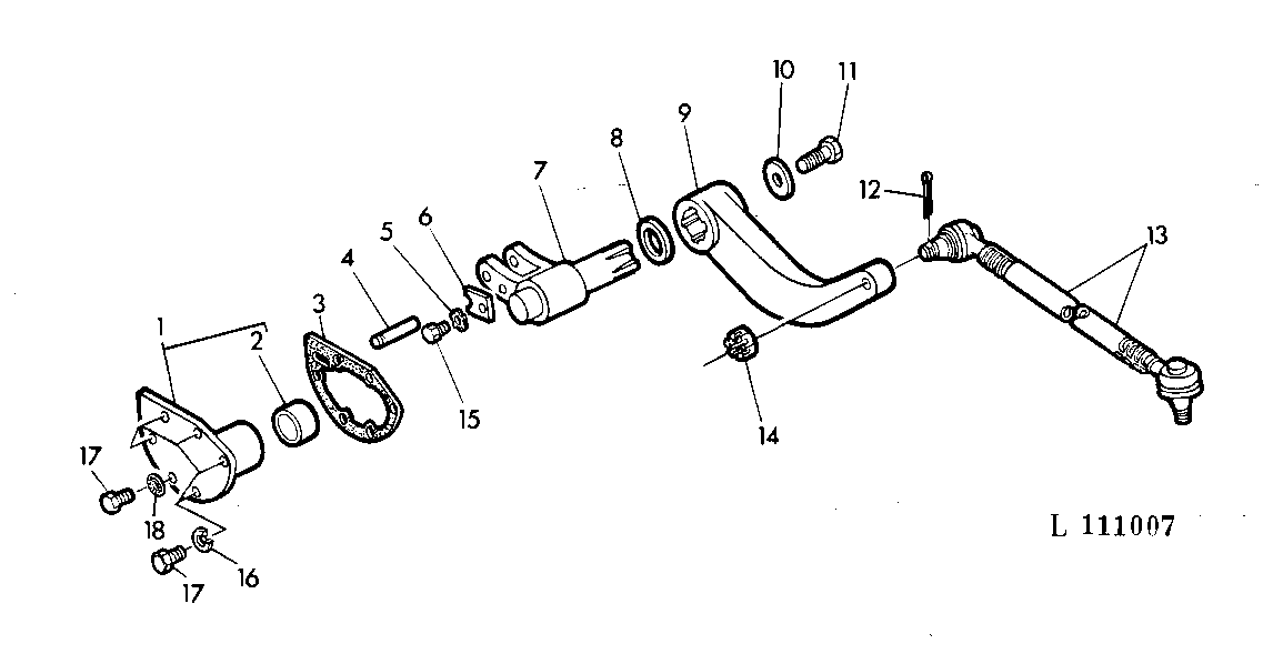

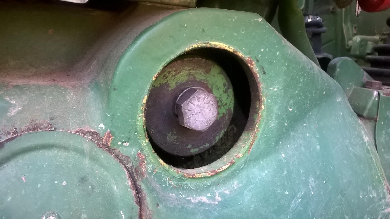

I dont understand something which may be important for the working of the hydraulicL111007________UN11SEP97.gifWP_20151025_14_58_00_Pro.jpg.
Its about the cover which can be seen on the picture. Piece nr. 3 from the scheme is gasket, on it there is a rectangular hole. When I removed, this hole and under the hole the calliber was also filled with red silicone paste.
When I fixed it back, I did not refill with silicone, I left it empty. The cover gasket now is leaking a little bit, but I will repair it again.
I dont understand the way of the high pressure hyd oil how it is flowing under the power steeling column boreholes.
1. The oil comes from the high pressure oil pump, enters in the PS cylinder, than the used oil flows out across a calliber from the cylinder....
2. Under the cilynder base there are two callibers in the alloy, one off the callibers flows down to the transfer case, the second calliber outlet flows into the cavity under the cylinder.
3. Has to come out but the cover gasket does not let it to flow out....the cover close it.
And than from where does collect the oil in the cavity. In the cavity there is no plug-hole than how does it work??? Beside of this the cavity was full of oil mud and water.
May in the gasket be high pressure? Or only low pressure oil flow. Can also this cause problems?
