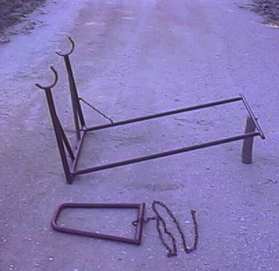

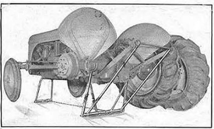

You can also build a simple 3pt tractor jack patterned from the old Ferguson 3pt jack... see the attached picture.
With it you can lift the back or back and front of a tractor using only the 3pt...KennyV
