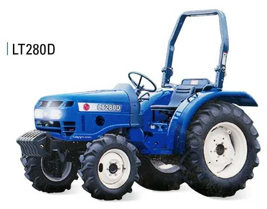

Brand and model would be most helpful. In your description I see Long, LG, LS, and Mitsubishi. A general idea of tractor age may be helpful, too.
Fairly easy to clarify.
He likely has an LG (name changed to LS later) with a Mitsubishi engine and some WR Long hydraulics. Since they only had one 28hp Mitsubishi-engined branded as LG, it is most likely an LG LT280D.
If, on the other hand it is an LS (previously LG), there are a few more possible models with a 28 HP Mitsubishi engine.
/ First tractor #24
Does it look like this one?
/ First tractor
#25
That looks to be the one. If I could only find an owner's manual, and a complete shop manual with electrical schematic, I would be very happy. But, it seems they don't exist, which is very strange. I found a Farmtrac 270DTC, which looks very similar, but it is just enough different to be pretty much worthless!
The company(companies that form the bloodline) are all defunct, and LS doesn't claim any knowledge of it's history equipment. As far as date of manufacture..............?????? Maybe someone here can give me a ballpark guess. I was told (Wink,Wink) that it was early 2000's.
