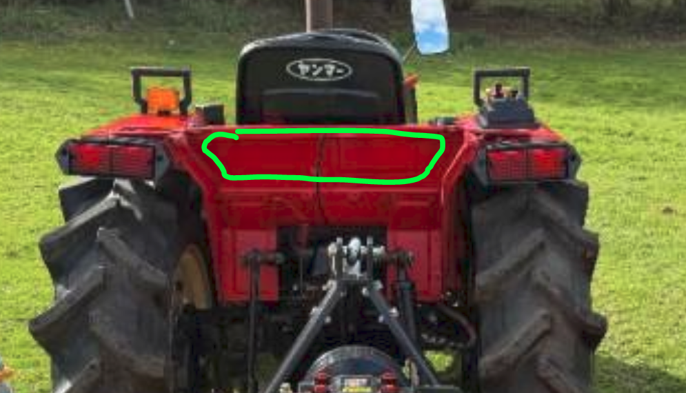

FX24D
This model did come with an optional mounted toolbox that sits here,
