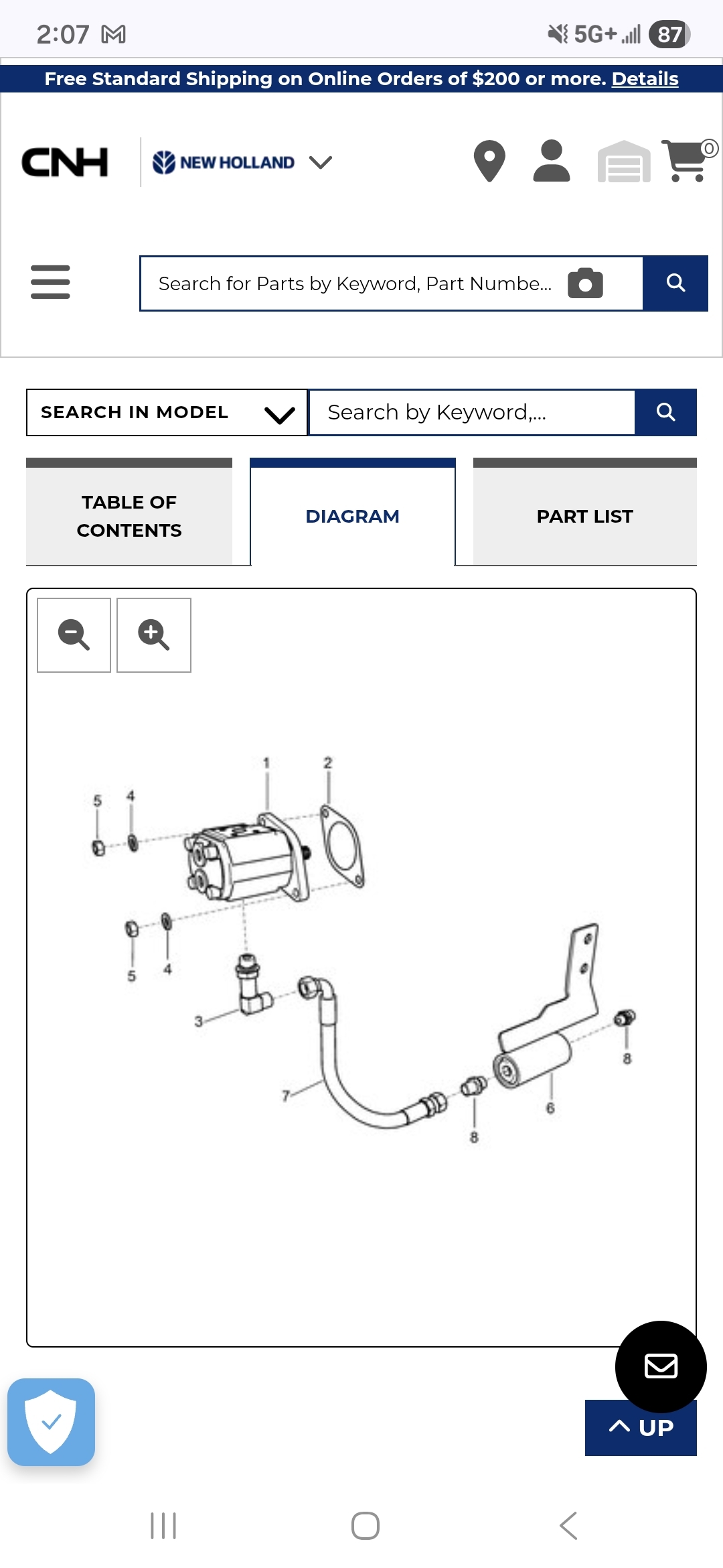

/ Steering Wheel Vibration #29
Hi guys, New Holland has a steering resonator on their boomer line of tractors to keep this manageable, maybe get one and plumb in after the pump? Here's the details MT40350687 at your NH dealer.
