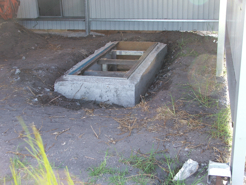

Thats exactly how I did mine except that I poured an entire concrete floor. On the inside of the shed the concrete is about 1 cm higher than the walls. Around the outside I screwed, staked, or used stone blocks to keep the thick plywood form boards tightly in position against the walls.
In the pic you can just see the plywood across the back wall stretching to within a couple of feet of the right hand corner. Eventually the plywood went across the back and both sides. I built form work for a small apron at the front. The concrete to the left was a rough retaining wall that was required so that I could bring in dirt and pack it down hard. (The shed was built on a slight slope so it was about about a foot off the ground at the left hand end.). Lots of levelling happened after this pic was taken and reinforcing mesh was laid. When the concrete floor was finally poured it covered all the rough concrete and was level with the form work on the inside of the shallow pit.
