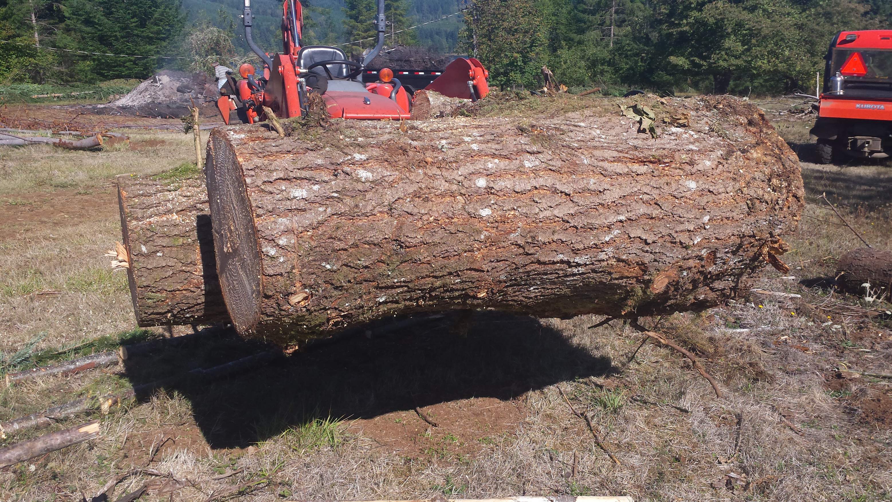

I had a big Cedar fall down across my driveway this weekend. Even with all the tire weight / ballast, the tractor still tried to pick up the rear tires. A 3pt hitch ballast box would certainly be more effective for dedicated heavy loader work. I still like having max ballast, on the tractor allowing me to keep my 3pt hitch available for other use.

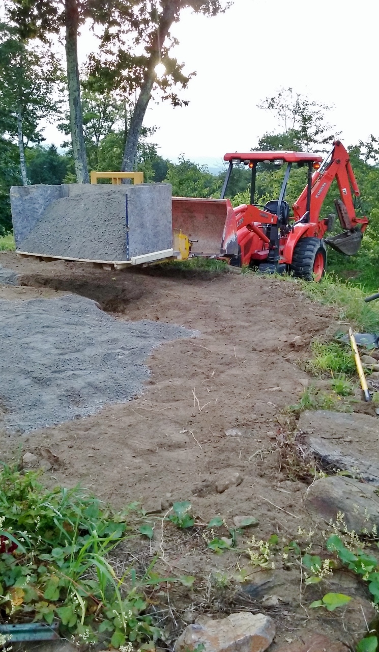

Running my L3130 with Rimguard and the backhoe mounted allow me to lift maximum weight with the LA723 loader without tipping. So adding wheel weights helps.

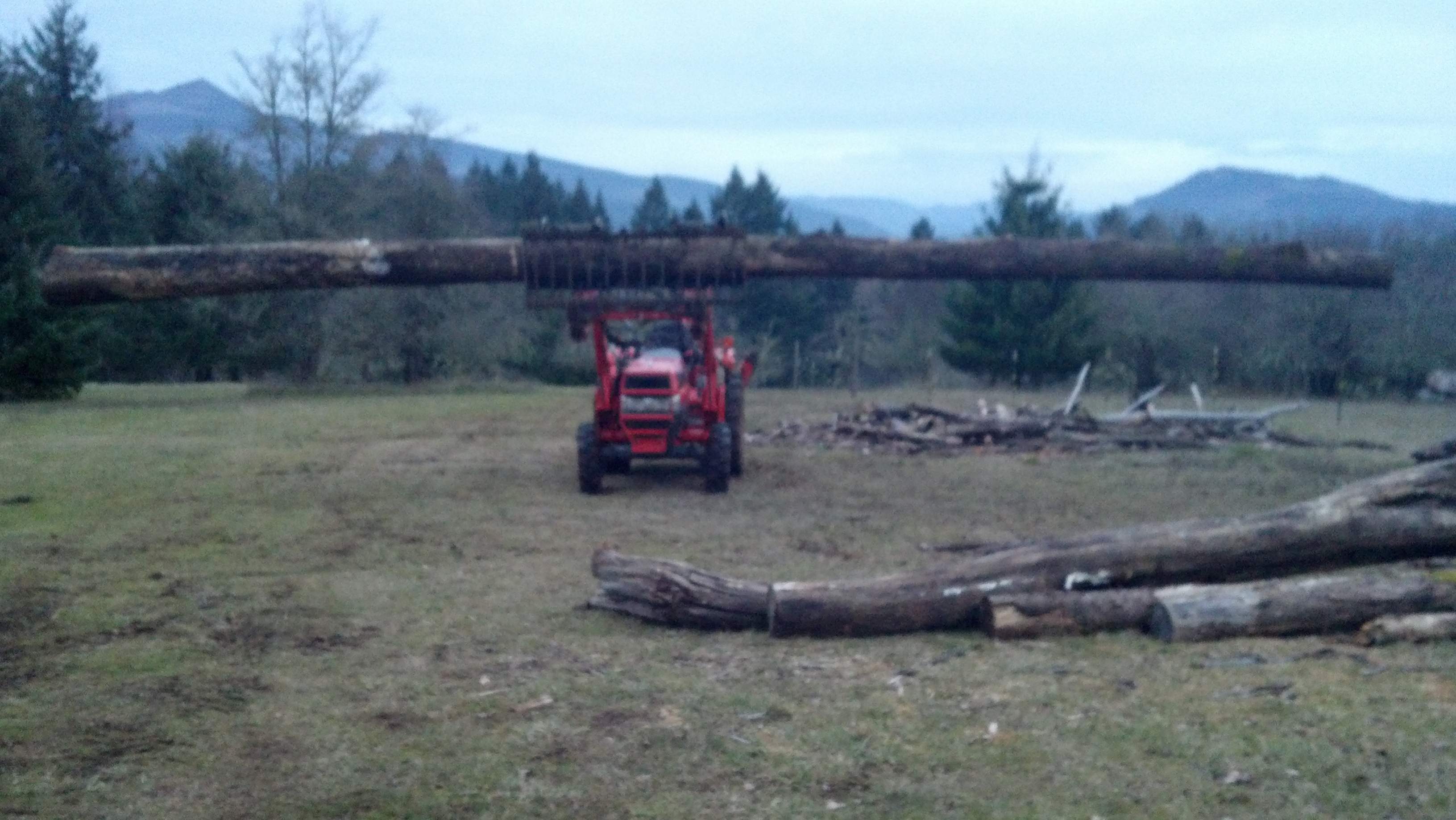

I have fluid in my tires as well as wheel weights, dealer installed my weights free and no problems so far. I usually have 1100 pounds on my 3PH, but have used it without.
X2 (very similar tractor). Do yourself a favor and make a QH compatible ballast box. :thumbsup:

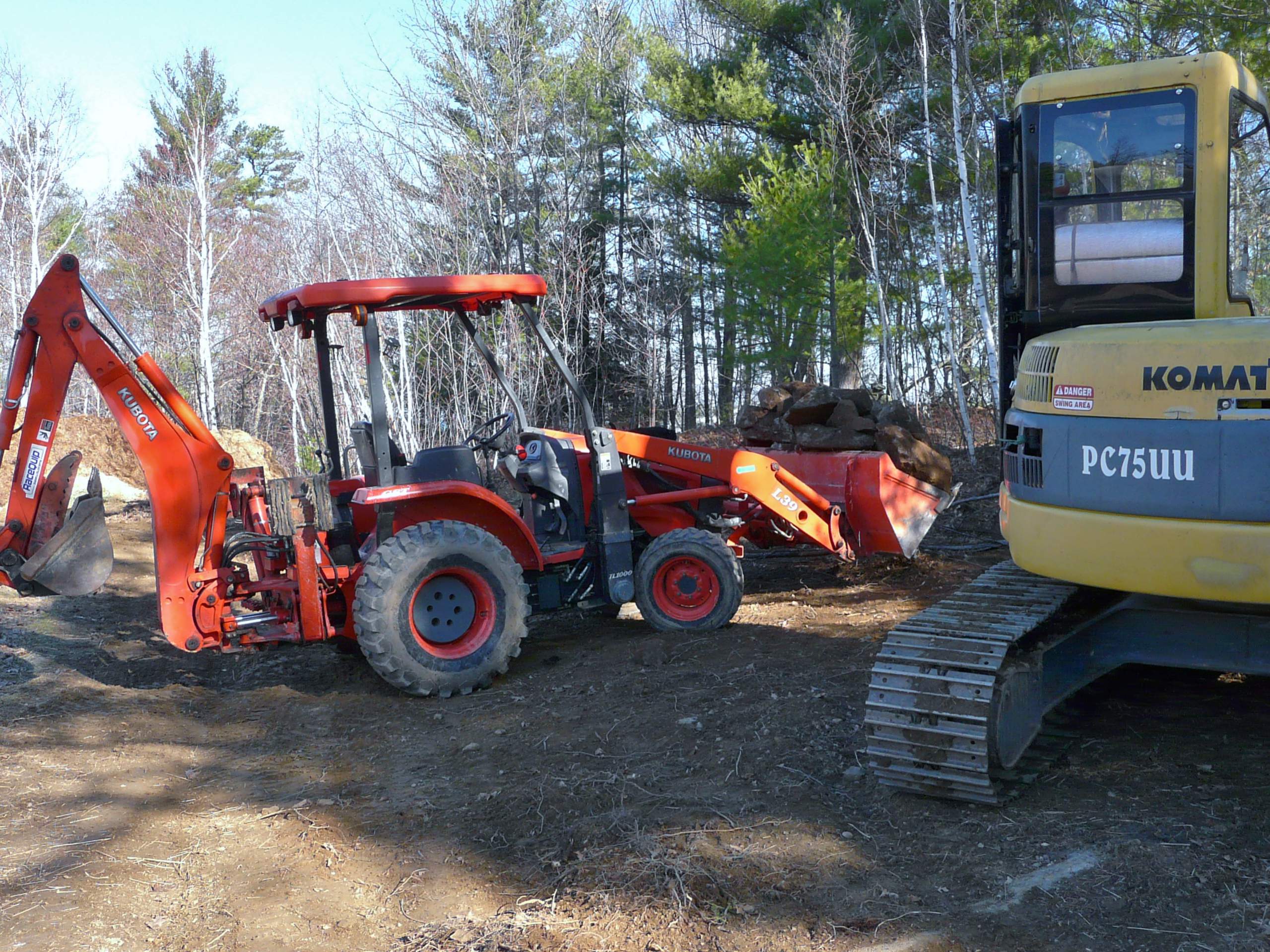

I only broke the front axle of my L39 twice in 2,200 hours of operation.
Fist time I hit it with my PC75 UU2 excavator.
2n'd time I dropped a big rock into the bucket with my excavator, and I did not have the L39's bucket firmly on the ground.
So neither of that stuff counts.
L39 is nothing more than a grand L with an integral frame, a bigger loader, and stronger hoe. L39 has same 'fragile' font axle.
Considering how hard I use my tractor, you would have to rather abusive to hurt the front end of a grand L.
