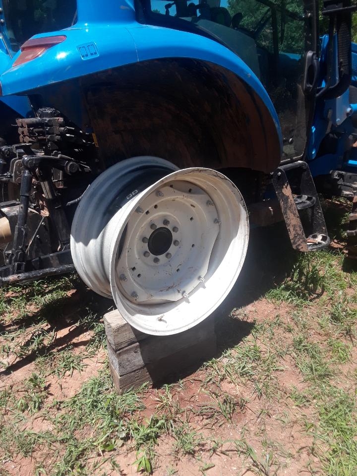

So beet juice can cause the tires and wheels to slip independently from one another?
Yes it can and does, usually on compact or smaller tractors with R4 tires as low air pressure may nit be obvious on those tractors. It also happens at times with R1's on large higher hp tractors in hard pulling work.

I have antifreeze in two of my tractors and no signs of corrosion on the one after two years. The other has had it in for about 15 years and nothing that I can tell.
