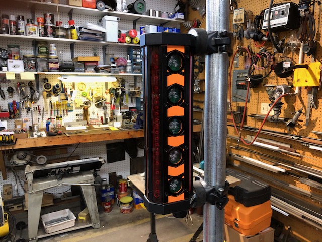

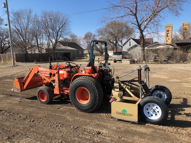

I've been playing around with the Johnson receiver on my box blade for a couple weeks now and I'm encouraged by the capability. The idea is to grade a pad for a building, for example, to a close tolerance without a very expensive automatic laser grading setup. Slopes are doable if the laser level has that capability. It certainly doesn't match the speed performance of the automatics, however.
It's a matter of watching the LED arrow and making adjustments to the box blade on the go with the rear remote. I find that controlling the blade level with the rear mounted rockshaft wheels to work best. Can also do it with the toplink cylinder.
I have not tried using the tractor's rear view mirror to watch the lights but that is a possibility. I'm used to watching the box blade work anyway so it "works" for me.

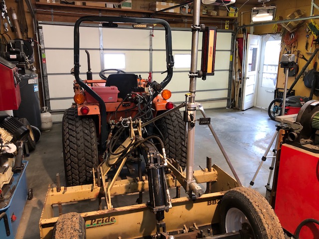

The mast holding the receiver is 1 1/2" EMT conduit (1 3/4" OD) mounted to the box blade. I also mounted a linear actuator to which the conduit can be attached for elevating the receiver above the tractor roll bar for full visibility 360 degrees.
There is a digital readout also mounted to the linear actuator for taking elevation readings on a field grid, for example.
The receiver will pick up any red laser from a rotating laser level.
https://www.amazon.com/Johnson-Level-Tool-40-6792-Display/dp/B003AM5DWA
Edit: Forgot to mention that this remote is available which plugs into the machine receiver and can be mounted next to the operator. Might be more cost effective, however, to just use the rear view mirror or a camera and monitor if one gets tired of looking back all the time. I've found, and others have told me, that its obvious when rough leveling an area where the high and low spots are and the laser becomes unnecessary until the final grading.

The machine receiver is about $650 (see above) and a stick of 1 1/2" EMT runs about $20 at Home Depot. The linear actuator and digital readout are items I had left over from other projects and could probably find a used actuator on Ebay for maybe $100 to $200. The digital readouts are fairly reasonable at maybe $50. A reversing toggle switch for the actuator goes for about $15. The mounts for the masts are from scrap metal pieces.
I do my own machine work as a retirement hobby so don't consider that as cost. :)

Ok, I’m intrigued. The linear actuator is just for the digital display? No way to tie it into the gauge wheels or toplink?
/ Inexpensive Laser Grading
Good question! See this thread from 2015:
https://www.tractorbynet.com/forums...ital-readout-3ph-top-cylinder.html?highlight=
Particularly on a box blade its handy to dump a "load" and then return to the same exact blade depth. The remote display can be mounted on the tractor dash or fender and the scale could certainly be mounted on the gauge wheels cylinder.
The idea of the linear actuator with the attached position readout: Take a reading where you want to establish a benchmark with the blade just touching the ground and the laser receiver indicating "on grade". Then drive to the first point where you want to see the elevation relative to the benchmark. Zero the digital position readout and then extend or retract the linear actuator until the receiver indicates "on grade" again and note the new position readout. This is basically the same procedure as walking around the area with a grade stick and laser receiver to take readings but a lazy way of doing it.
My understanding of the process would be to mark out a grid of an entire area to be leveled and take elevation readings at each grid point. Then the amount of soil to be moved can be calculated by taking an average. Other TBN members with experience in this area please feel free to chime in.
Note that the actuator and readout are certainly not required for laser grading, they're just "frills" from a guy who likes to play. :)

I'm a construction surveyor and I'm working everyday with machine control equipment. From excavators to graders and skid steers, some are equipped with high precision GPS Receiver and other are real time tracked by robot. These systems cost big dollars for big dollar companies. I got to say that your setup looks pretty neat and perfect for your application. One thing you can add is graduations on your receiver's post for quick adjustments with your actuator.
You are on the right track with grid volume calculation method. With a grid you can obtain a pretty precise results with cross sections area or cells averaging. Do a tight grid on really steep terrains and a loose one flat area.
