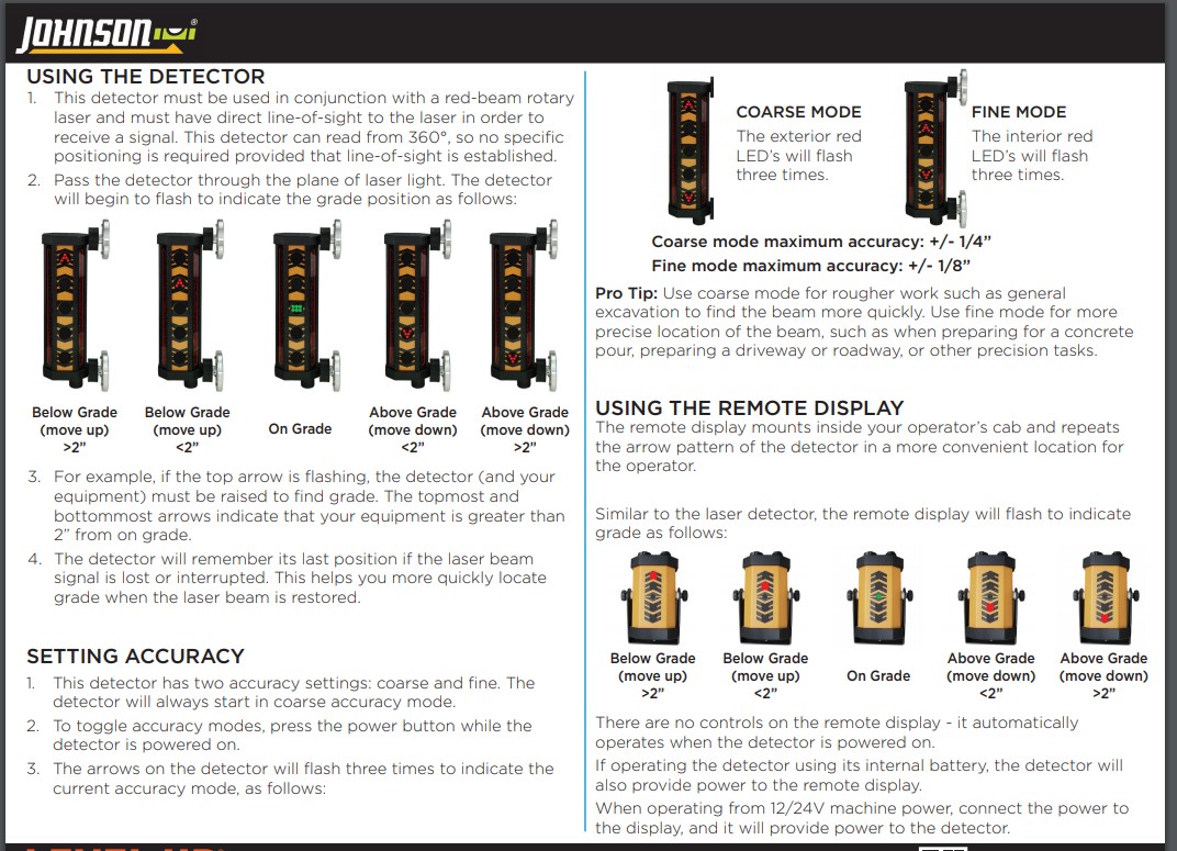

I noticed that the C94-M8P packaged unit has onboard radio receiver. What other electronic components would be needed to come up with an auto steering unit for a tractor, for example? I also noticed that the board will interface with Arduino.
It seems that there would be market for low end consumer grade auto steer using components such as this.

CAN Bus Explained - A Simple Intro (22)
I have to wonder if CAN bus is the output to the four wires going to remote light indicator.
It could be. The only thing that makes me wonder is that the CAN bus seems to run on 3.3 or 5 volts and you were measuring quite a bit higher than that.
The best way to know for sure would be to find out from the manufacturer.
