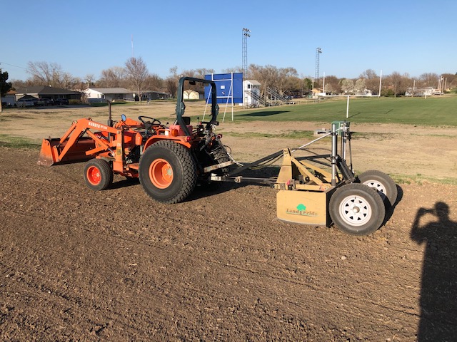

Another approach to the means of actuating the cylinder is a power steering valve as shown in the attached. It is a basic Char Lynn four ports; pressure and return and A and B ports to the cylinder.
This type of valve is used on a large percentage of compact tractors and is connected directly to the steering wheel as I'm sure most of you are aware.
I had purchased and mounted this valve just to the right of the other remote valve bank as seen in the pic and done early testing with it to follow the laser receiver. My reasoning is that the rotary motion of the crank input would have the same feel as a steering wheel and the speed of the cylinder can be controlled by speed of the rotation. (The crank next to the seat works favorably from an ergonomic standpoint.)
I've been using one of the remote valves lately while waiting on a detent kit to make it easier to switch back and forth between the Char Lynn and any of the remotes or 3PH. (No power beyond on the Char Lynn)
So what I'm wondering is if it would make more sense to drive the Char Lynn with a variable speed 12VDC motor and worm drive gear reducer. That is how many of the ag tractors have been set up for GPS auto steer retrofits. The DC motor/gearbox output drives the steering wheel by friction around the circumference. Interestingly enough, the manual method of doing this is a GPS light bar mounted on the tractor hood and the operator watches the light bar and steers manually.
The power steering valve has the advantage of being proportional in that the faster you turn it the faster it "steers". So by varying the output voltage and polarity to the DC drive motor we could modulate the response to the laser receiver output.
The steering motors can be bought new in the $400 price range which isn't bad considering they have a built in subplate for the ports. A solenoid directional valve normally requires a subplate for mounting and plumbing.
So what do you guys think? I had kind of forgotten about using the Char Lynn so sorry about not mentioning it sooner.

How big of a job would it be for an electronics guru to design and spec all the components required for this system?
/ Any Electronics Gurus Out There? #93
Here's how I would approach it. There's basically three parts: reading in the setting, controlling the blade movement, and the logic to connect the reading to the controlling. I would use a small microprocessor like an Arduino or a Raspberry Pi.
Reading: if the signal between the receiver and the remote is a standard protocol, both Arduino and Raspberry Pi have built-in processors for USB, RS232, I2C and other protocols. Reading the data is just a matter of connecting the right pins on the receiver plug to the right pins on the microprocessor board.
Controlling: Two ways of controlling the blade have been proposed, either using an electric hydraulic valve or using a power-steering type valve with a DC motor. The electric valve is not difficult, it just needs to be attached to one output pin of the microprocessor for up and another output for down. If the current or voltage requirements of the valve are different from what the pins can provide there needs to be an appropriate relay. Controlling the power-steering type valve is done by controlling the speed of a DC motor. This is commonly done by a technique called pulse width modulation, where pulses of electricity are sent to the motor, the longer the pulse the higher the speed. This requires attaching a single output pin of the microprocessor to the motor. Again, if the voltage or current requirement of the motor can't be met by the microprocessor pin a relay is necessary. If you were to take a course in using Arduinos or Raspberry Pi this is all stuff you would learn in the first month.
The third part is the control logic, this is a program that runs on the microprocessor. This is the big wildcard. It could be as simple as "once a second, read the blade height. If it's too low raise it, if it's too high lower it. Repeat." Or it could be that you need to keep track of the history of the blade height and the history of commands you've given and adjust your response based on what's working. Or maybe you need the user to input some information about the hardness of the soil. Or maybe you need another sensor to tell you the speed of the tractor.
The control logic will take some trial and error, a lot of time just driving across fields and watching what happens. The reason I'd prefer Raspberry Pi for this, even though I have more experience with Arduino, is the RP has more capability for things like logging data and giving a display while it's working. If you were to do this with Arduino you'd probably have to have a laptop on the tractor with you while debugging log what's happening. I've also done projects like this where I had an Arduino-like device attached to the USB port of a smartphone and the phone provided the display and logging.

Thinking about the linear actuator got me going again. :) I have a linear actuator mounted on the box blade as shown in the pics with up, down, speed control and remote readout on the tractor. The idea is to take grid readings of the elevation of a work site prior to grading. This is to calculate cut and fill and finished grade elevation and it would be a manual process by moving the rig to the next location on the grid, raising or lowering the receiver to take a laser "hit" and then recording the reading on the remote readout at that location. Then rinse and repeat.
With an automated setup for grading the same electronics that control the blade height could be switched to and used to automate the surveying process mentioned above. The process would be driving to each grid location with the linear actuator energized by the auto control so it would elevate to follow the laser beam. The blade height would be clearing the ground by several inches and the cylinder wouldn't move during this process, only the actuator which is DC motor driven.
The digital readout I have mounted on the linear actuator would give the continually changing elevations to the operator's remote while driving and could be recorded statically at each grid point. The GPS coordinates could also be recorded at that point but that's another story.
