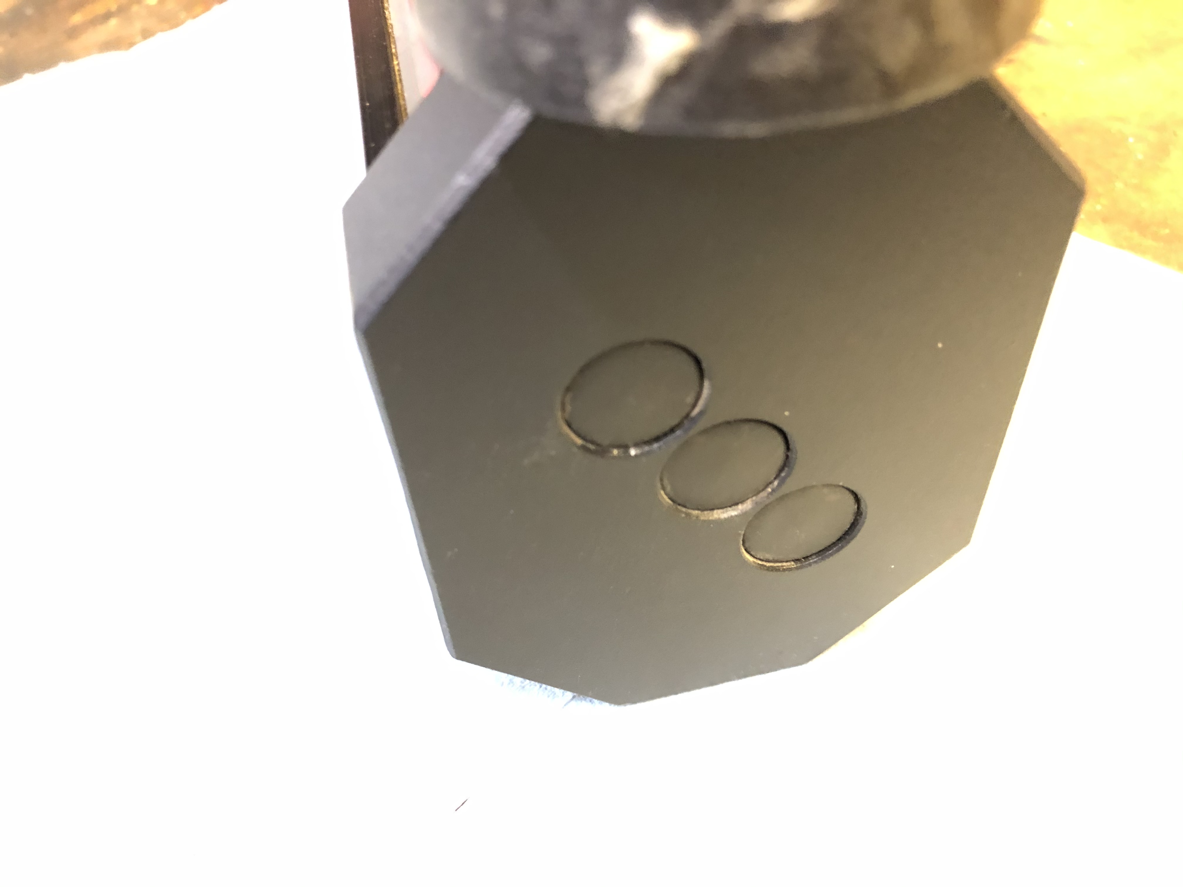

A couple new developments just to make things more complicated and less complicated all at the same time:
I don't believe that I've mentioned that the LEDS flash and they also flash at different speeds depending on the distance from grade. They also change speeds when going thru a couple of zones and I think one of them is when going past the 2" departure from grade. I need to do some testing to see exactly where the speed changes occur. The owner's manual says nothing about all this.
Something that just occurred to me this evening is that we have pinouts on the receiver that go to the remote when attached via the cable. There are seven of them and one appears to be ground and one for the 12 volt charger and/or the 12 volt battery input. (The receiver has an onboard rechargeable battery or can also be powered by the tractor battery.) That leaves five pins for the five sets of LED's. Yes I feel very stupid for not realizing the connections for automation are right there in plain sight.
It gets interesting when one thinks about utilizing the different flashing speeds to change on/off times for the solenoid valve.
Edit: Added pic.
Well, that either adds simplicity or really complicates the situation. :laughing:
Flashing LEDs would be harder to key off of. Take a look at the signal on the connectors to the remote and see if it is solid or flashing would be the thing to look for, I guess.

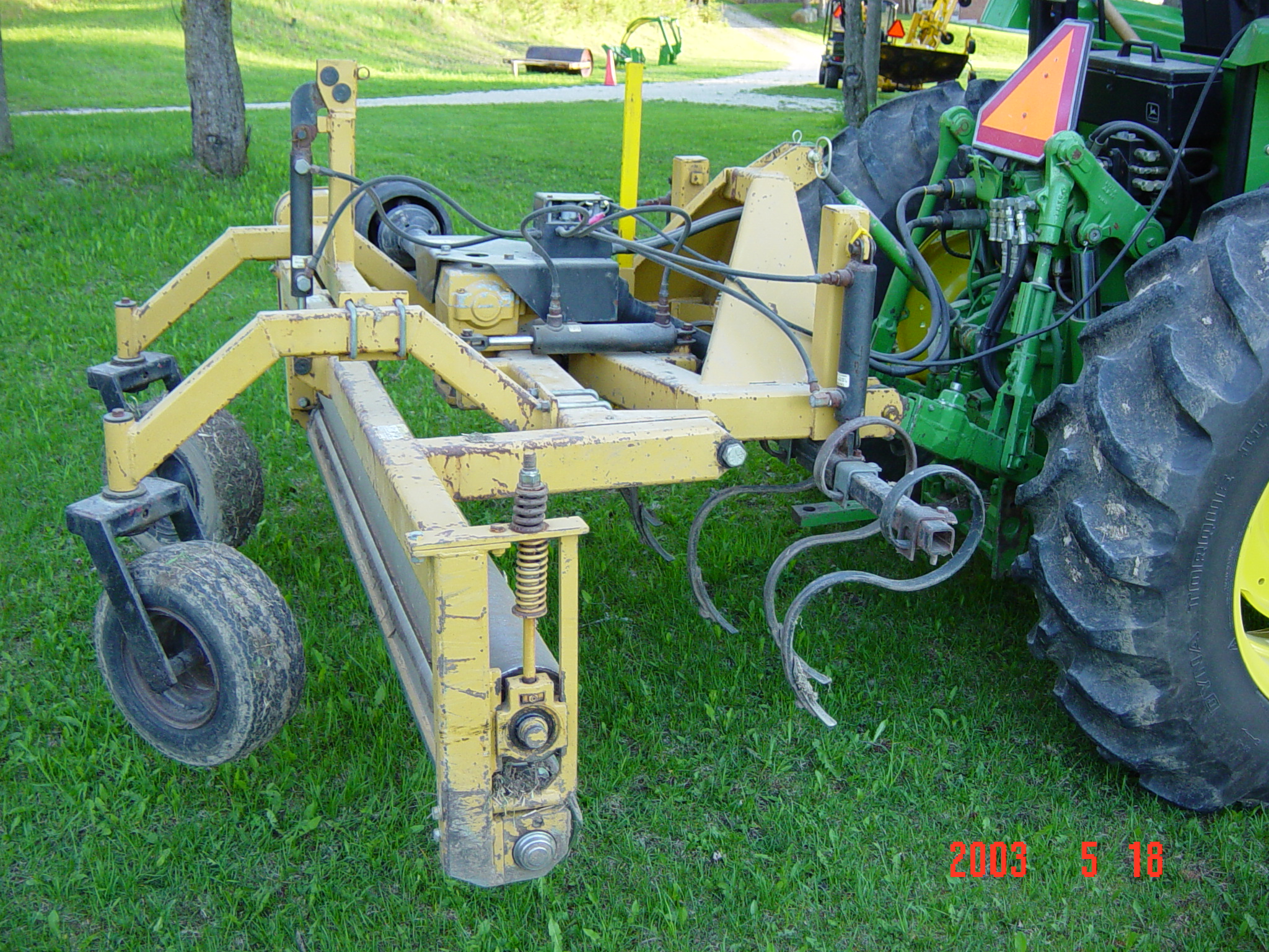

I don't understand. One relay controls upward motion of the harley edge, the other down. Laser receiver is mounted on edge. Grade is too high, harley lowers until grade is ok or until limit is engaged, grade too low, harley raises until grade is ok or limit is engaged. What logic? Am I missing something? No laser on receiver and harley makes no change. Slight timing damping but not too much to make system slow to respond.
I MAY be missing the obvious. But in my thinking this will keep the harley cutting depth at grade provided the laser signal is not lost and then the harley would just stay at the last position until recapturing the laser.
It wouldn't even be hard to mount a receiver on the harley near the operating cylinder. Of course on a high stick to clear the tractor.

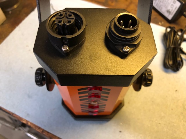

I found, after receiving the remote and testing it this morning, that the audible feature is not working. I got a "used" price on it from Amazon and that may be why as it is probably a returned item. I will attach a pic of it as well as the receiver showing the end ports.
It seems odd that the receiver has a seven pin port and the remote has two four pin ports. One of the four pin ports attaches to the cable whose other end has seven pins to match the receiver's seven port. (The remote has five sets of LED's so not sure how they're getting that out of four pins--must be some logic involving pin combinations?)
I am curious what type of connectors these are if anyone knows. The second four pin port on the remote is for a cable from the 12 volt tractor battery which can be used to power both the receiver and remote or the rechargeable battery on the receiver can power both.
I will do some testing on the receiver to see if I can pick up an output signal(s) but all I have is a digital VOM.

I think they are a canon connector. Bought them from the most wonderful company Digikey.

The problem is the timing. The blade doesn't move instantly. If you activate the down relay for as long as the high light is on, the blade will continue to move down after the light comes off. In the worst case it will overshoot and now the low light is on, so the up relay activates. You get the blade wagging up and down and instead of a smoothing you create a washboard. So maybe you want to work in a delay where when the high light comes on you activate the down relay for a set time, then wait a set time, then check the light again. But how much time? That depends upon the responsiveness of the blade, which varies depending on your speed and the type of soil.
It may or may not be possible to control the blade based only on the lights. The only way -- or the only practical way -- is to experiment. My point is that you don't need a computer interface to experiment. In fact, it actually makes experimentation more difficult because you have a lot more parts to worry about. I'm going to repeat my recommendation from post #39 on page 4, which is to hook up a simple electrical interface to the blade and then go out and do some grading, and see if you can get satisfactory results using simple rules that use only the input from the lights.
You could even start out skipping the electrical interface to the height control and keep it real simple but my hunch is that the manual and electric differ significantly in their performance so lessons learned on one are not transferable to the other.
/ Any Electronics Gurus Out There? #71
If timing is the issue, it must be an issue on many hydraulic machines. No way to predict what the terrain is going to do and have your cutting edge at the right height ahead of time. I mean, the electronics is instantaneous. It's the hydraulics that have to catch up.
