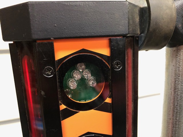

The picture is a closeup of one of the output LED clusters on the laser receiver shown in the thread below.
It would be interesting to automate the manual system by picking up the signals from the receiver output LED's to control a solenoid valve. The solenoid valve would basically duplicate what the operator does in operating the remote valve on the tractor while watching the receiver lights. The lights form arrows indicating whether the box blade needs to raise or lower to stay on grade.
Someone in another thread suggested using an opto-coupler to "pick up" the LED's and then amplifying to a level that would operate the coils on a solenoid valve. This would probably be less than five amps on the 12 volts.
In doing a little online reading, it also sounds like four or five photo darlington transistors strategically mounted on the receiver to sense the LED outputs might also work.
I'm wondering if a PLC (Programmable Logic Controller) might also be part of the mix in that it would facilitate experimentation to fine tune the response. Variables such as the amount of on time and delay between pulses for the
solenoids would be examples of fine tuning the system.
I realize that this system would not be as good as the automatic systems employing proportional hydraulic valves but the cost would be much lower.
Would be fun to hear thoughts from you guys and gals.

I work on automation for a living. Reading the LEDs would be possible but would be finicky at best for the home brew. Best bet is to find a way to wire the led outputs to digital inputs on a controller. The easiest way to use the tractor hydraulics is to find an actuator to move the control level on the tractor.
You may be able to run it off an arduino which is a $20 microcontroller.

Personally, I would open the case and find a way to wire a pair of leads to each of the sets of LEDs.
I would find what voltage the LEDs run at, then use that to run a pair of small relays (both single pole, normally open, capable of handling 12 volts on the switch side and with the coil voltage at whatever voltage the LEDs run at), then feed a common and the up and down output from those relays to an external connector (such as a headphone jack).
Then go from the headphone jack to a heavier pair of relays that have a 12 volt coil and are heavy enough to handle whatever solenoid you are using to control the hydraulic valve.
That way, all you have to do is disconnect the headphone cable and you can use the receiver in standalone mode.
