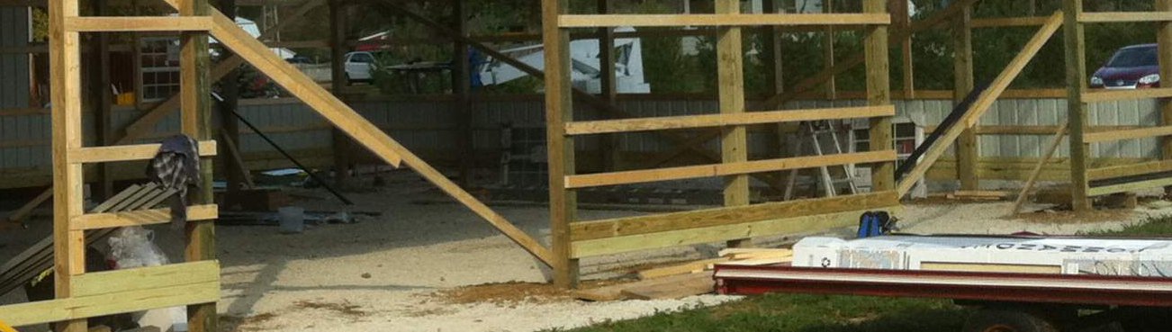

/ Indiana pole barn project
#11
Well my barn project is underway! This is a pic after day one! 3 of us and and good hard 8 hours later we have something to show for it. More pics to come.
/ Indiana pole barn project #12
That was a great day 24 posts done! If you keep that pace up you will be done in a few days.Looks good.

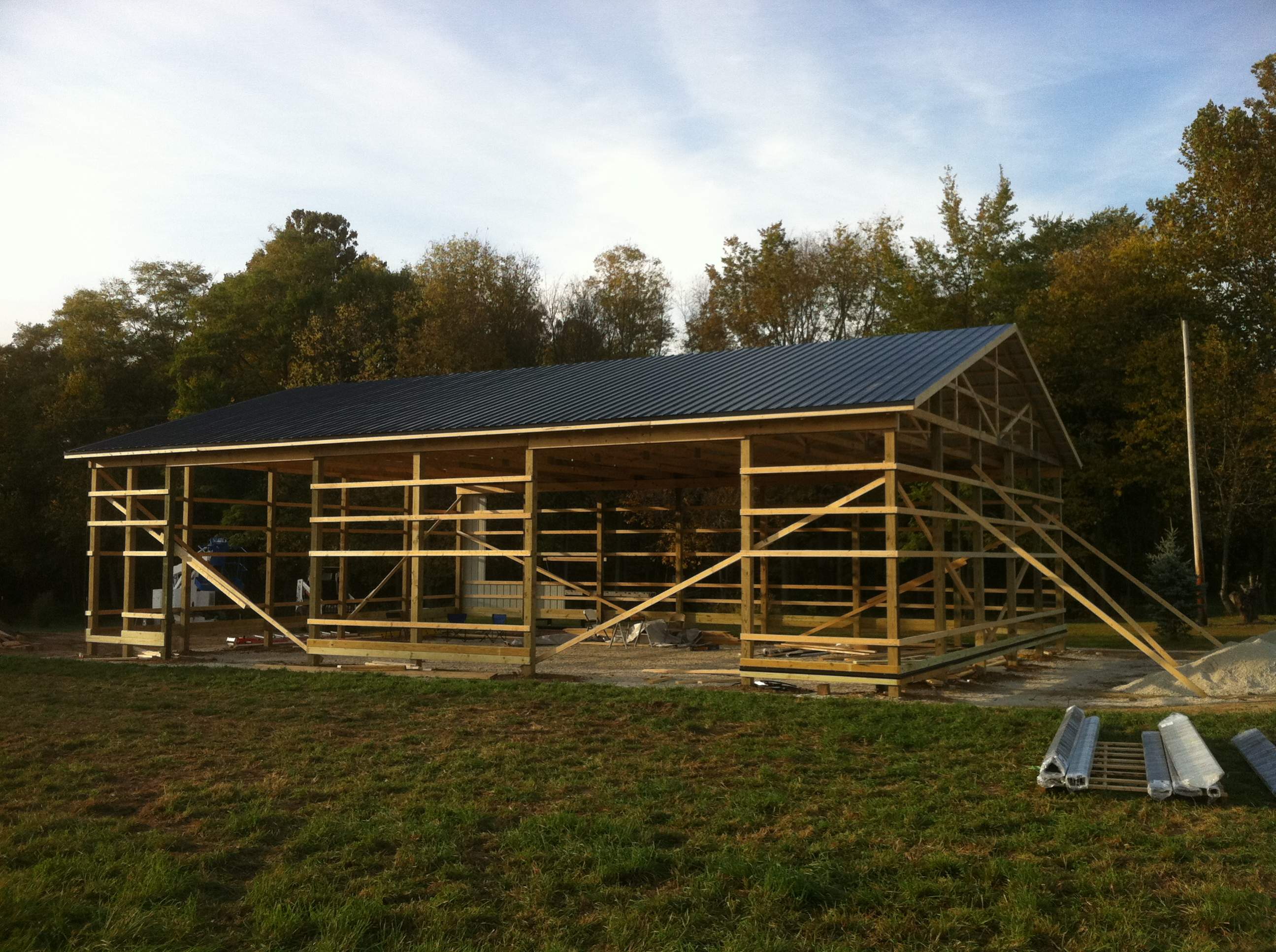

#14
Barn build updates
#15
End of day pics for build day 4.
