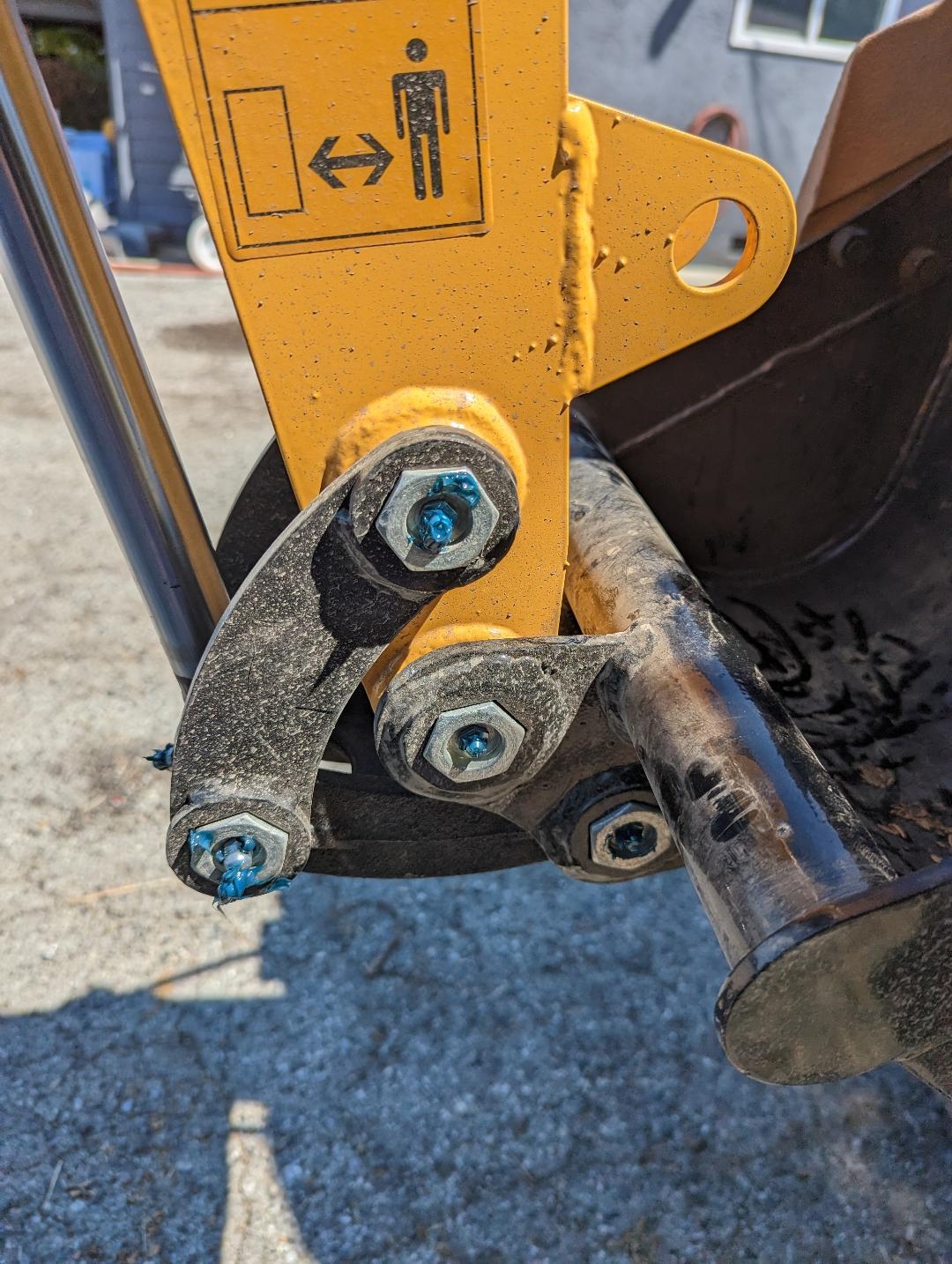

For you guys and gals paying attention:
There is an explosion of new owners of these small Chinese excavators in the US, Canada, Europe, UK, Australia, etc. With that, many new problems, and many new Utube vids, too.
I just saw one (JT's Okie) where his slew motor lost a bolt and broke its supporting flange. Check those bolts for tightness. New owners really need to open up their new minis and do a thorough inspection.
Another new owner just posted when he discovered these machines will free-wheel when descending slopes. They do not have wheel brakes or planetary final drives. DANGER!
I have learned to live with the free-wheeling problem on my steep slopes, and I have written about it above. But makers should fix it. No name-brand unit has this problem.
Be careful!
Be careful!
Most of the bolts on my Kat 12 didn't have lock washers even. Some are almost impossible to tighten unless your arms are like pencils. Liberal use of Loctite red is suggested. Improperly crimped hoses happened to me as well as leaky seals on travel motors. Don't expect to work these mini's like a Tak or JD.
There is a good reason they can be bought for the same $ as a quality zero turn mower. Are the junk? Nope. I'm gonna buy a heavier duty China Mini to work "hard". They are very capable for their size and weight but I wouldn't expect the durability of a $40,000 machine.
Pay very close attention to grade and slope ! Maintenance, maintenance and a daily pre flight inspection should keep you safe.
You have had about the worst experience I have heard of wrt loose bolts on Chinese minis, Fredrik. Sorry you went thru this. I had maybe one banjo hyd fitting come loose. I am not a big fan of thread lockers instead of proper torqueing and proper use of washers and nylock nuts. Sometimes you need heat to get them off when using products like Locktite. I also like to prelube bolts and the threaded outer part of JIC fittings so I don't have to fight rust when I go to remove them.
Glad to see you have not become discouraged.
