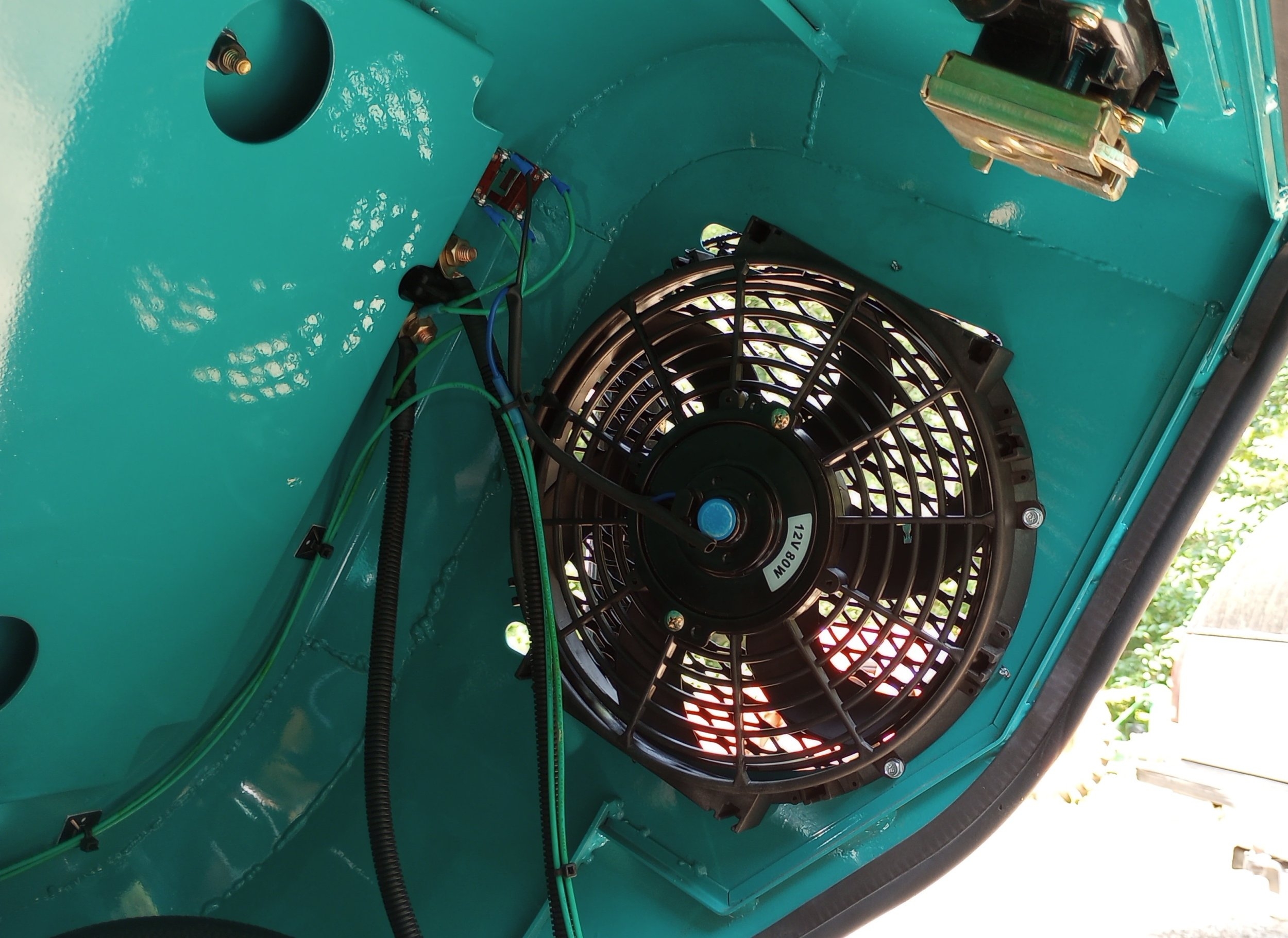

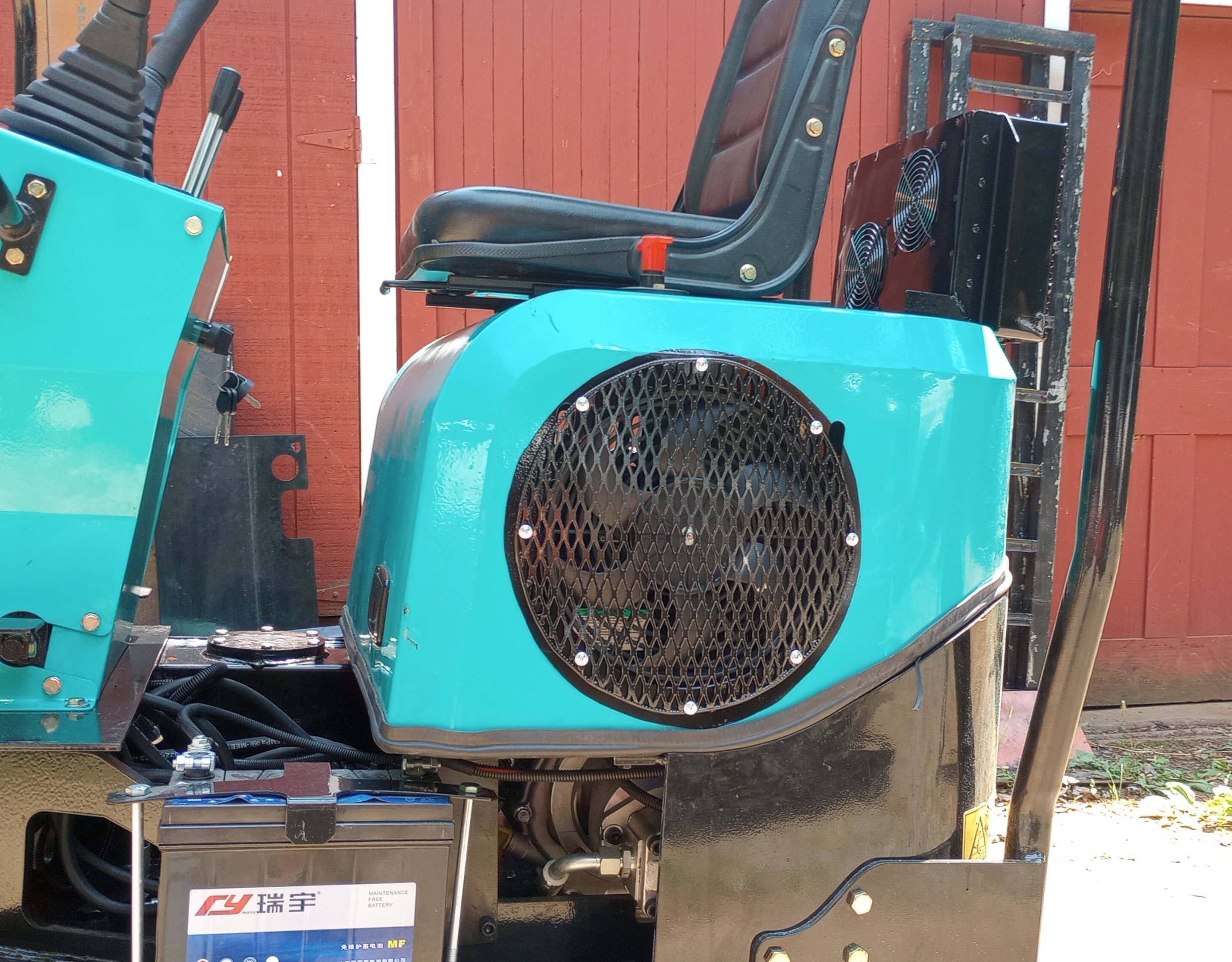

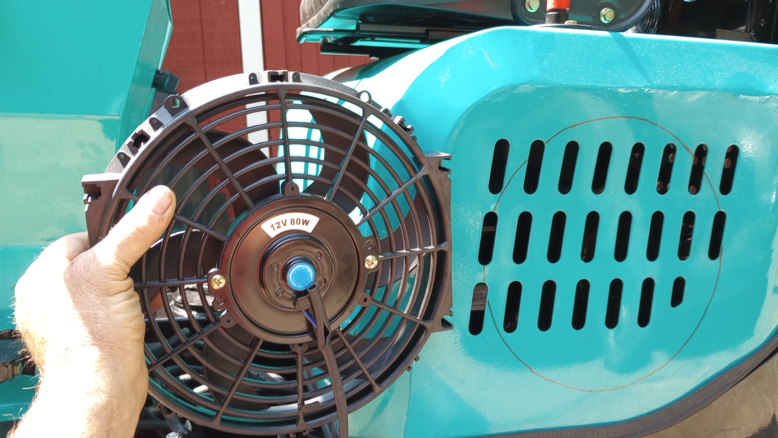

Main cooling fan draws 6 amps and blows 1750 cfm, according to the maker.Not sure about the amps but it puts out alot of air.

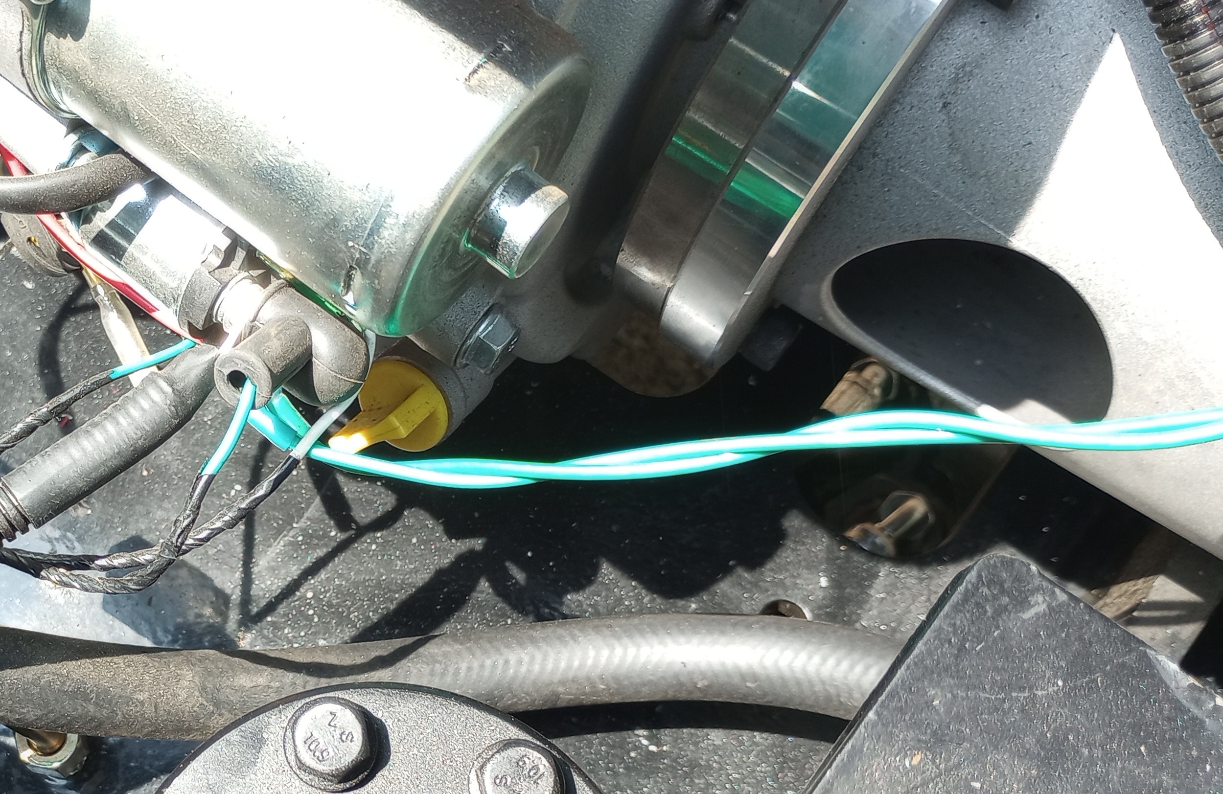

I wired everything on the left side.
.No other way to do it and keep things tidy.

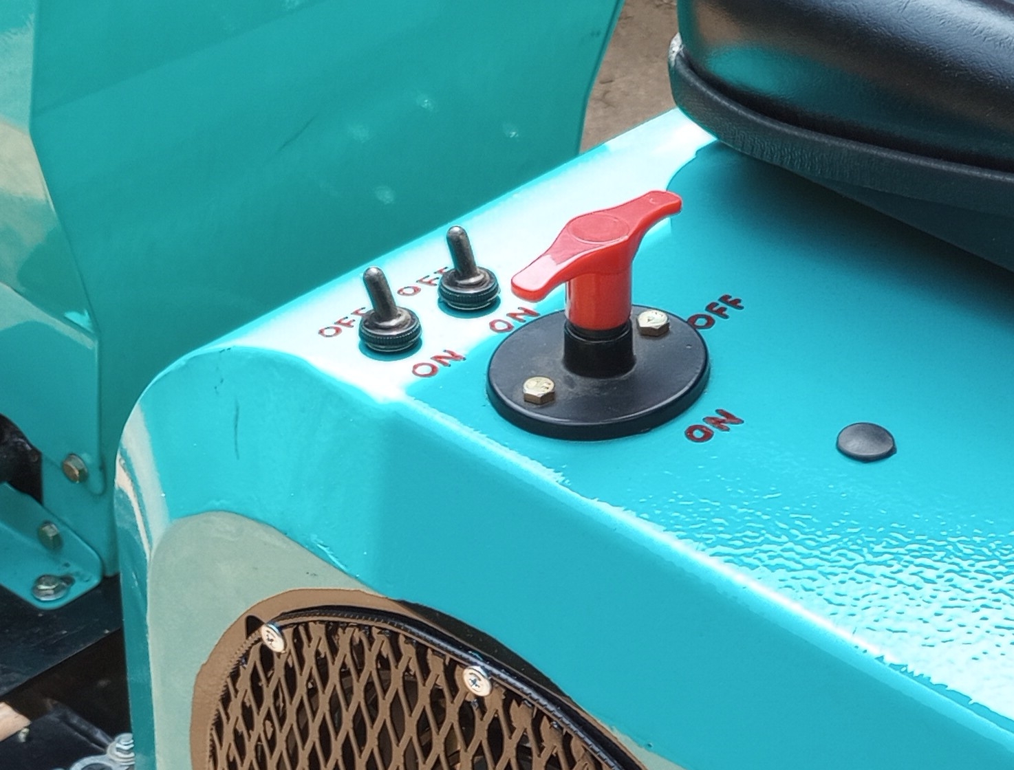

Wired right off the alternator and put in switches for each fan.
   / Importing and modifying a new mini excavator from China #485

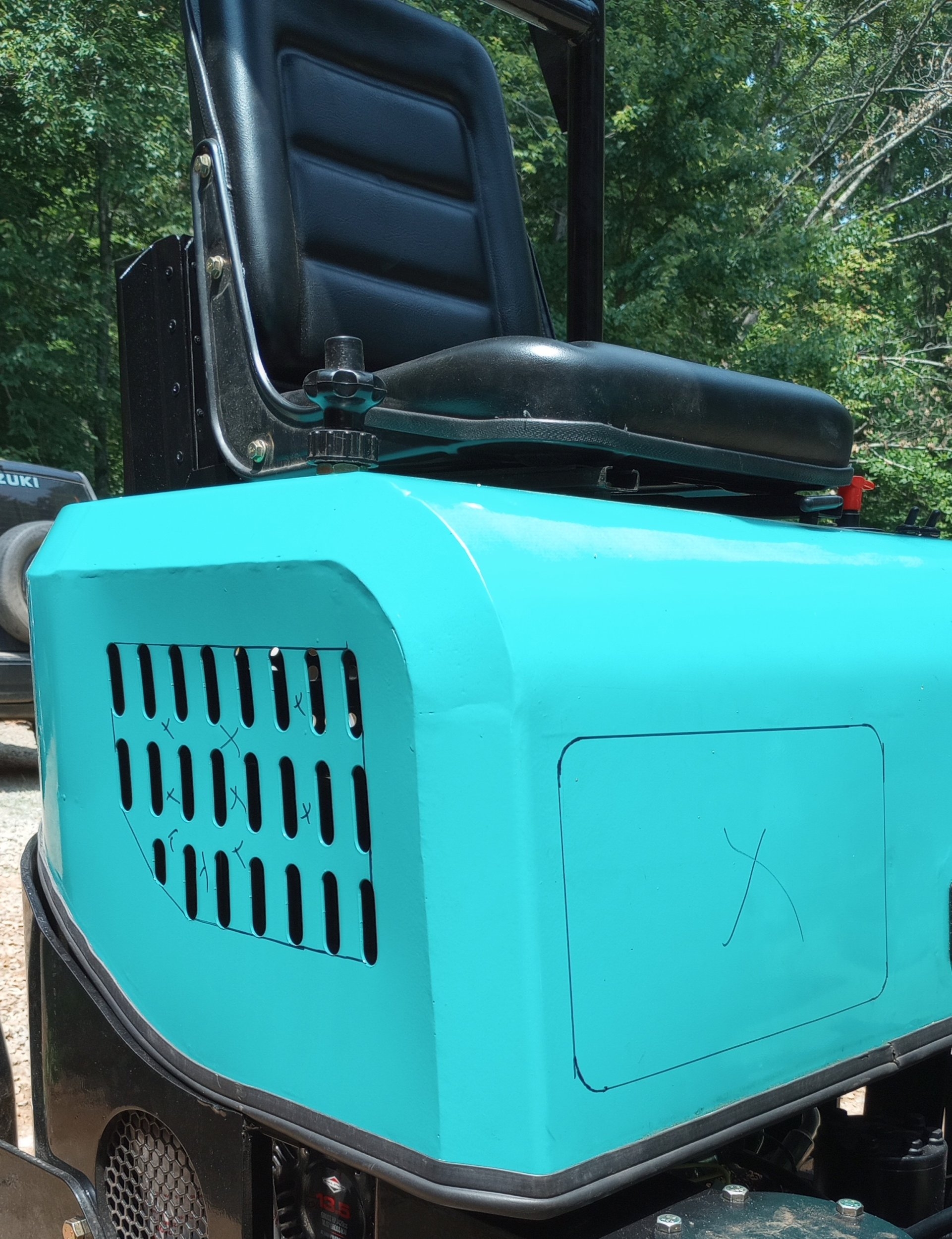

Still going to cut some more openings for more air flow.
   / Importing and modifying a new mini excavator from China #486
Almost forgot, I motored around on the mini for 15 mins this morn to see how hot I could get the oil. Track motors really heat up the goo. Never got above 35c. Feel pretty confident I've added a few more years of use to this mini.

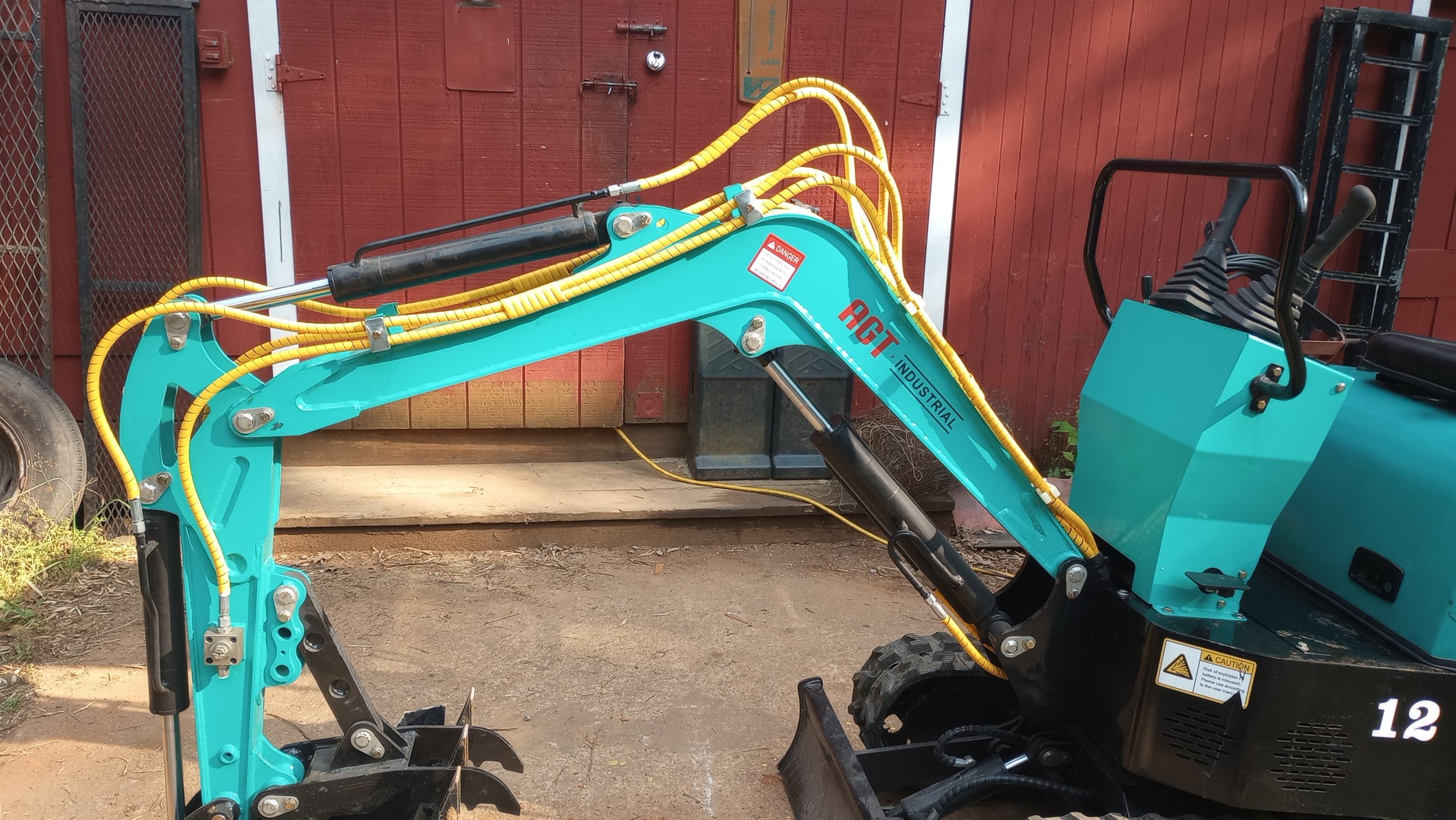

   / Importing and modifying a new mini excavator from China #489
What did you use for the wrap?
It's called Safeplast na ,also called spiral hose wrap .
Sold on amazon by Safe-Spiral store ,25 bucks for 25 feet. Holds up well in the sun.I've used it before. Good stuff.
