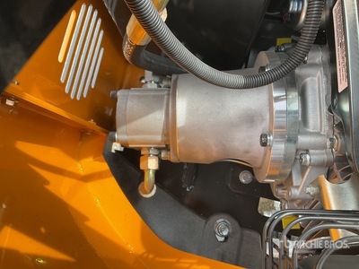

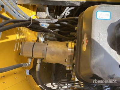

Ok, why does 1 Pump have a Double Stack?
Ok, I get that it would have twice the Flow up to 13.5hp. But what would it drive? The Track Motors separately? Track Motors and Aux Bank? Why only 1 line?

I don’t think that is a double pump but rather an unloading pump, like a log splitter. A crude form of variable flow hydraulics.

I'd guess it is a pump per track. Pisten Bullys have a pump for each track plus more. The last bully I operated had 5.
The bottom picture is a tandem pump. They share the suction side, hence why you only see 3 lines.
Having a tandem pump allows them to use two separate control valves and split all the functions between the two pumps. With one pump, everything is ran off a single pump, which makes it difficult to run various functions at the same time.
I could see the SUction being a part of the Housing, that make sense. The Control Valve bank is where I was confused. thinking the Track Motors and Aux have the little control sticks, but I thought they were still tied into the main Valve Bank Like Fredrick's previous picture
On some excavators they use a single sectional valve bank. However they can configure it to have two inputs (one from each pump) which then combine flows and return through a common section in the middle of the valve bank.
