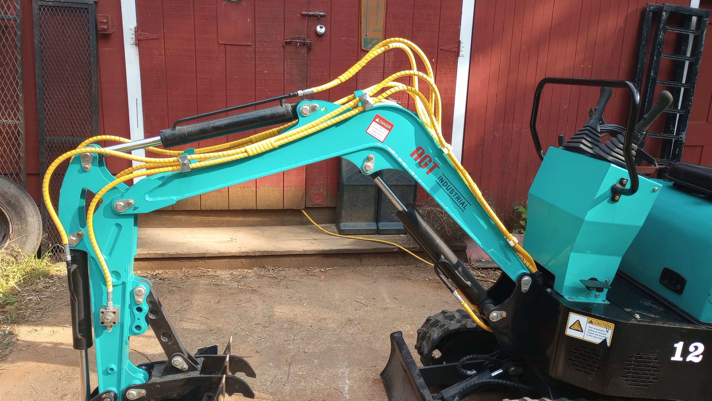

Hose wrap installed. For anyone who needs an estimate, I used a total of 50 feet.

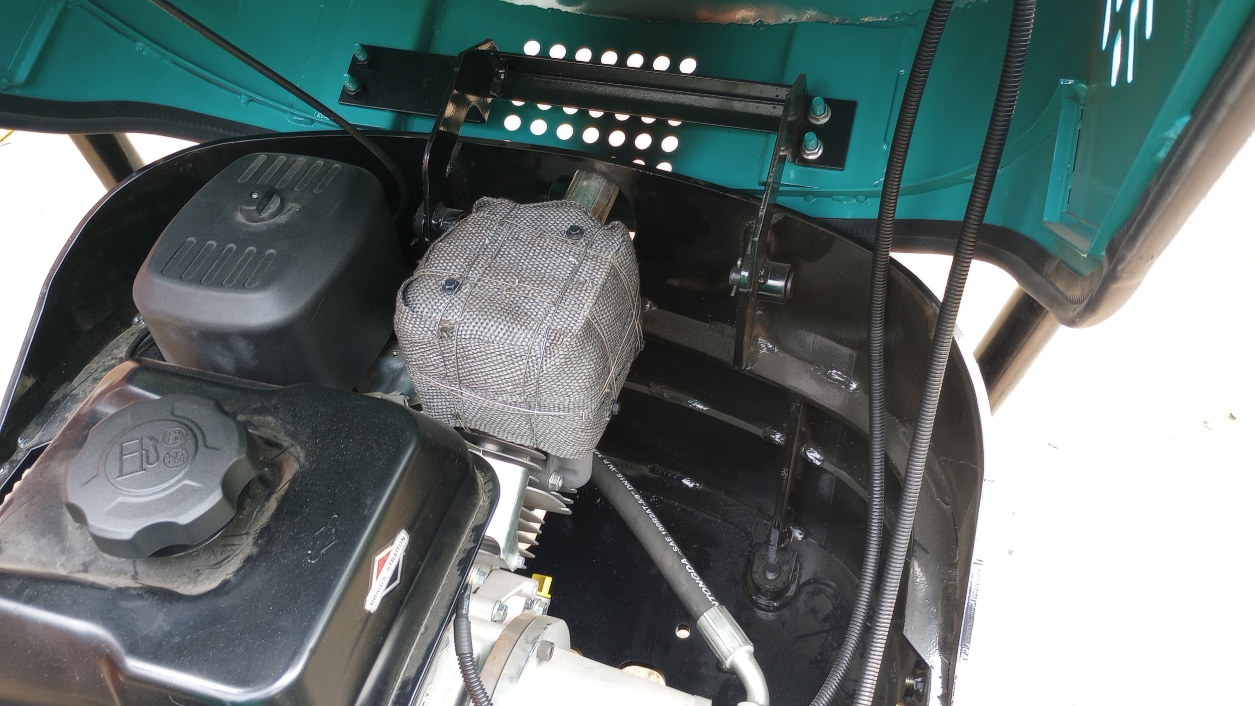

Put exhaust wrap on the Briggs muffler. Only deceased the temp by 25 degrees. I'm gonna put the cage bake on for safety.Double safety wired it on. Also made an extension for exhaust pipe to get it out side the machine.

How does that hose wrap work?
It is just slit open down the length and snap over the rubber hoses?

Ive had motorcycle headers burn out before their time .So duly noted, but your kind of turning it in a poor mans cat converter.
The wrap is cut in a spiral.You just wind it on the hose clockwise. It is cheap insurance against uv break down of the hoses. Measure your hose and add about 18" to length of wrap for your long hoses.
Yes done some digging but house gets so hot am waiting on fans and radiator before it will be ready for prime time. Digs better than I hoped.
