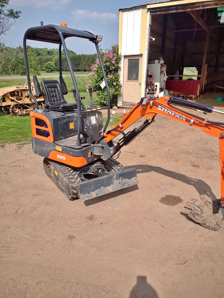

Found on FaceB in Merrill WI. Is this kinda the same machine?
2022 Shalka XG13 Mini excavator. 5 hours on the ticker. Nice little machine. 8500.00 FIRM Possible delivery.
   / Importing and modifying a new mini excavator from China
#512
Essentially the same machine, yes.
I can see slightly different boom brackets, swing-boom, cyl protection plates, Rhino-style plastic console cover. The name implies slightly heavier unit, but it looks like the usual 36-37" dozer blade. Same standard crappy bucket.

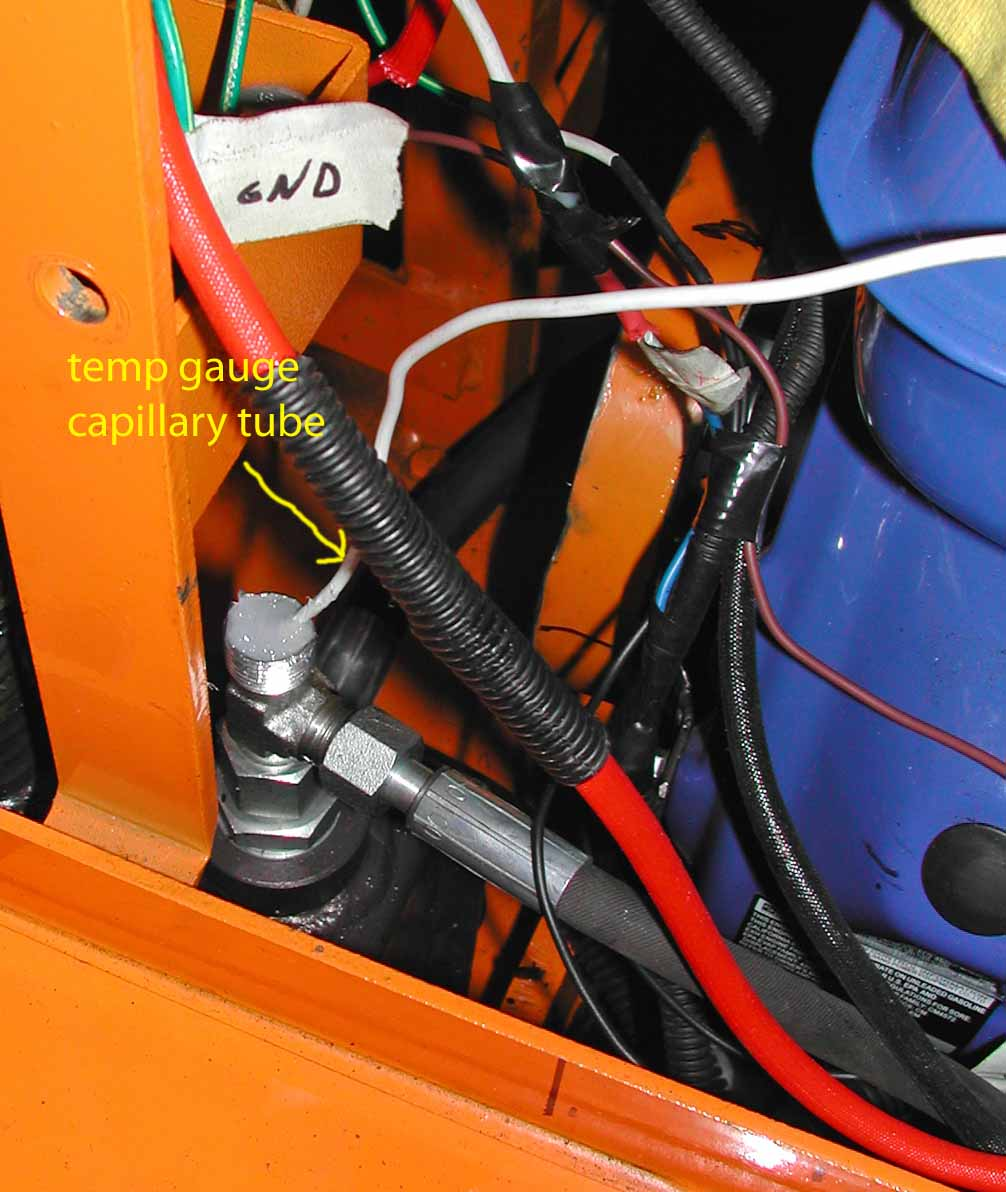

Has anyone attempted an Oil Temp Gauge? I was thinking to tap the Tank for the sensor.
#518
See post #41 above. That's a capillary style temp gauge, which works fine on my machine.
   / Importing and modifying a new mini excavator from China #519
I am not getting the Capillary Tube idea. If it would fit through the Fitting?
So the Return Hose to the Tank has an exit port? Or did you add a TEE, and leave the Sending Unit in the bottom of the tank?
#520
Yes, I used the tee fitting so I could put a capillary tube in the tank. The other drain on the tee is the case drain from the distribution valve. I doubt much oil goes thru that hose, and it was simpler than teeing it into the return line upstream of the added hyd filter.
Note that I disconnected the original return line from this tee, and fabricated a new larger return line next to the new hyd filter.
