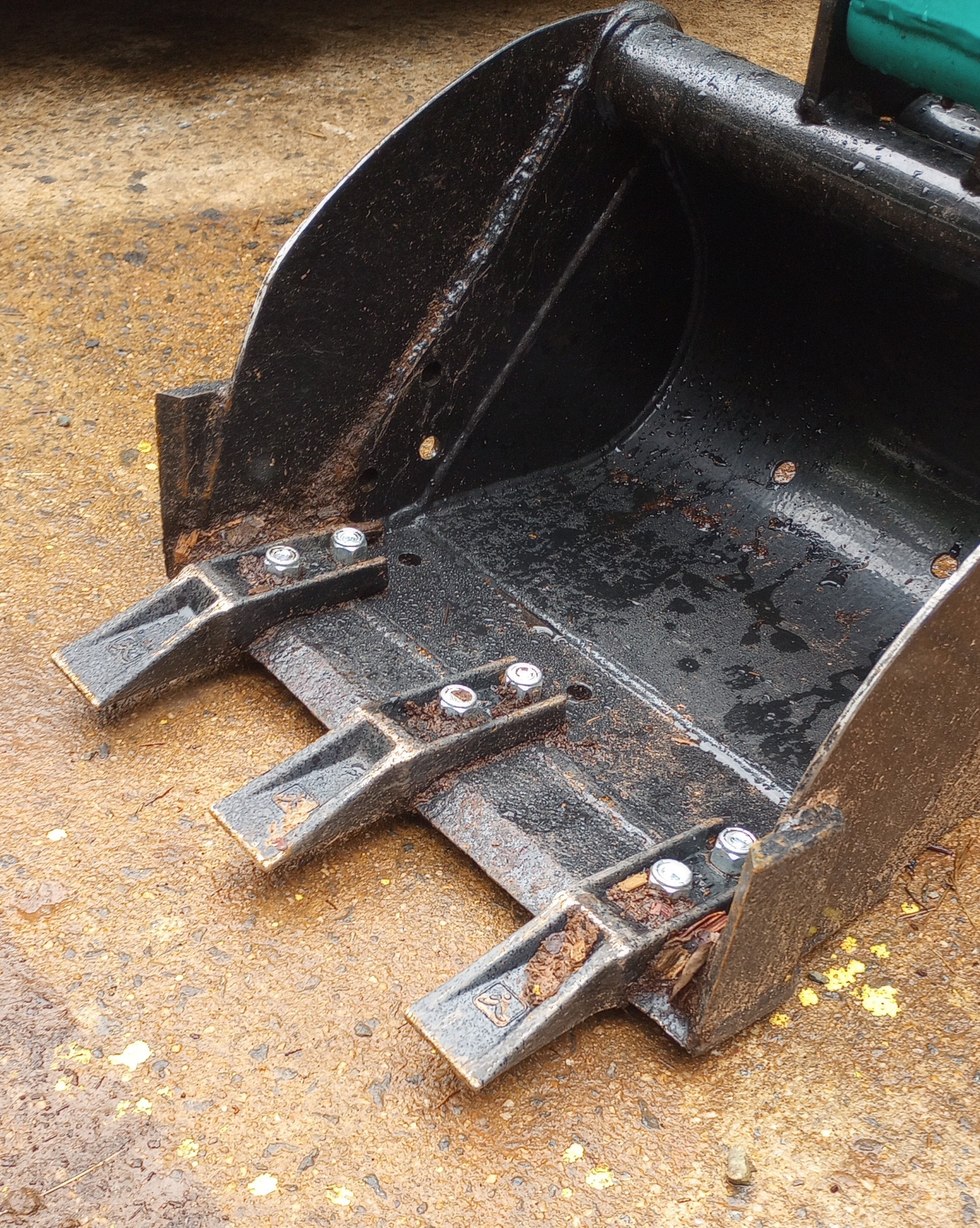

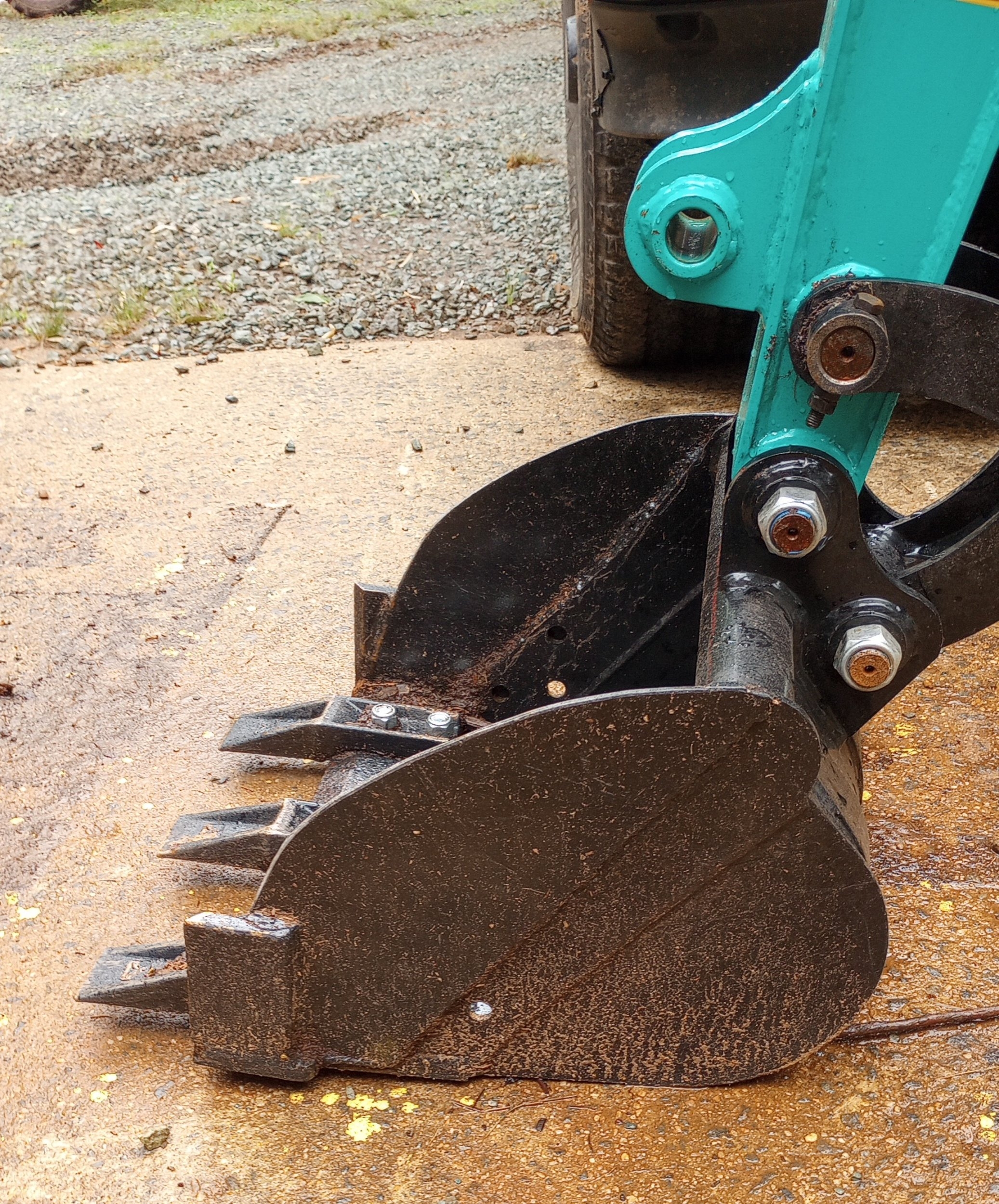

Same standard crappy bucket.
Yes the buckets are small but there is a cheap fix.
I cut a piece of old road grader blade and welded it on as a cutting edge and cheeks as well as adding more 3/16" plate to sides.
The odd shape of the side doesn't interfere with picking up things with the thumb. Looks funny but doubled the per scoop capacity.
Looks like a good solution.
As to the teeth, your modification shows that the backward tooth problem requires more than a simple fix. Adding steel to the cutting edge before reversing the teeth is necessary, as you have done. Nice job.

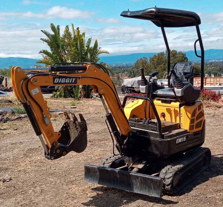

Here is the mini-X a friend just got, a Diggit EM15.
Interesting machine. It has a 43" wide blade, and it is 64" long, from tip of blade to end of track. The tracks look to be a bit longer than my XN08. I will post the track size later.
The boom is offset to the right a few inches, and there is no counterweight. Both are surprises. Sadly, no hyd oil filtration I can see. I suspect the weight is still about a ton despite slightly larger size, since there is no counterweight.

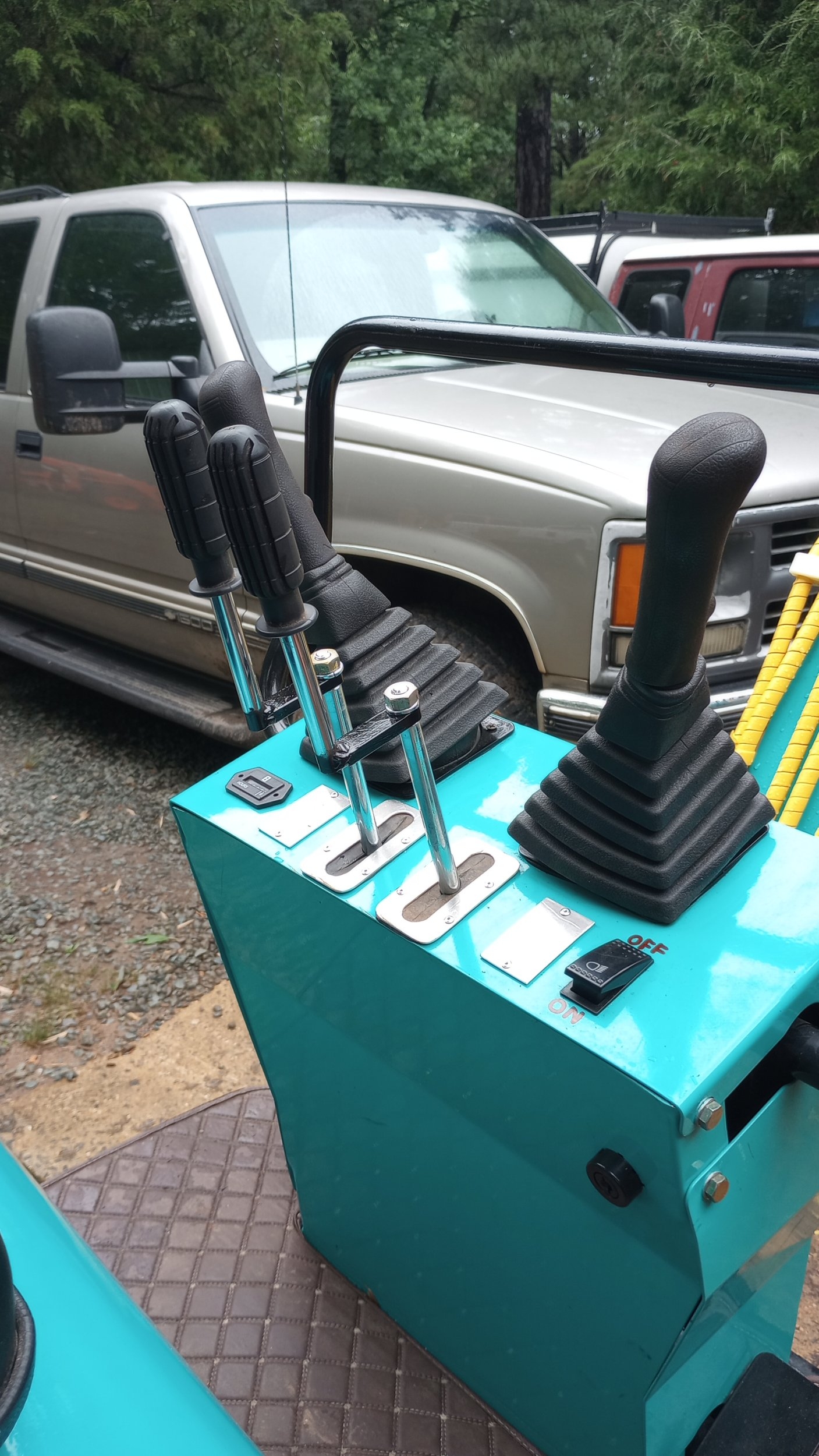

The biggest and most significant difference is the servo controls. They are hydraulic, not electric. Operation seems a bit smoother than the non-servo units I have driven.
More pix coming.
