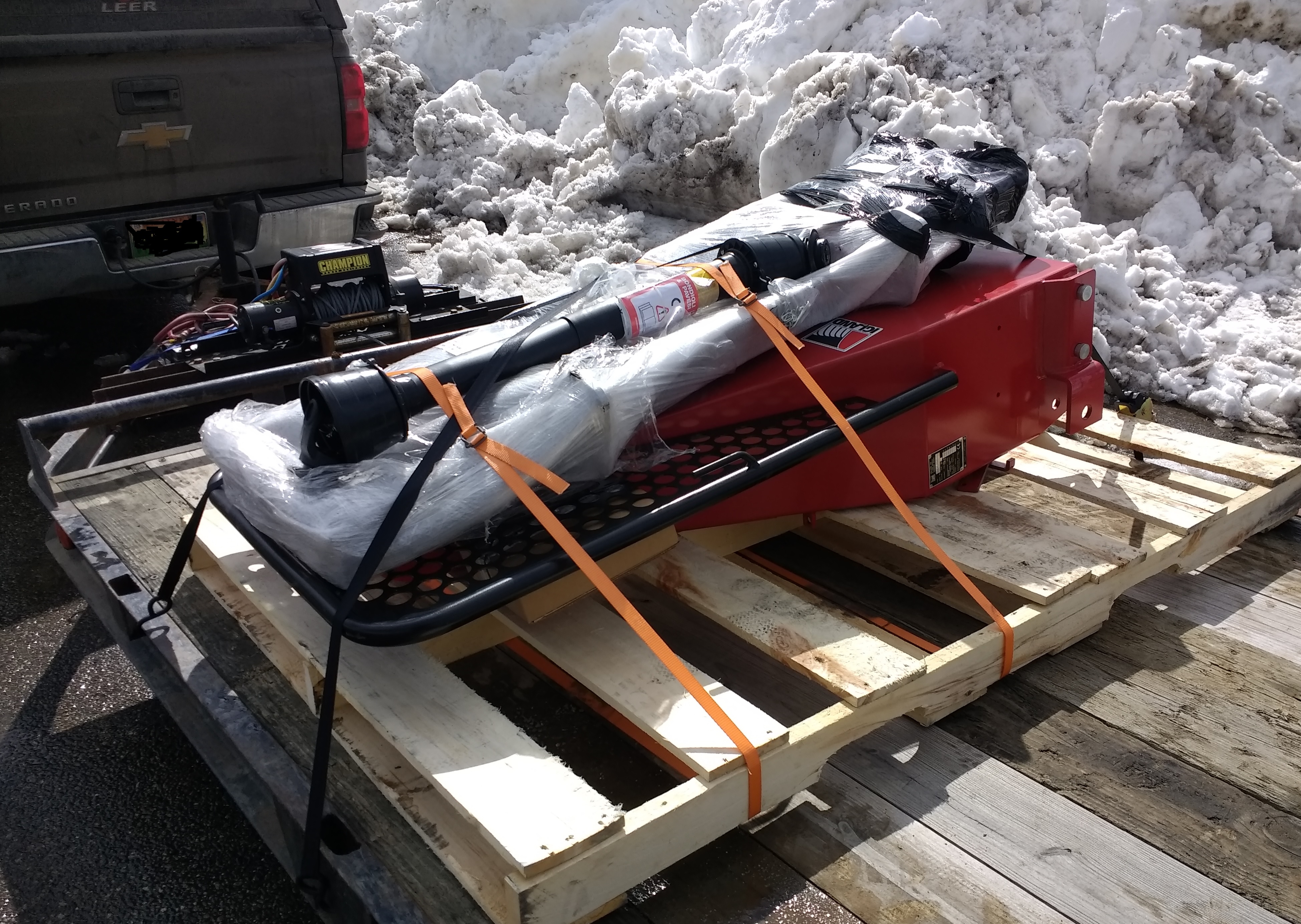

I bought the same Igland 4501 winch from Reed Supply also. I love it so far and it has helped me a lot pulling out trees. It is fast and gets the job done. Anchoring against the base of a tree or a stump works very well. I pulled out a full length 22 inch in diameter Ash tree with branches the other day like it was nothing. Here's a link to mine and the rear tool box I installed. http://www.tractorbynet.com/forums/...0d1512824640-few-new-attachments-dsc01168-jpg

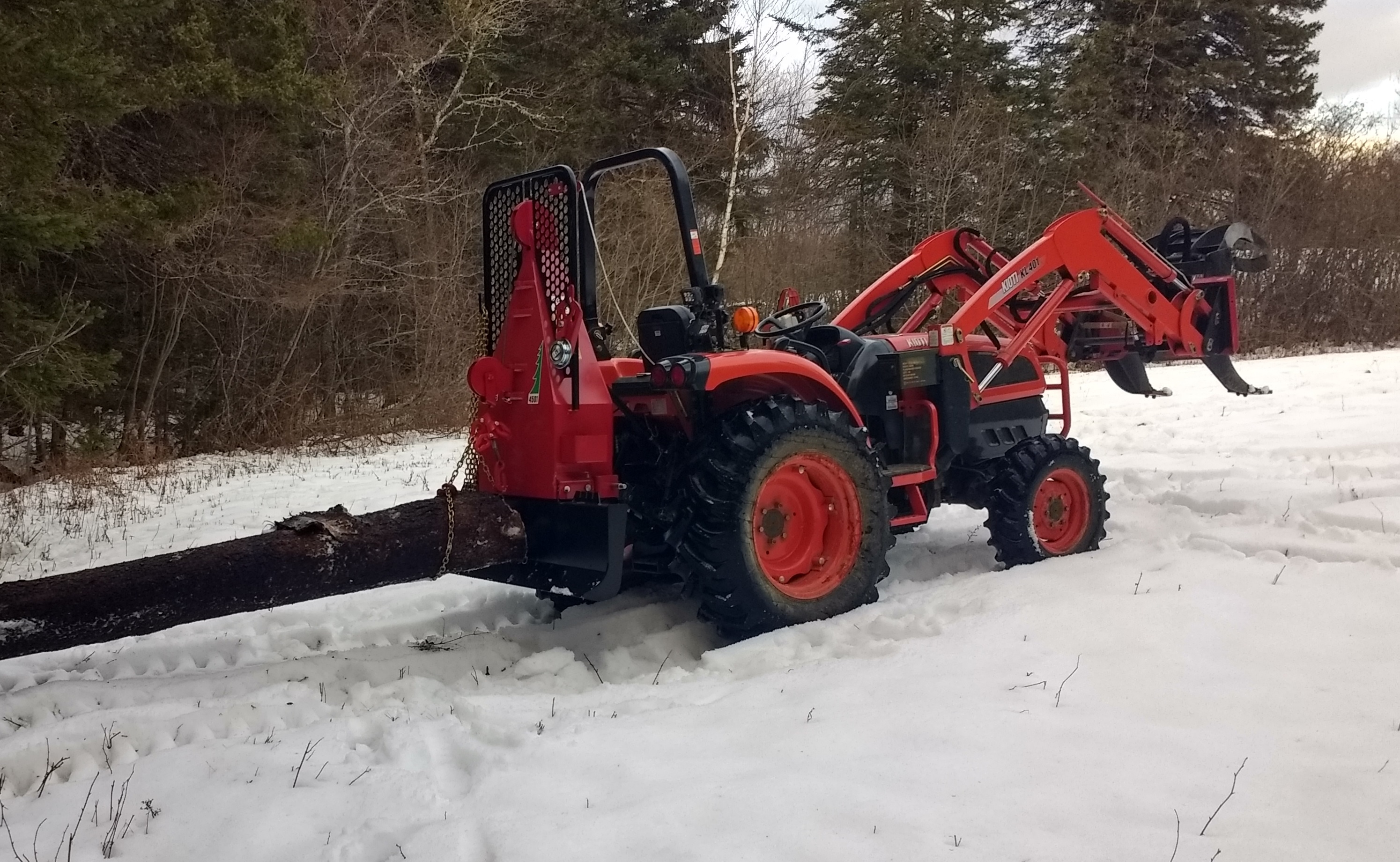

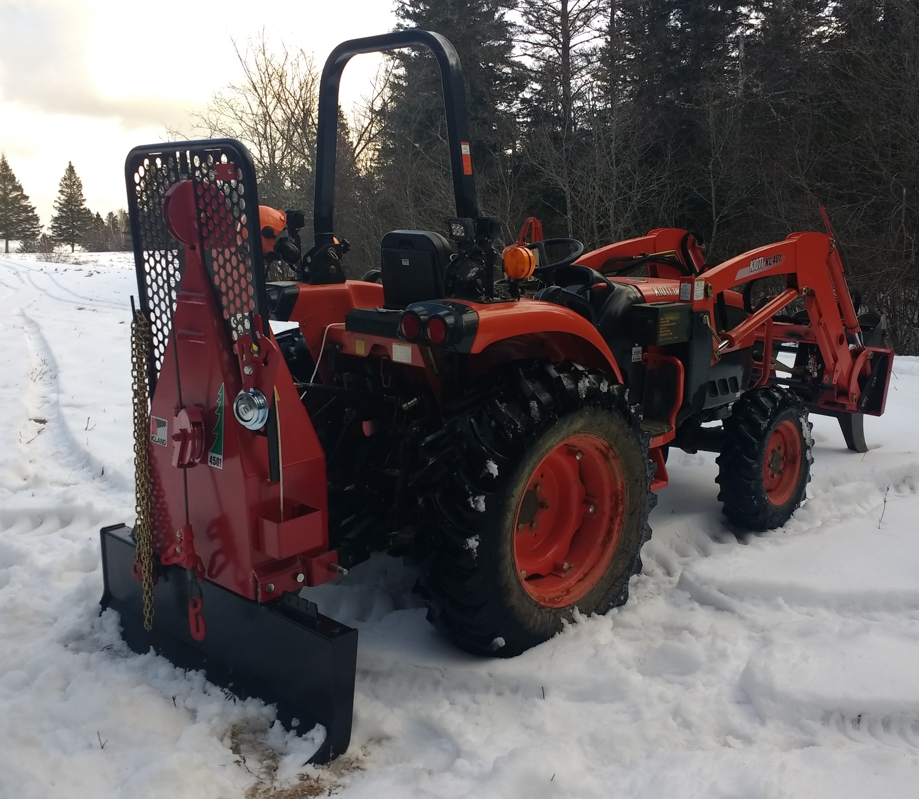

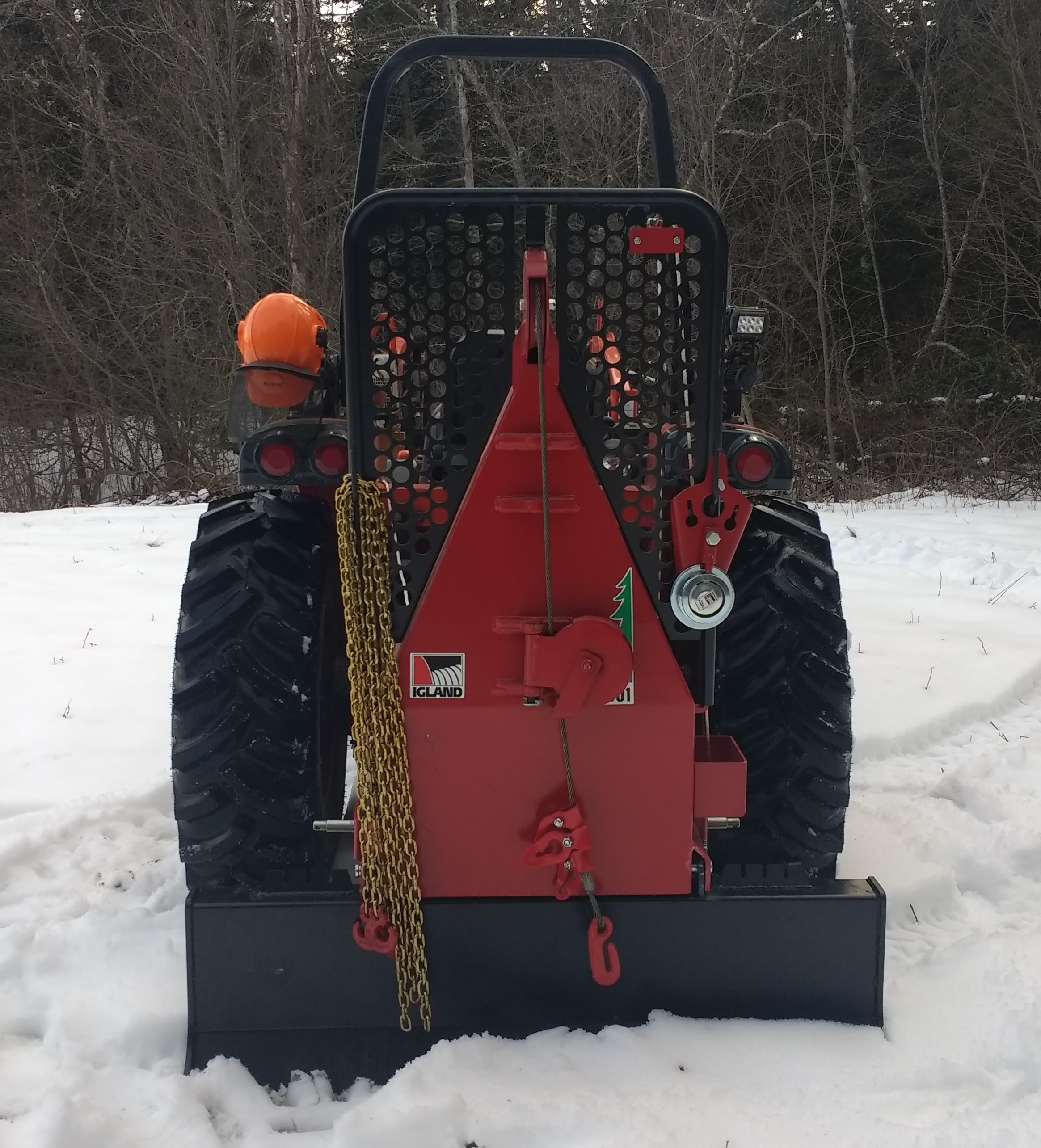

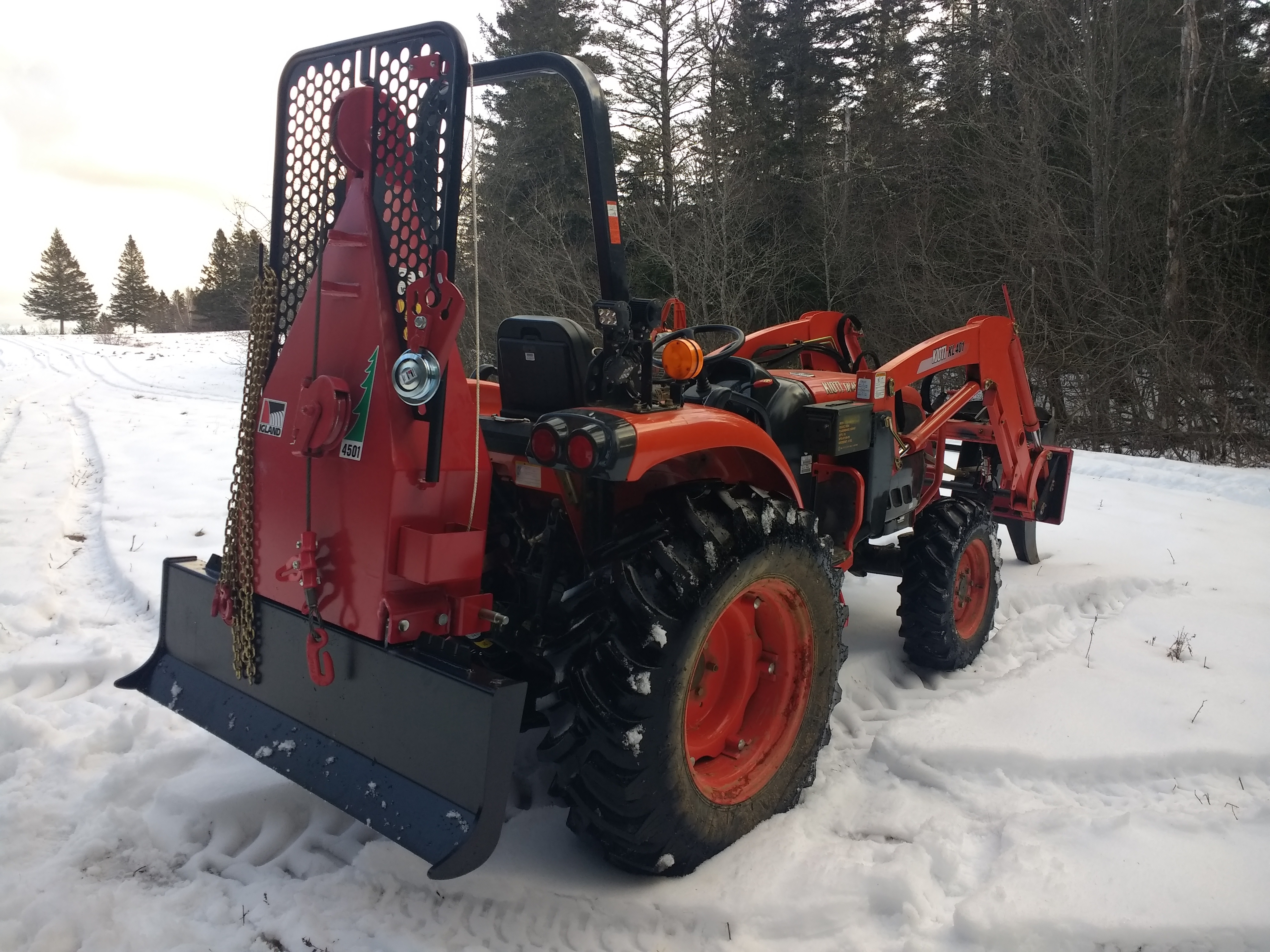

Very nice. I've been able to pull some 60ft white pine through the woods with the cable fully drawn out. I couldn't be happier with it, and I cant imagine, unless I'm getting into some serious production work, that I would ever need more of a winch. Even at that, my DK45se is the limiting factor here, certainly not this winch.
