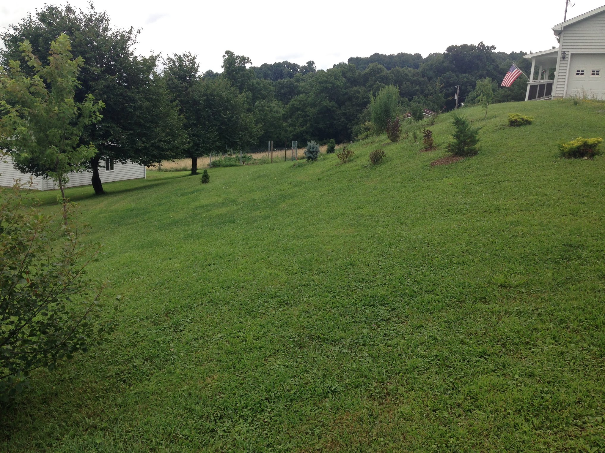

OK, First post, longtime lurker. I have 12+ acres of (somewhat hilly property. 1.5acres lawn, 4acres 'field', the rest woods.Here's my situation. I've been looking at tractors for the past 6 years. I intended to purchase a larger tractor for the hay field and landscaping tasks. I bought a CC XT2 lawn tractor when I moved in 6years ago, thinking it will last and handle mowing duties and keep hours off the tractor. So much for that...
I can summarize tasks into three major tasks:
Mowing*: I currently own a Cub Cadet XT2, 46 fab deck, diff locks, lawn tractor. The TT K46 transmission is already shot at 180hrs. I don't abuse the mower, but I use to mow, and pull a garden cart. Dealer wants $1400 to replace the trans.... i've discussed local repair shop or me doing same replacement for about $800. The catch is... I don't want to replace the K46 with another one.... I don't want to replace a transmission every 5 years, plus I want to be able to work the machine and not worry about burning the transmission everytime I mow or move firewood. I've considered replacing it (myself) with a K62 for 1600$, with the intent of it lasting longer. (*edited nov2022: I bought a new mower to handle yard mowing.)
Maintenance: 500' gravel driveway maintenance,4acre Field / brushcutting, maybe annual snow removal on occasion..

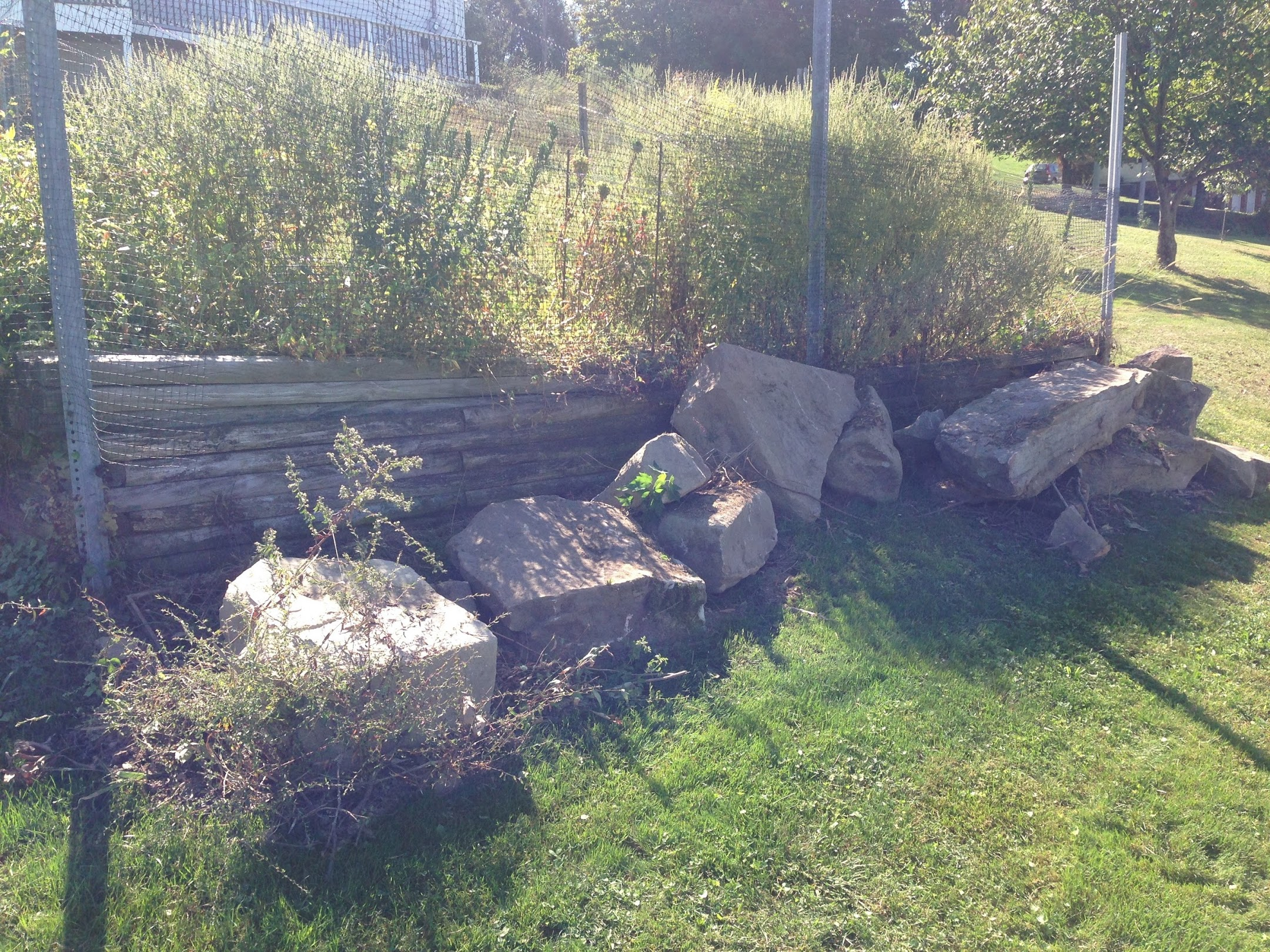

Landscaping: The largest (most challenging tasks) are to move large rocks from the field/woods up to the house for retaining /landscaping walls. How big are the rocks... well, all sizes... they come in tiny, (I can move by hand) to big (can move by tractor,(big, think 1'x2'x4'),), to house size. I don't consider the property extra hilly for WV, in fact, I'd call it mostly flat. The picture of rocks by the garden are typical, they were moved by my neighbor's TYM 4series tractor, and he said it was about maxed for the big ones. Other tasks... building retaining walls with rocks / patio / installing drainage lines, leveling the lawn (smooth it for mowing), property clearing (cutting/moving trees)... etc... (re-locating the driveway entrance uphill)

You probably need a stone-boat to skid the large rocks with a compact tractor.

My previous Kubota B7100 hst moved lots of rocks of the size shown. If it could not lift them it could push or pull them.
For the work that is mentioned a slightly larger tractor with backhoe should be suitable.
