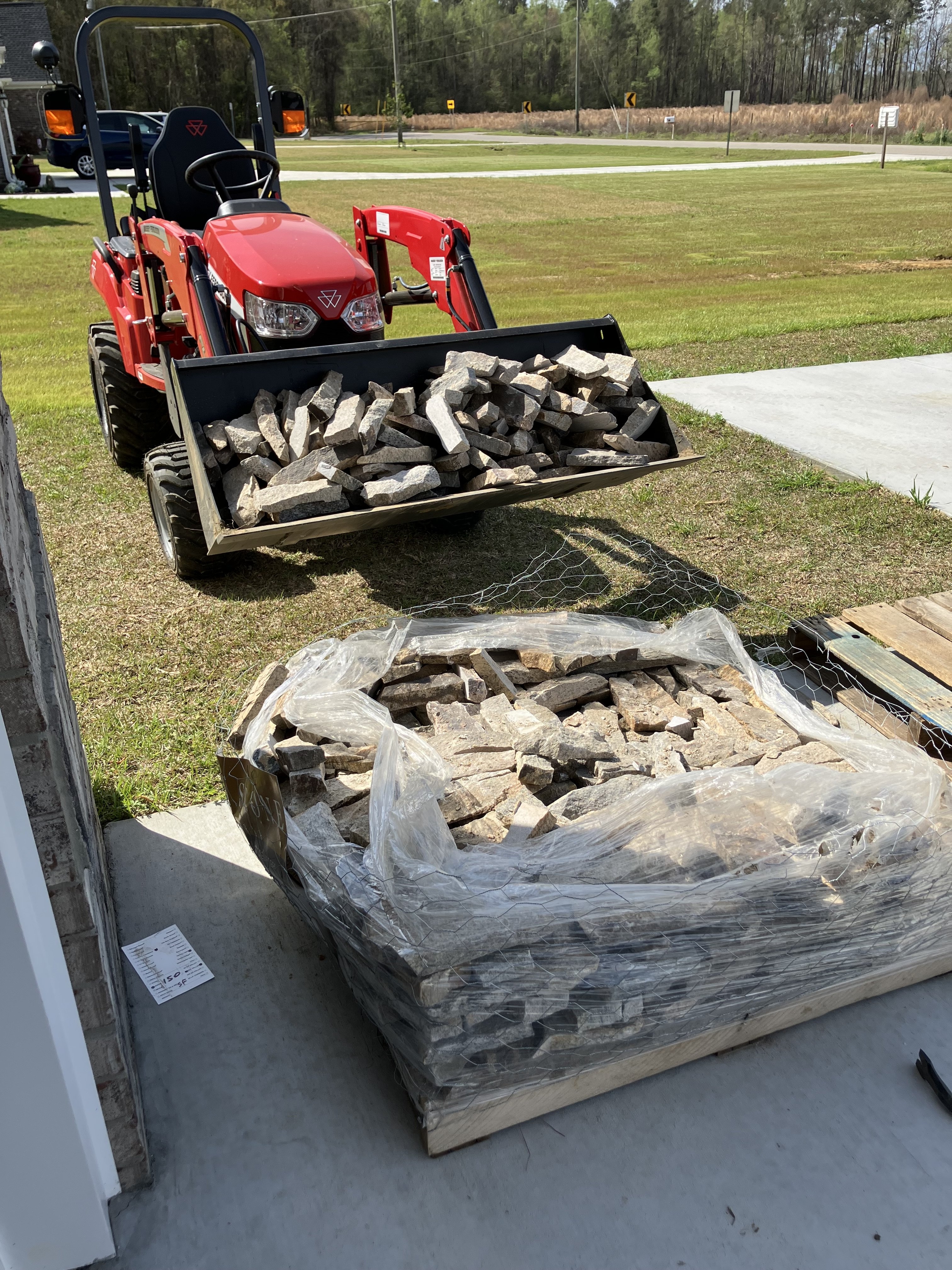

First motorized wheel barrow project. Relocating extra stone from fireplace project to back of property. Pallet forks would have been nice, or chains with hooks…

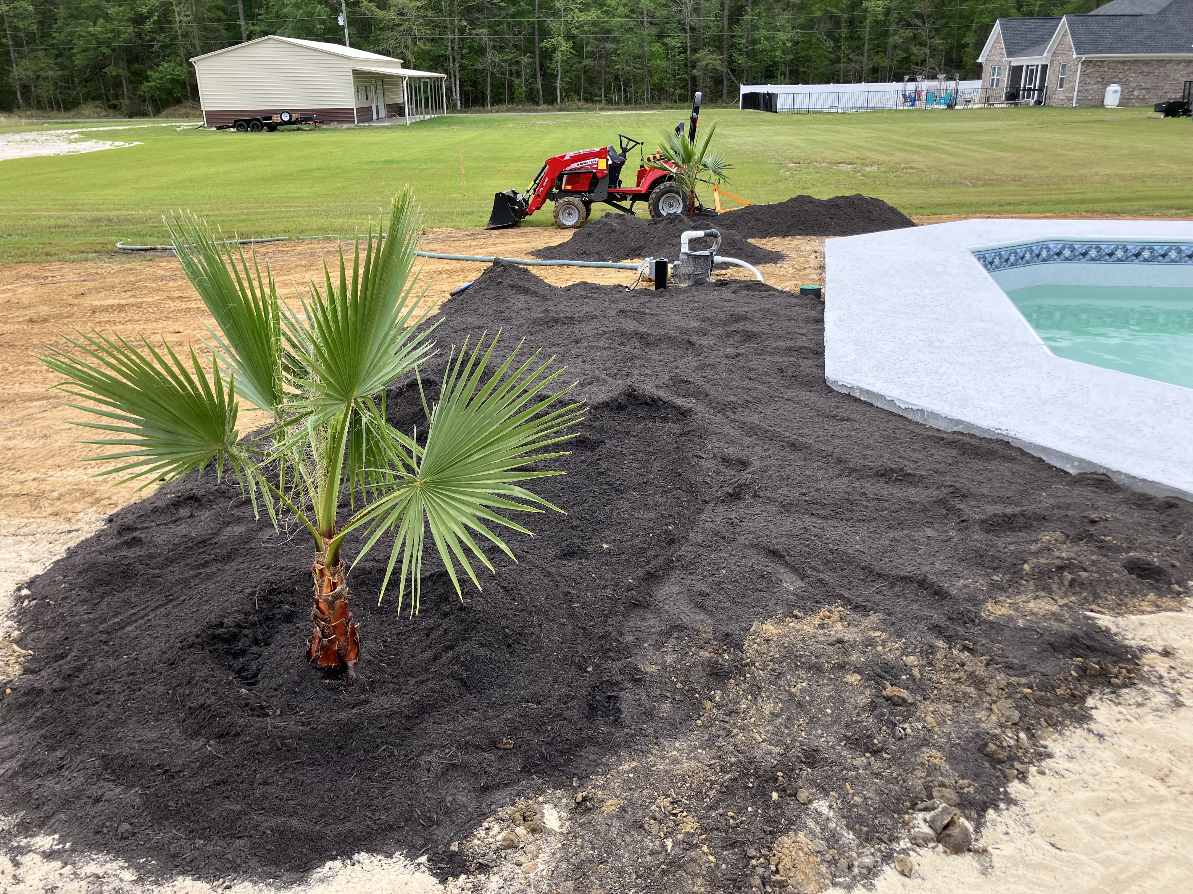

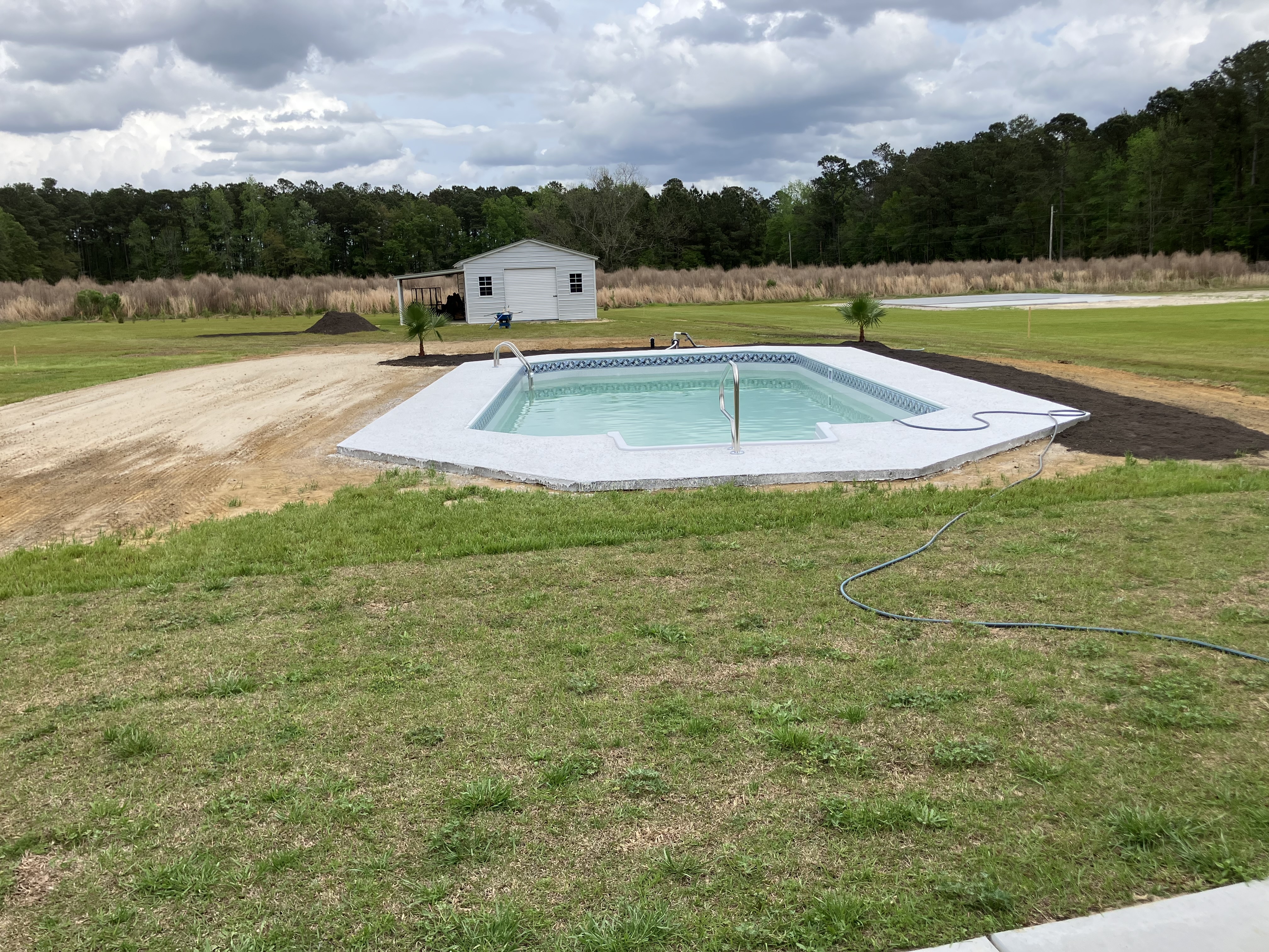

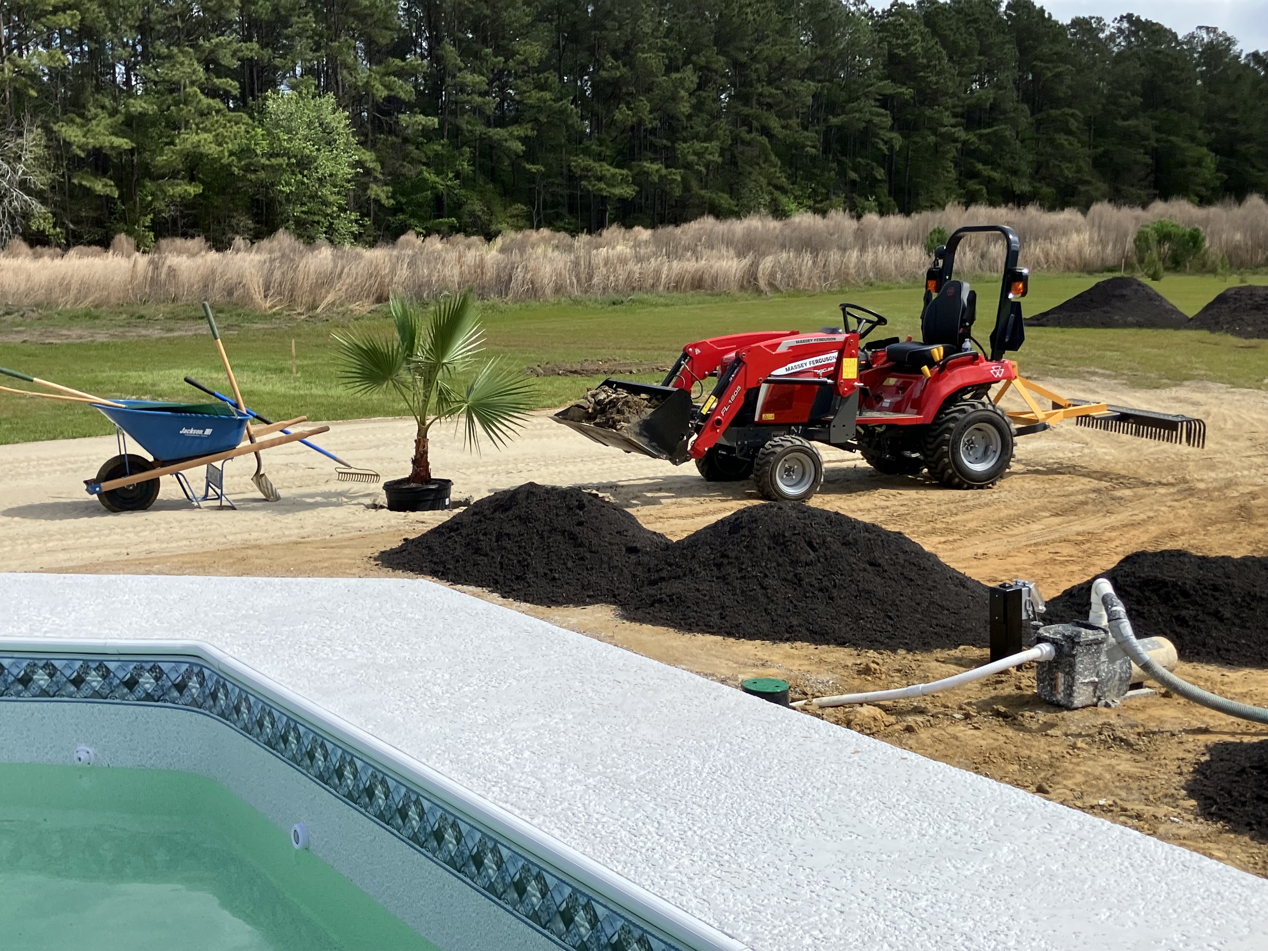

Mario's first real project - Palm Sunday.
Planting, adding top soil, leveling and raking.
Just need to finish leveling the many rutts from the pool compay’s equipment............
