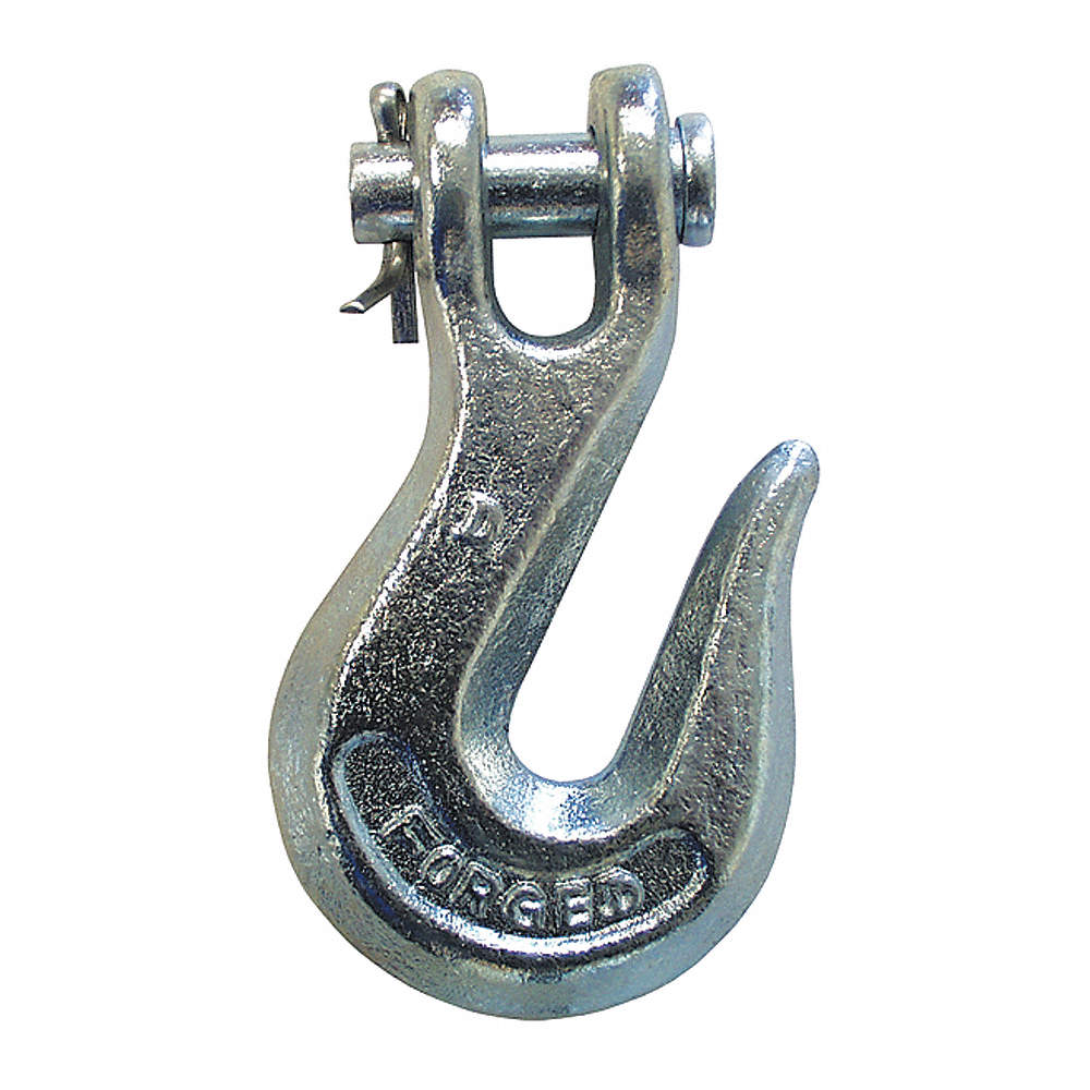

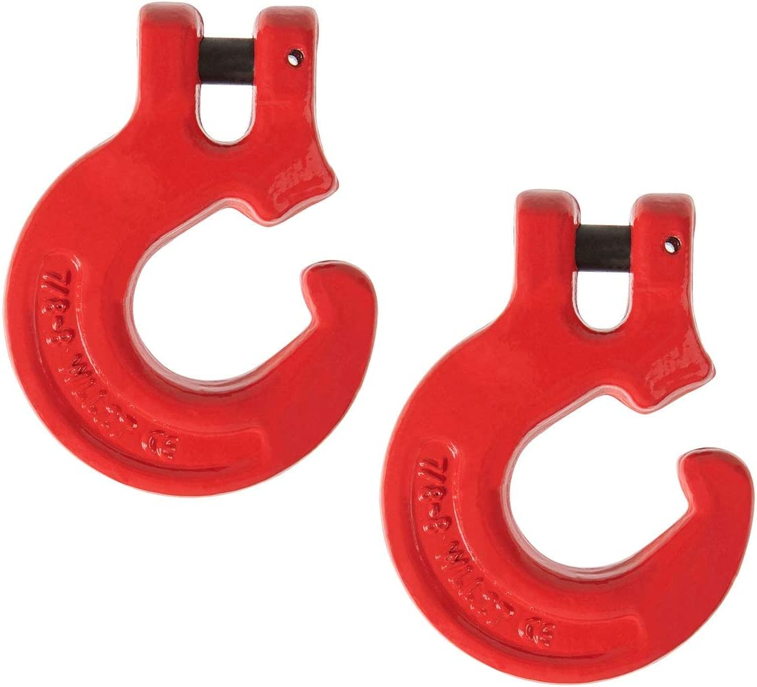

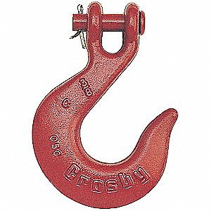

Question: as you are an experienced user now....if you could have any end you want on the end of your cable would you want:
A) a slip hook
B) a grab hook
c) a logging chain choker hook
D) a knob choker
I use D) with 2 keyhole sliders but sometime wish I had A or B when pulling on things I don't want choked.
