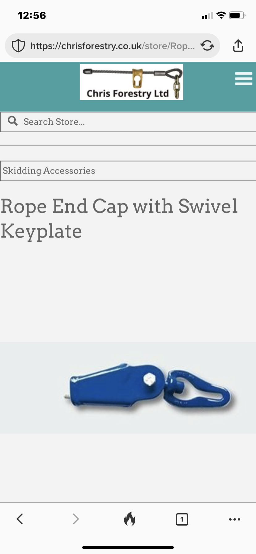

I use this for the end of the working line.

That's what I use as well.
It allows for cutting off the end of the cable that catches all the he!! and is easy to attach any of the other style chain hook on 4 links of chain, think "adapter" for whatever you might need to hook to.👍

thanks... does this pull on the existing crimped ferrel or does it clamp or crimp to the cable and ferrel gets cut off?

It's a compression wedge fit on the bare tag end of the cable.

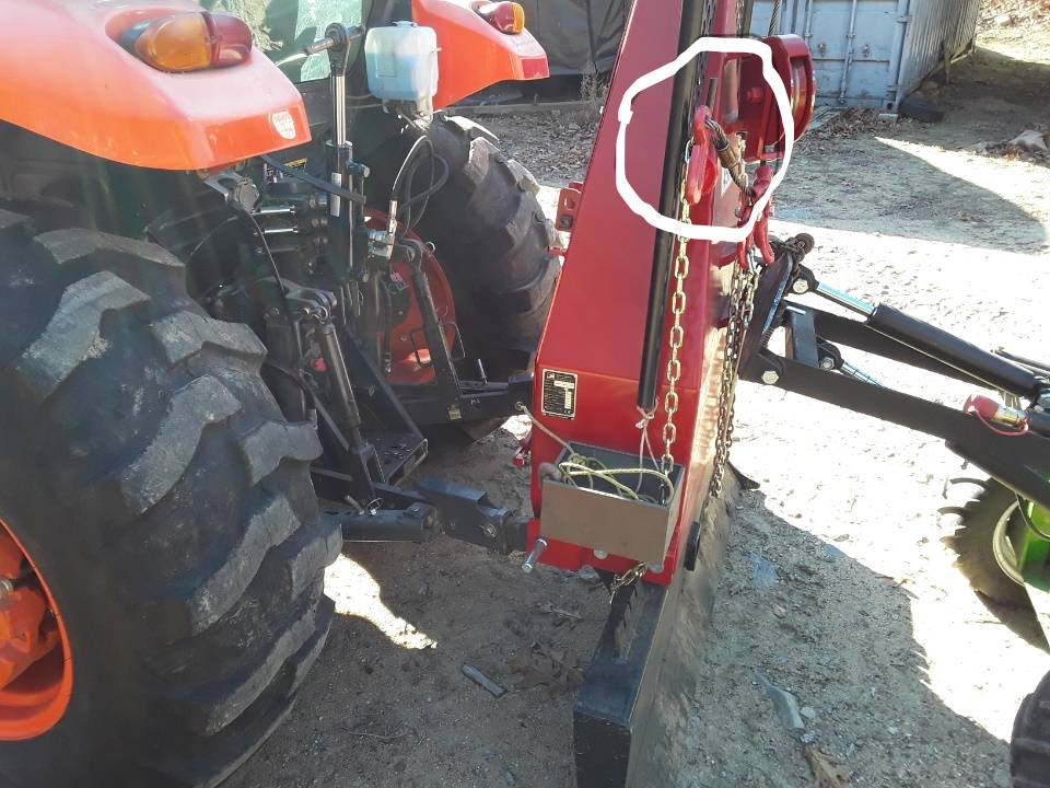

As far as the hook, I like the one that came with the winch. I attached a pic that I had in my computer (sorry for the wide view but I think you can enlarge and see it). The hook has a deep throat to slide through the brush when retrieving it and not wanting it to catch on roots and branches, yet keeps a chain in place.

That looks handy as well.
