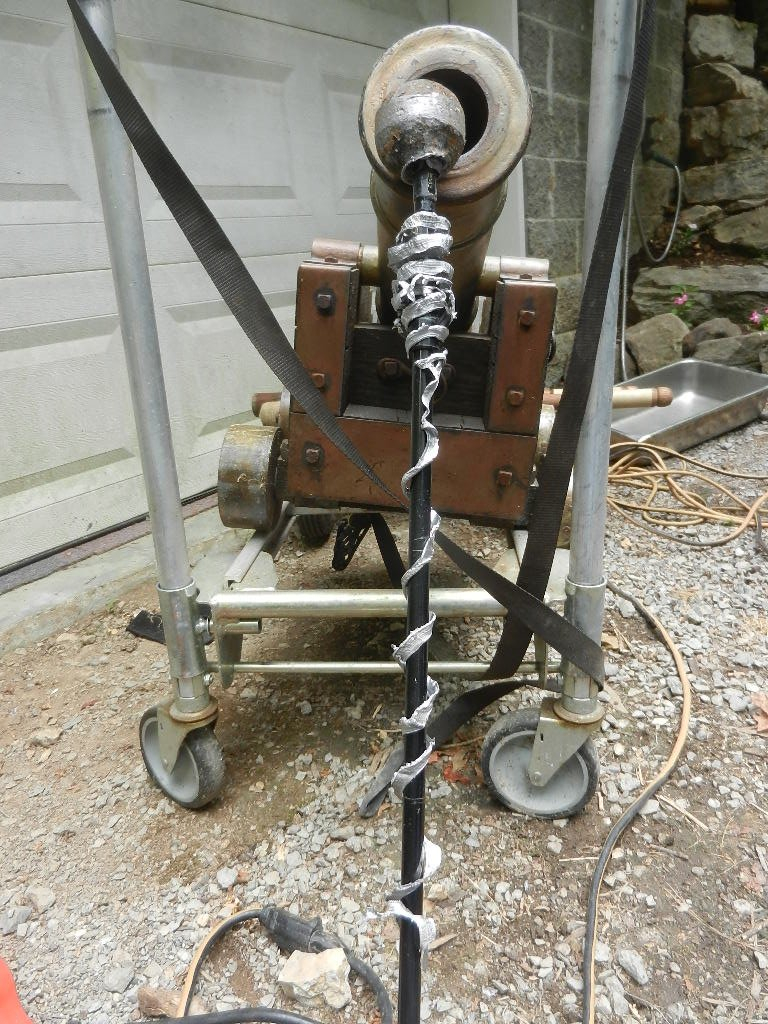

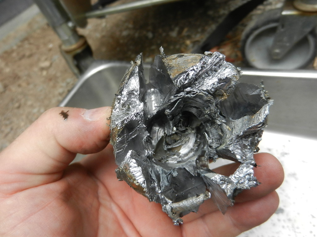

Here's the ball that came out. The flat side that's on the right side is what I referred to earlier. No idea how/why it's there. No idea if that was part of a deformation issue.
When the drill bit "bit", it ended up spinning the ball. You can see the smooth sides on the ball where it spun in the bore.
Bit was buried SOLID. Rather than try to saw it out, I just got my air chisel and it made short work of it. I didn't want to destroy the ball but I would have been fighting this for a much longer time had I not. Besides, I don't intend to actually fire a cannon ball, just to be cautious AND, since I still have the mass of led, I'm willing to bet I could take it to my newest best cannon friend and he could melt it back into a ball (he sent me some pictures of his ball making tools)

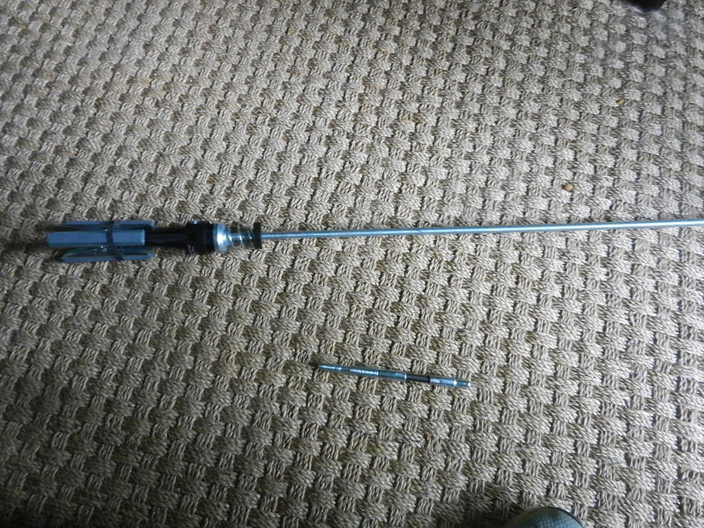

One of my issues on honing the bore is/was the hone is too short. I saw what should work but passed while I thought about it. This morning, I went back to get it thinking I could probably buy a drill extension at Home Depot and extend it. (I was wrong)
Just no way the above is long enough... I meandered through the store...debated on just taking the hone back... then it hit me. The right half screws in....so it will unscrew.
I can go measure it and find out it's a (I forget) 3/16th's 16 thread....and move everything over to a threaded rod...
and viola, I have my extension for the full bore.
