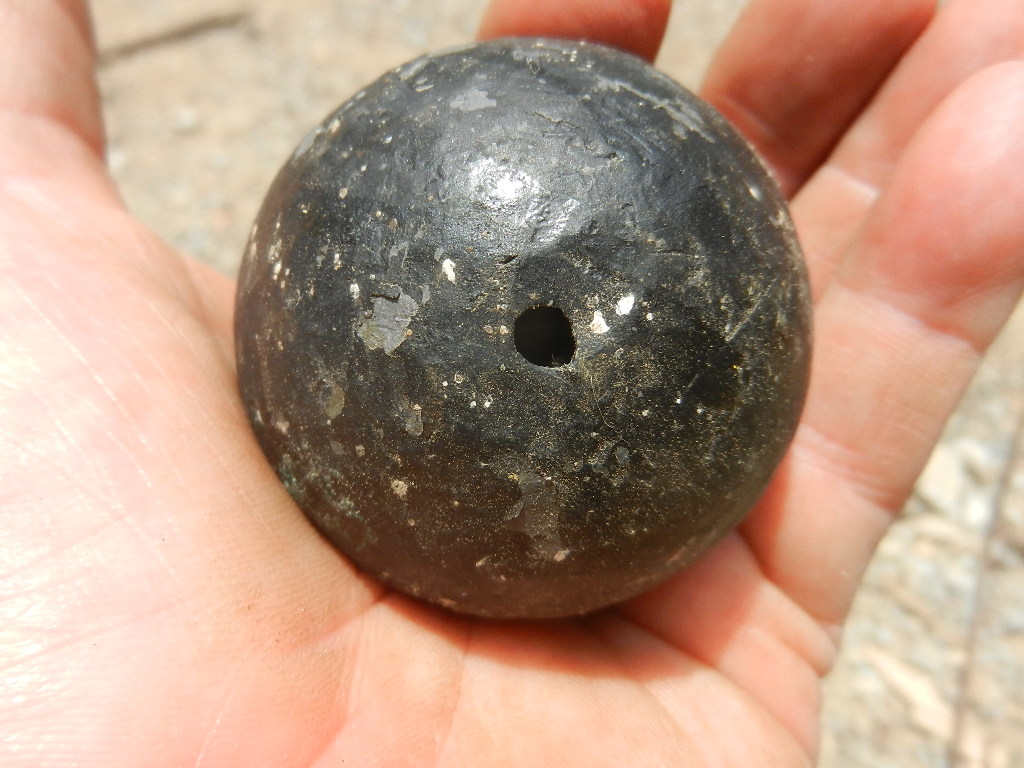

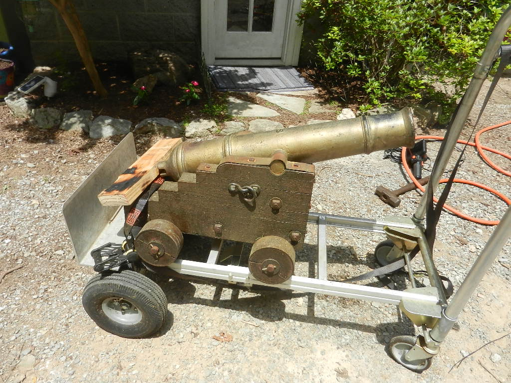

1. I inherited a cannon.....yes, a cannon. It's been in the family for probably 50 years, possibly more.
2. As a kid, we'd fire it with rags stuffed down muzzle. Since then, Dad has acquired 10 cannon balls
3. Dad (92) hasn't fired this in years/decades. Somewhere along that path, someone put a ball down muzzle and forgot about it.

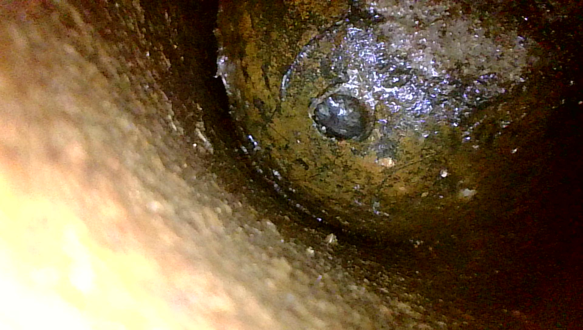

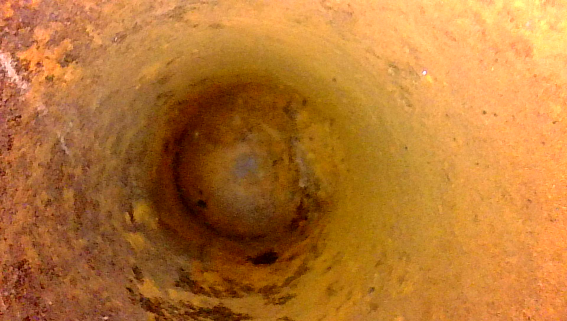

4. Today, ball is stuck with dirt, possibly corrosion? Used to be airtight BUT I'd been spraying it with PB Blaster and forcing air into ignition hole (no breech to access behind ball, muzzle load only)
I'm looking for ideas. I want to preserve the ball that's in there if possible so drilling into it is my last resort. Right now, the ball DID free up but as I was working it, it rolled deeper in and is again stuck. This time, it's NOT airtight so when I pressurize the air behind it, the air simply escapes instead of actually budging the ball.

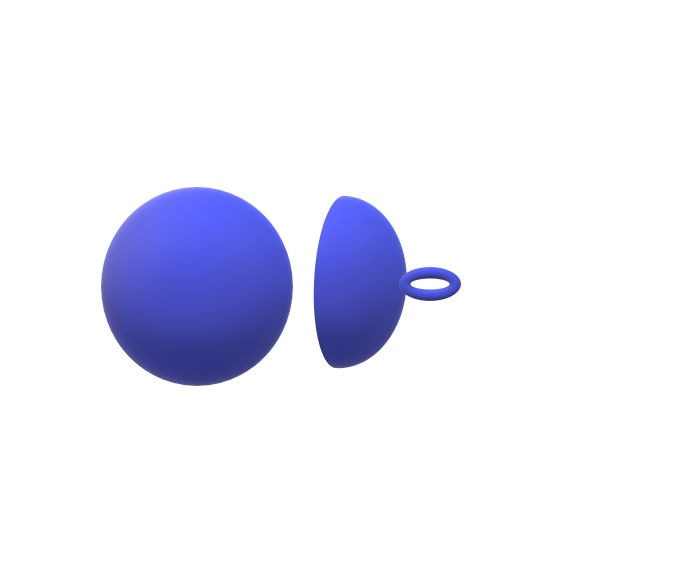

I had an idea (picture below) but glue a "cap" onto it and then have the cap to grab onto and wiggle/pull.
One question I have is, will something like superglue stick to (what I'm told is likely to be) a lead ball?
Then... if yes, what would you make the "cap" from? I have other balls to form it with.

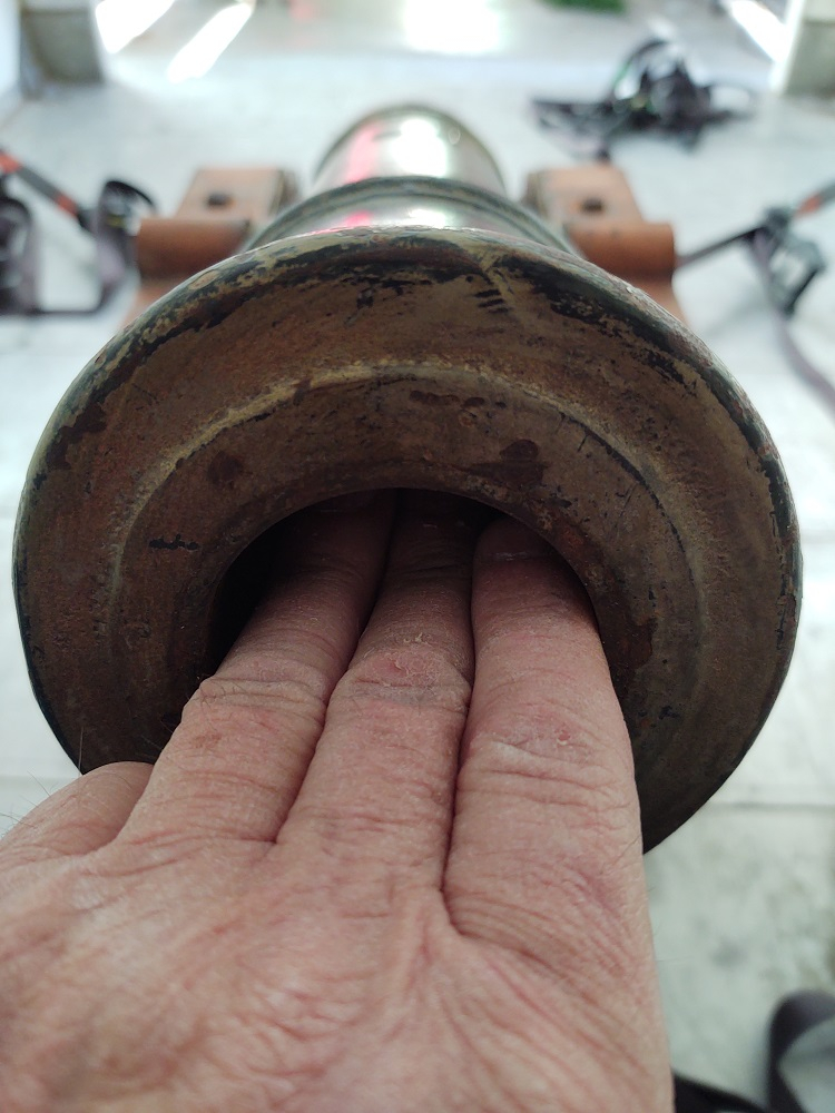

Barrel has pointed in various directions, including down. Ball isn't moving. I've tapped on sides but don't want to hit too hard and dent/mar the outside of barrel. You can see the crud that was in there. Most of that is cleaned out now (at least on the exterior side).

very cool cannon. You could have a machine shop get it out or DIY

If you want to pull it out, you're gonna have to clean the PB blast off the ball. Lacquer thinner will cut it. Then use a stick whittled out for somewhat the curve of the ball. Use NP1 tube caulk and put a glob on there and let it sit 24 hr or more. Forced air into barrel will help it cure. That caulk will stick to glass, so it will stick to the ball. Glass is hard to adhere to, so if it passes the glass test, you're good to go. Also a caulk called SIKAFLEX is available at Home Depot, close to the same caulk. If it smells like chocolate cake mix, you have the right stuff.
Mating surfaces must be clean, not kinda sorta clean, that won't get it. So it's closed breech. I'd make sure ain't no powder in there. But, you have ball movement because there is no wadding, or patch. That cannon ball goes off, I imagine it will make a non repairable hole in you. So be careful.

Can't add to the above good suggestions except that any time spent cleaning the bore is going to have to be done before you shoot it anyway so you may as well do it first. Then you just have to finesse the ball into the clean section rather than fighting it all the way out.

cool cannon

I don't know, but I think super glue would make it worse - just my thought

Looks like some kind of hole in the ball inside the bore posted by the OP. That's what made me ask what this really is.
It should have two holes, each on opposite sides, to indicate it's an iron ball.
