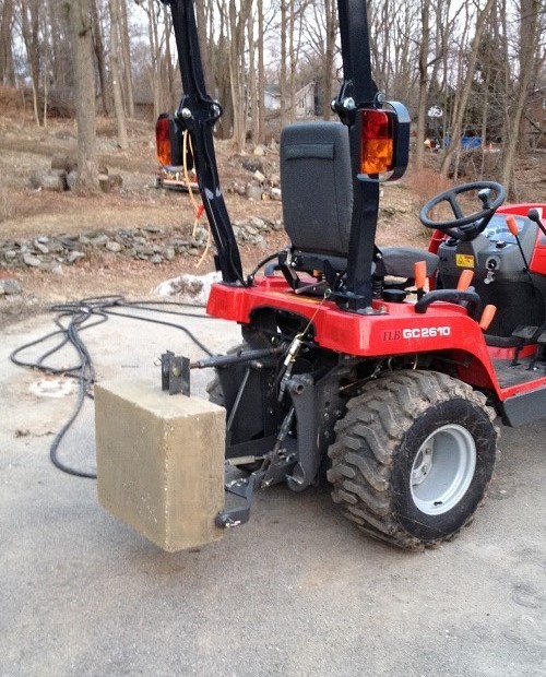

My neighbor has a good sized deer with an FEL. He has been lookng for a rear weight as the 7 foot brush hog is in the way in the woods.
So he built a wooden box, put some 3pt attachments in the right spot, and took it down to the local cement company.
Our cement company, when the truck come back from a run, they pour the excess into a mold that makes massive (3 foot x 5 foot x 3 foot) blocks of concrete that I guess weigh 3000lbs apeices and they sell them for $30. We use them for retaining walls and such.
Anyway, he talked to the owner, the guy said sure, put your box out there and I will call when it is full. I think it ended up being free (but he was acquainted with the concrete company).
he brought the box home, broke the wood crate away and the steel 3pt holders were embeded in the concrete.
Jut an idea....
