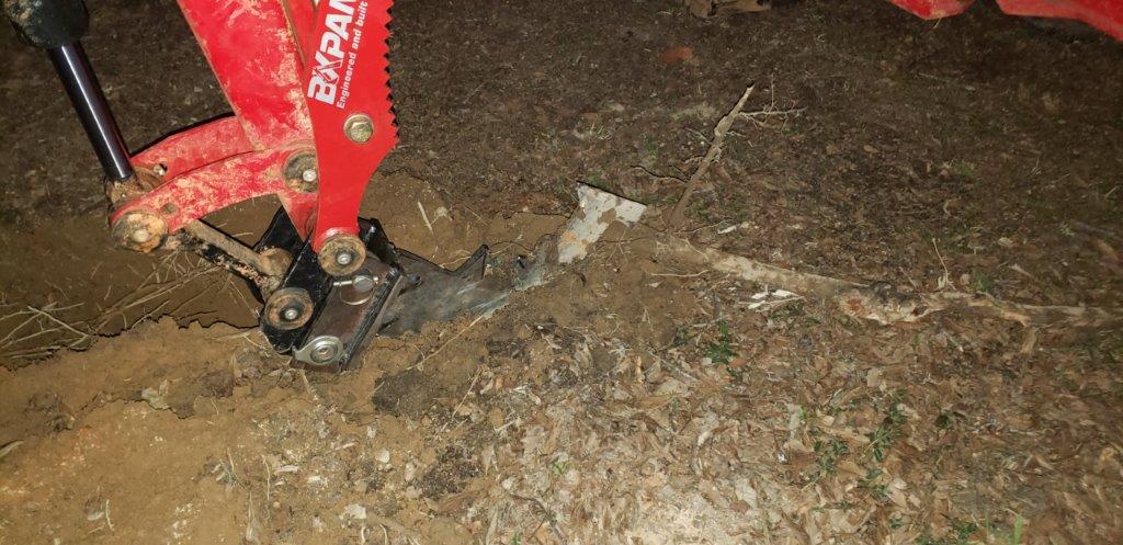

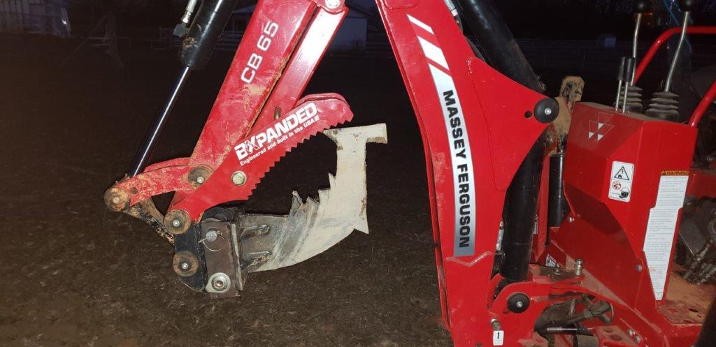

I slayed my first root. It was actually getting dark so I only did a very quick test.
I did dig a few scoops with my backhoe just to test to quick attach. Then I swapped it for the root ripper.
The swap only took a couple minutes.

I really like the idea of hard facing. I read “bluehog” root ripper and that is what he did to his ripper. (He had some cool tools to make his)
I ordered some hardfacing mig welding wire. It seems like a good solution.
I have a Hobart 210 with a spool gun. This 1 pound spool should work good in my welder. I also have a fair amount of fiberglass welding blanket to wrap it up with.
Post a picture of your root ripper.

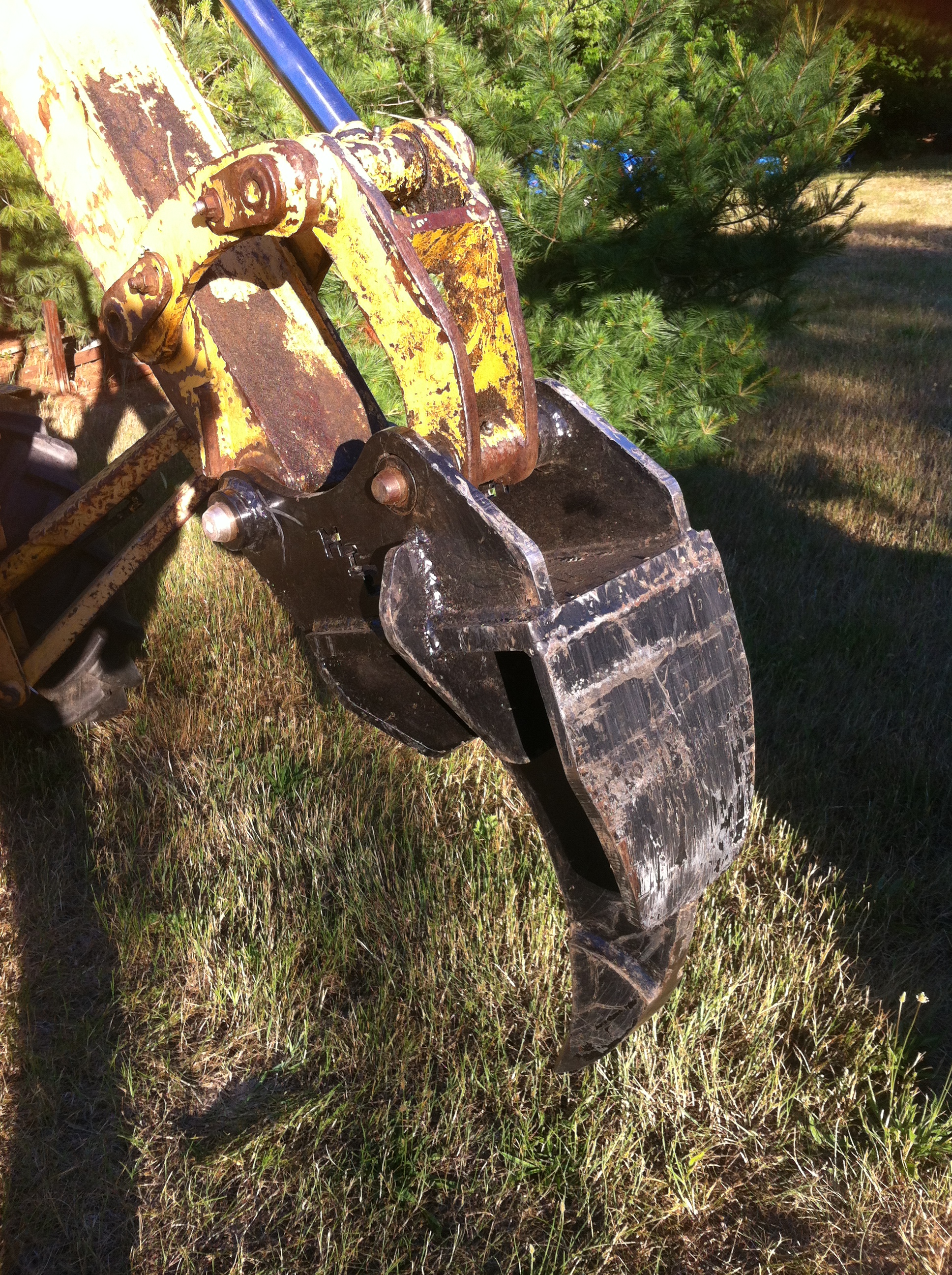

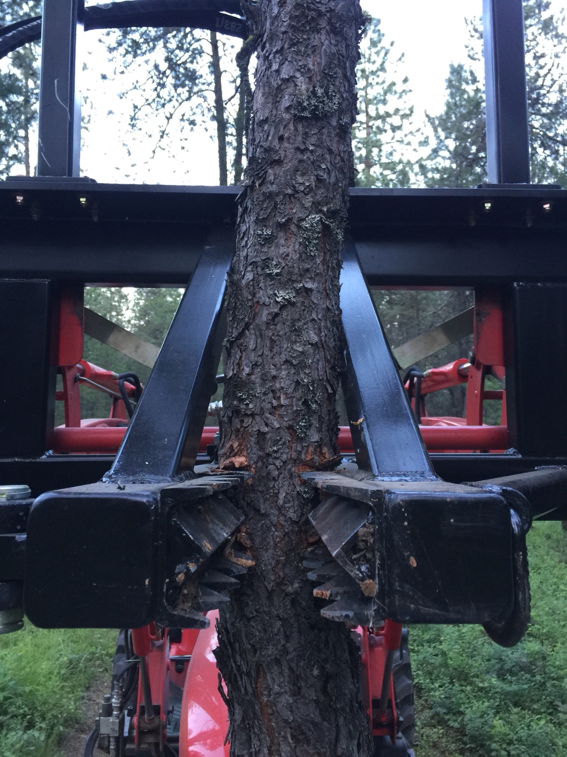

Here's what MICHIGAN IRON AND EQUIPMENT built just for me :)thumbsup:). I say it's 'overbuilt' for my small but strong Terramite, and I couldn't be happier with it! :cool: Of course, being sort of short from pivot to point I can throw myself out of the seat as easily with it as with the std bucket.
If the TM ever getts sold, the ripper will stay and be adapted to its replacement. If you like how it looks, you should see my MIE Hound Dog 48" HD grapple. :)
Here's a 2010 pic of white poplar stumps I dug up in '06 with the OEM 16" bucket, the year I bought the T-M and later retired from GM. They've since rotted and been composted. I was ten pounds lighter then, if you didn't recognize me. :rolleyes:

I just measured 22" from tip to center of pivot, hoping to give you some scale for comparison. I suspect you could move dirt to the sides with your tooth better than I could push or pull with mine. Thinking I'd want it moved to the side when approaching a root perpendicular to it. That squared back is only 8" wide. Y'know, the more I compare our two the more impressed I am with yours, esp that QA bit. :thumbsup:
I doubt that our machines are much different, esp since you have the stronger MF CB 65 BH option. (Compact T5C will drive thru' a 4' wide gate) You have more hp & weight & I a tad more reach/depth, but IMO our machines can't be much different in o'all digging ability. (Case/IH 1.1L DX26 is similar size but lighter, too)
btw, I commend you for a TOPICALLY RELEVANT THREAD TITLE that means folks can actually find it for future reference. (Sure beats something like "Finally started it!" or similar near-miss) Man, have you considered building and selling a few more?? :scratchchin:

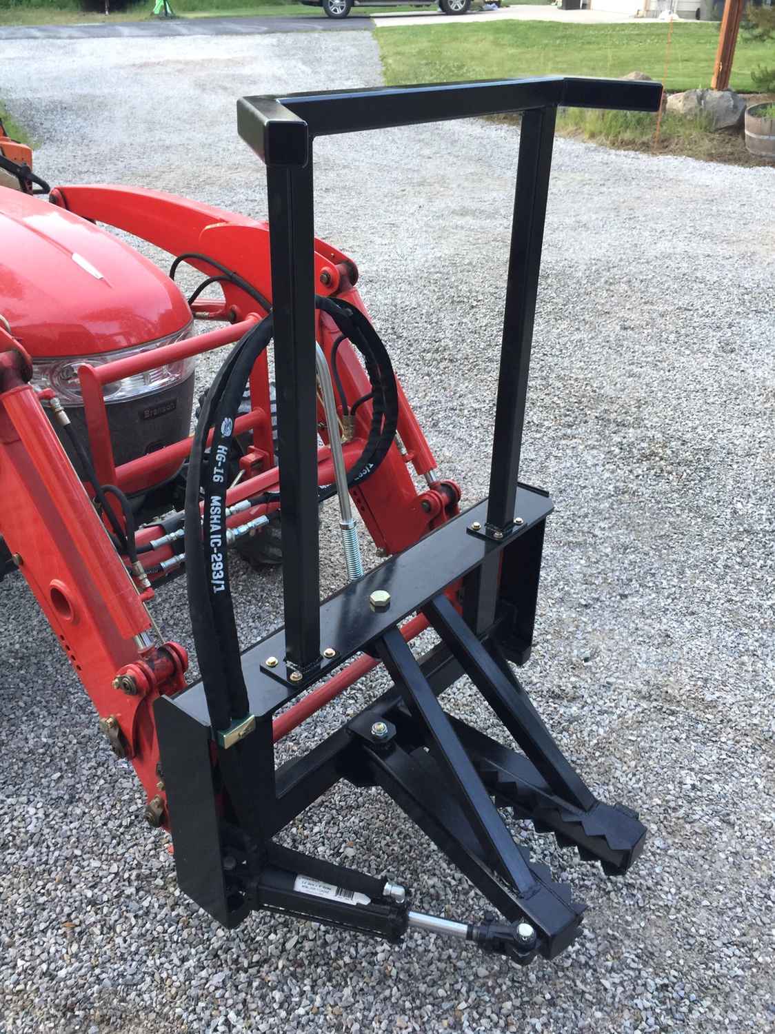

Do you have a post with pictures of your tree puller? I would like to see it very cool. I will have to see if I need to temper the front of the ripper with a torch. I did see couple of others that did not do this they just cleaned it up after every few uses. I thought about welding on the front teeth weld seems very hard.
I saw the SWAG table but I wanted to be able to chop with it also. So far I have used it chopping a little more than standing.
I did chamfer the new pin ends that I made. That really helps a lot.
As you requested...
I was interested in MIE’s ripper and I can see the reason for their design which helps.
I would think that the “domino stack” teeth would clog quickly. I would think that the downforce would be greater and would benefit better than the upforce with regards to cutting. If it slips, it would just go into earth or other roots and wouldn’t buck the tractor if it slips going upwards. Just my thoughts. I would think that the A500 steel should withstand wear. My grapple is made out of it and it’s tough steel.
Love learning from each other!

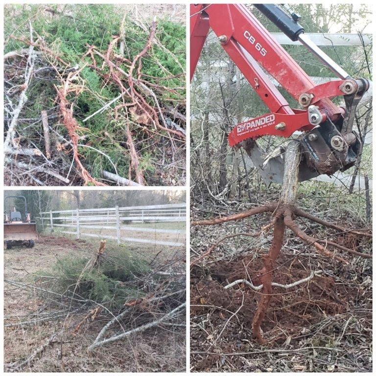

@Aquamoose That is a very nice build. It looks nicer than some of the ones I see company's selling.
I went out and tried it on the fence line. I was not taking out big stuff but it worked great.
Yes I did have a big smile it was fun.:)
I was pleased with it so far. I only took out one stump maybe 5"-6" not real big. No problem at all.
I timed switching from root ripper to bucket it took me one minute to switch.
