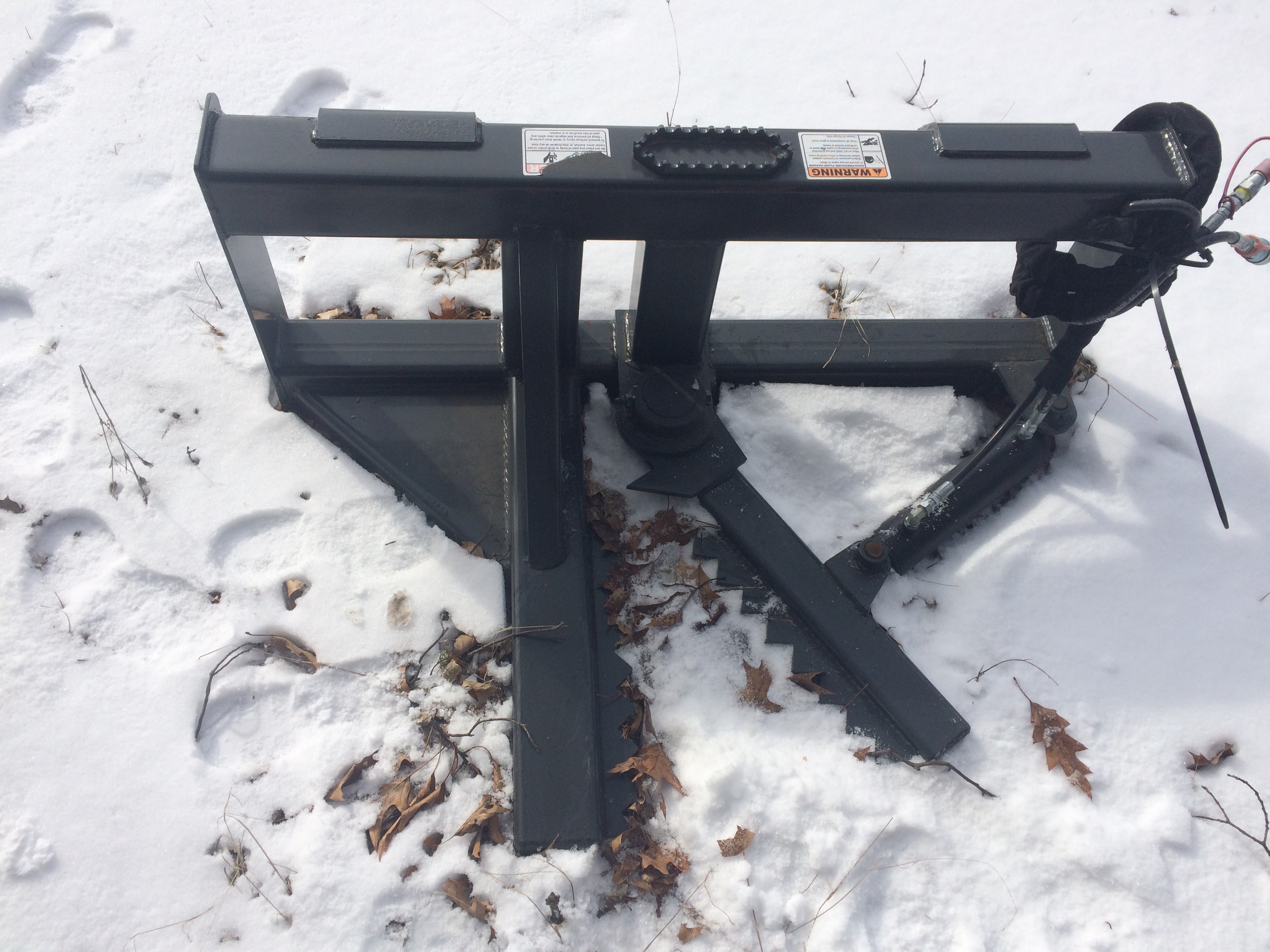

Aquamoose, your puller looks well suited to my puny NH 110 TL FEL (/7108/7308 'on paper'). I especially like your 'brush catcher' since we typically rely on curl to work 'em loose, and stuff tips. D-ring is something to notice, a nice touch.
btw, you have the tractor I 'want' and I have a HD puller that could use your FEL's far greater lift and curl power. Pivot pin & bushing on the moveable jaw are 3" vs smaller ones on taller, braced jaws with a bearing at the top too. Make both easily on the lathe, if ever. Mind you, this was nearly $1400 OTD, and many like it are as much.

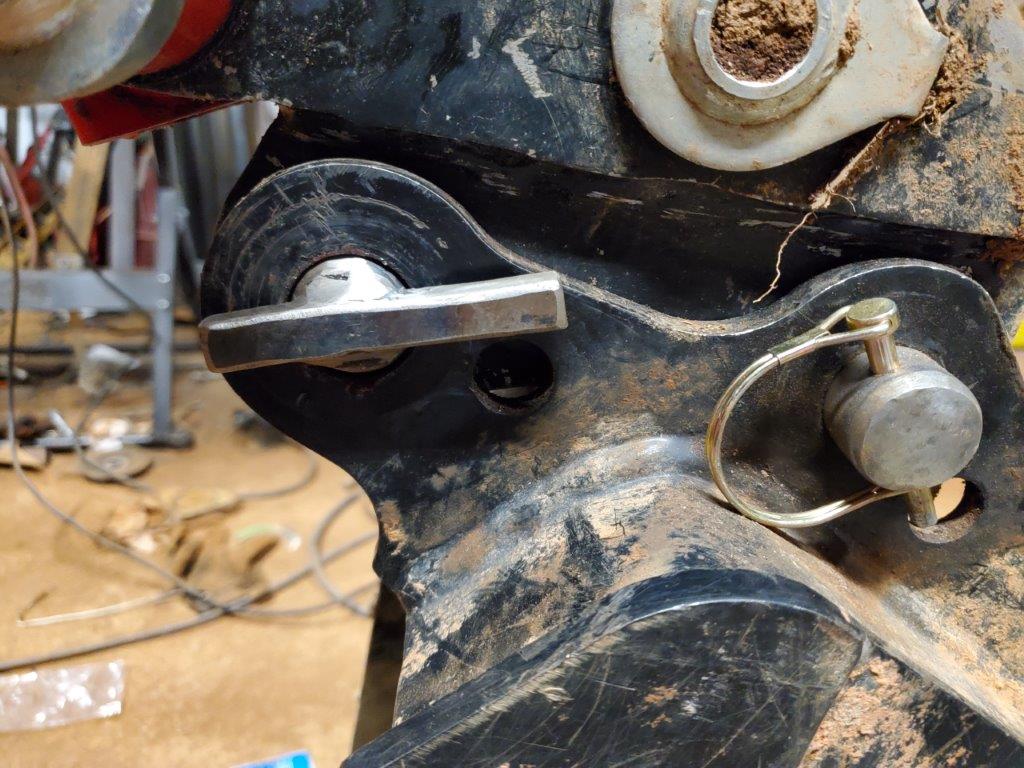

I did a small change on the pin I take out on my QC. I welded a flag on it so you can get ahold of it to pull it out.
I know the pin steel is not good for welding but this is not structural at all.

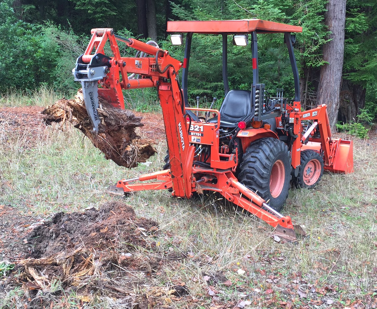

I took it out yesterday and put it to work.
I think I am going to adjust the tip so the thumb will close more so I can get a better grip on smaller stuff.
I have the power to rip out small stuff if I could grip it tighter.
I under estimated how useful the thump would be with this. It is supper useful and with a small change I should be able to make it work better.
