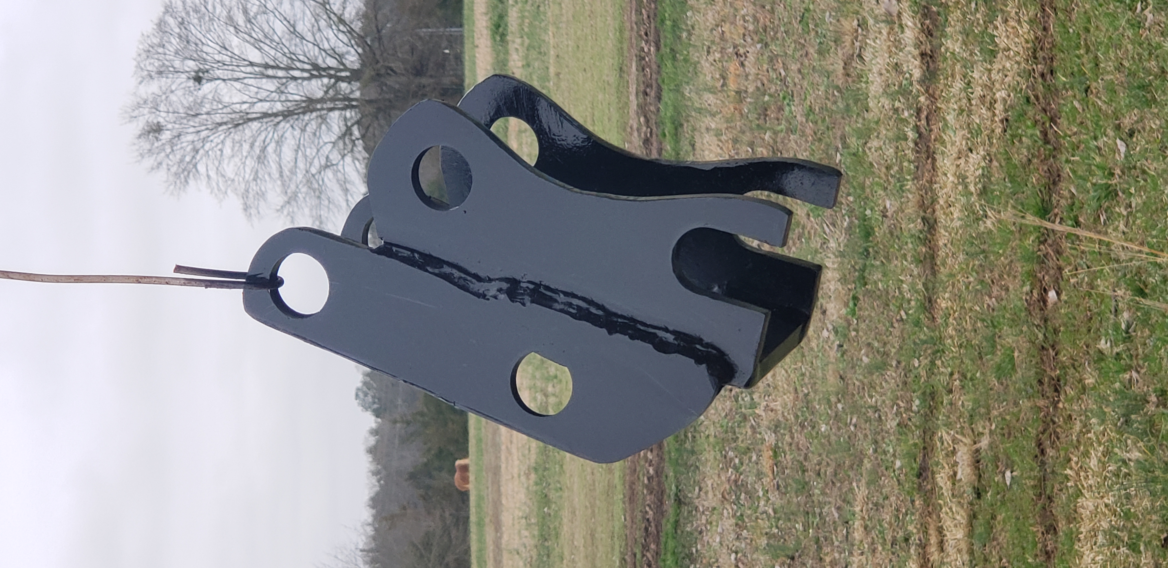

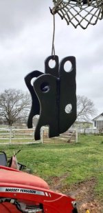

Here are a couple more pictures of my new QC.
I need to clean up my welding/steel and put a coat of paint on it the root ripper.
Once I have some pins, I can try it out the QC and the root ripper.
Next up is making my 16 bucket but that is for another day.
/ I started my backhoe Root Ripper.
#25
Thanks.
There was a lot of work that went into it before I could have it tacked welded together and test it with a bucket to make sure it would work well.
Once I knew it would work, I was all set.
It is loosely based off pictures of the Bxpanded QC the BX backhoe is similar the my GC 1710

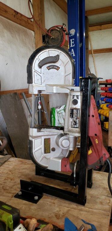

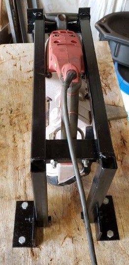

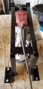

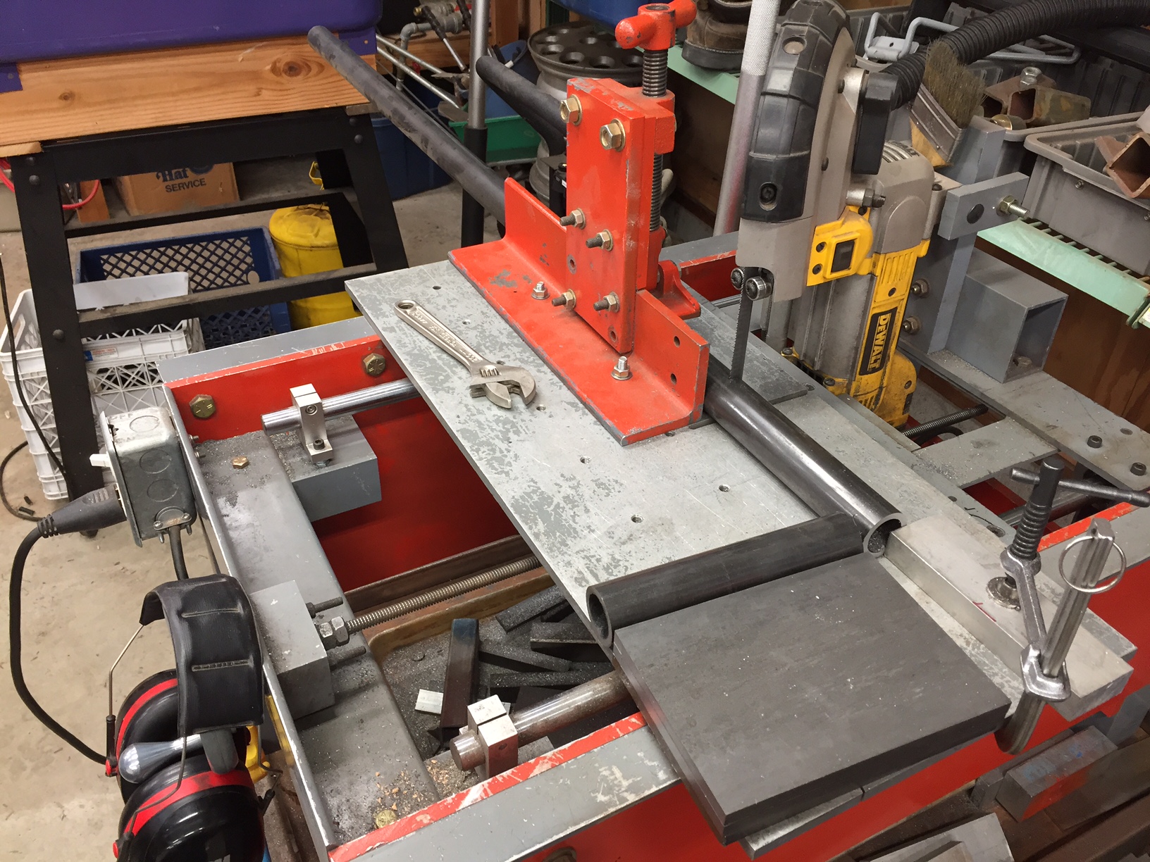

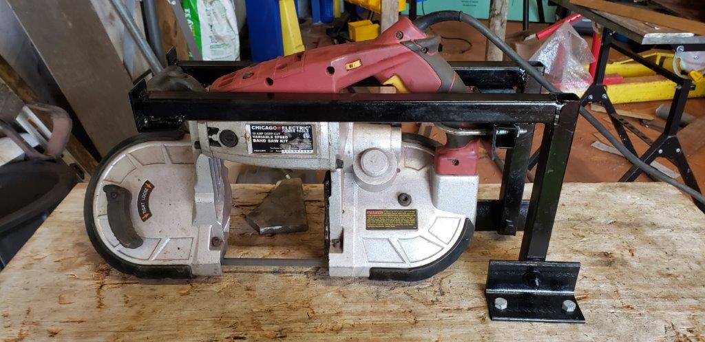

On the topic of getting the most from your hand held bandsaw. I made a table for my DeWalt about 4 years ago. It is very accurate and versatile. I use it weekly. I can't say enough good things about that DeWalt saw. It is flawless after literally years of steady use.
In the photos I am making parts for my new backhoe thumb, 3 pieces of 3/8 x 5 in flat bar, 7-3/32" long. And 2 pieces of tube for temporary spacers, also 7-3/32". Easy peasey.

Wow! Nice bandsaw table.

Wow ! I'm so jealous ! Very clever setup, impressive. Keeping this hacksaw table jig in a corner of my mind, maybe someday ...

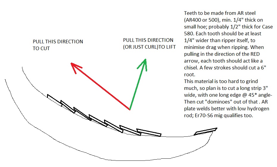

You’re inspiring me to make a ripper. Not there, but closer. My concern is the necessary hardness to withstand wear on the serrated cutting edges.

As for portable band saw setup, I use one from SWAG. It’s a stand that can quickly be detached for mobile use. They have neat stuff.

I saw the SWAG table but I wanted to be able to chop with it also. So far I have used it chopping a little more than standing.

A ripper and thumb are ALMOST visible on my project list; here's a crude paint sketch of my tentative tooth plan, with a smaller than industrial size hoe you'd need to scale it accordingly... Steve

That is funny. I just bought a set of AR500 targets to make a shooting tree. (another welding project) I was wondering if anyone had used some AR500 on their ripper.
Do you know of anyone that has used this design? I would love to know how it performs.

"Do you know of anyone that has used this design? I would love to know how it performs."
Not exactly, just looked at a LOT of rippers - several with teeth, some so aggressive the hoe would probably pull the rest of the tractor over on top of ya :eek:

" I probably could use scrap AR500 for the teeth"
Good luck tryin' to GRIND any of that; I got away with torch cutting on one job replacing wear strips on my 2' hoe bucket (AR400) - about 12 years ago I had the strips plasma cut by steel supplier, then 7018 stitch welds/heat-bend with torch, stitch, repeat... Before I started, I didn't like the edges of the strips. Too sharp and rough, and I didn't think it'd be fun to bump an elbow on the bucket when walking around the tractor, so I grabbed my 9" grinder, clamped 'em in a vise - it took about 30 minutes PER STRIP to put enough of a chamfer on the edges to even NOTICE...
That's why, on that sketch I did I briefly mentioned how I'd do the "dominoes" - first thing would be to set my "flange wizard" to cut @ 45 degrees, and "rip" the long way on a 3" wide strip; THEN I'd cut however many dominoes I needed off that beveled strip, and mount the point of each bevel AWAY from the ripper (see sketch).
Doing it that way would save trying to cut a dozen or so LITTLE pieces at an angle, cause I doubt you're gonna cut that stuff with anything LESS than O/A or plasma, unless you have access to a laser or water jet... Steve
