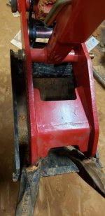

I started my backhoe Root Ripper.
/ I started my backhoe Root Ripper. #41
Sounds like you "got the T-shirt", but no - 33E20, occasionally "loaned out" to other 33 classes - had classrooms close to some 05's tho, can't help thinkin' I'd have been even crazier if I'd ended up there :rolleyes:...Steve
#42

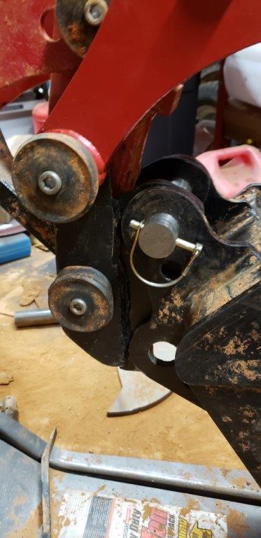

I slayed my first root. It was actually getting dark so I only did a very quick test.
I did dig a few scoops with my backhoe just to test to quick attach. Then I swapped it for the root ripper.
The swap only took a couple minutes.

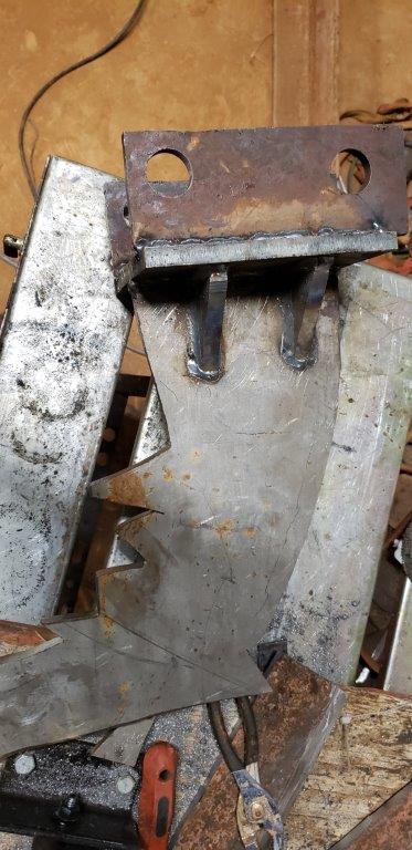

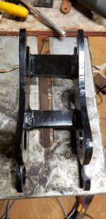

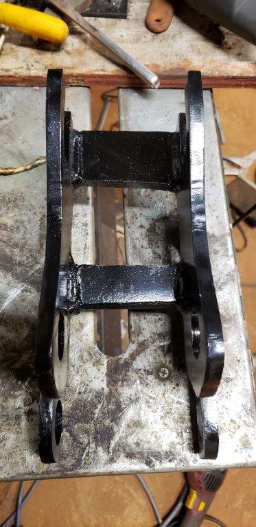

I really like the idea of hard facing. I read “bluehog” root ripper and that is what he did to his ripper. (He had some cool tools to make his)
I ordered some hardfacing mig welding wire. It seems like a good solution.
I have a Hobart 210 with a spool gun. This 1 pound spool should work good in my welder. I also have a fair amount of fiberglass welding blanket to wrap it up with.
Post a picture of your root ripper.

Wow that thing looks strong. My little tractor could never handle that. I have seen a couple of their designs on this site they all look built very strong.
How do you like the steel on the back? It looks like that would help you move some dirt to uncover the root.
I have considered adding that feature to mine. I have some extra ½ and 3/8 plate.
I had bought a harden tooth to go on the end of mine but change the design along the way.
If I don't like my current design I can allays add the tooth to it.
My hardfacing mig wire will be here Friday.

/ I started my backhoe Root Ripper. #48
Do you have a post with pictures of your tree puller? I would like to see it very cool. I will have to see if I need to temper the front of the ripper with a torch. I did see couple of others that did not do this they just cleaned it up after every few uses. I thought about welding on the front teeth weld seems very hard.
I saw the SWAG table but I wanted to be able to chop with it also. So far I have used it chopping a little more than standing.
I did chamfer the new pin ends that I made. That really helps a lot.
As you requested...
I was interested in MIE’s ripper and I can see the reason for their design which helps.
I would think that the “domino stack” teeth would clog quickly. I would think that the downforce would be greater and would benefit better than the upforce with regards to cutting. If it slips, it would just go into earth or other roots and wouldn’t buck the tractor if it slips going upwards. Just my thoughts. I would think that the A500 steel should withstand wear. My grapple is made out of it and it’s tough steel.

"I would think that the domino stack teeth would clog quickly. I would think that the downforce would be greater and would benefit better than the upforce with regards to cutting. If it slips, it would just go into earth or other roots and wouldn稚 buck the tractor if it slips going upwards."
All valid points; I still haven't decided which cut direction my first attempt will be, might be one of those projects that ends up beyond V2.0 :rolleyes:
When I actually get to the build, the "dominoes" will get attached with medium light stitch welds til I try it out on a few 6-8" roots. My initial plan (based on absolutely NOTHING tangible other than gut feel) is to drive down behind (past) the root, crowd up against it, then "saw" BOTH up and down (keeping a bit of crowd pressure on). Thought here is that WHICHEVER way the teeth are done, ONE direction would CUT and the OTHER would (hopefully) CLEAR...
If not, my "fallback" plan involves my PM45 and a scarfing tip, hence the "not too heavy" welds on the dominoes til I know "which way they fall" :D
The ripper will likely get something similar to MIE's back plate, seems like a LOT more force could be applied to a root when using BOTH forces, lift (boom) and pry (curl)

@Aquamoose That is a very nice build. It looks nicer than some of the ones I see company's selling.
I went out and tried it on the fence line. I was not taking out big stuff but it worked great.
Yes I did have a big smile it was fun.:)
I was pleased with it so far. I only took out one stump maybe 5"-6" not real big. No problem at all.
I timed switching from root ripper to bucket it took me one minute to switch.

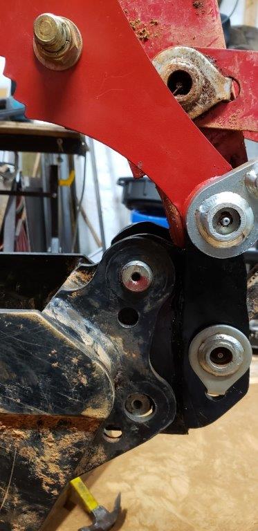

Thanks for the nice remarks. I do hope others will gain from this post. Sharing ideas with people with all different experience it great.
I will have to put the QC through its paces to make sure there are no issues during extended use. If I ever made more I would have them laser cut then make a good jig to weld it.
I would have alpha and bata testers… getting way ahead of myself.
At this point I am just very happy mine it working. My hard-facing mig wire comes in tomorrow.
This weekend I need to get moving on my 16” bucket I will probably start a new post for the bucket. There are some pretty cool bucket builds one here already.

Glad your ripper's working out; and your QA is a DEFINITE winner over the approximate 30 minutes mine takes :thumbdown:
If you have any more pics of that part, please don't be shy :thumbsup:

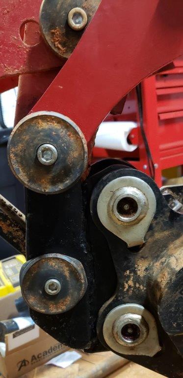

I really had a hard time finding a small roll. I did not need very much and I read it was very soft so I wanted to use my spool gun.
Blue Demon 55FC-O X .035 X 1LB Spool flux core gasless hardfacing welding wire is what I ended up with.
https://www.amazon.com/gp/product/B00G5GI3DO/ref=ppx_yo_dt_b_asin_title_o01_s00?ie=UTF8&psc=1
I was very pleased with the QA. One min to switch between attachments. This is quick enough that you switch to what you need during a job.
I can get more pictures of the QA.
I have a 10" bucket I am making a 16" bucket.
I keep going back and forth if I need another bucket at all. If so what size 12" or 14"
10" should be find for trenching and 16" for digging bigger holes and backfilling where FEL can not get.
Even typing it out I am not sure that a bucket size between 10" and 16" would be useful.
I probably have most what I would need to make another bucket but I would have to but bucket teeth and those are not cheap.

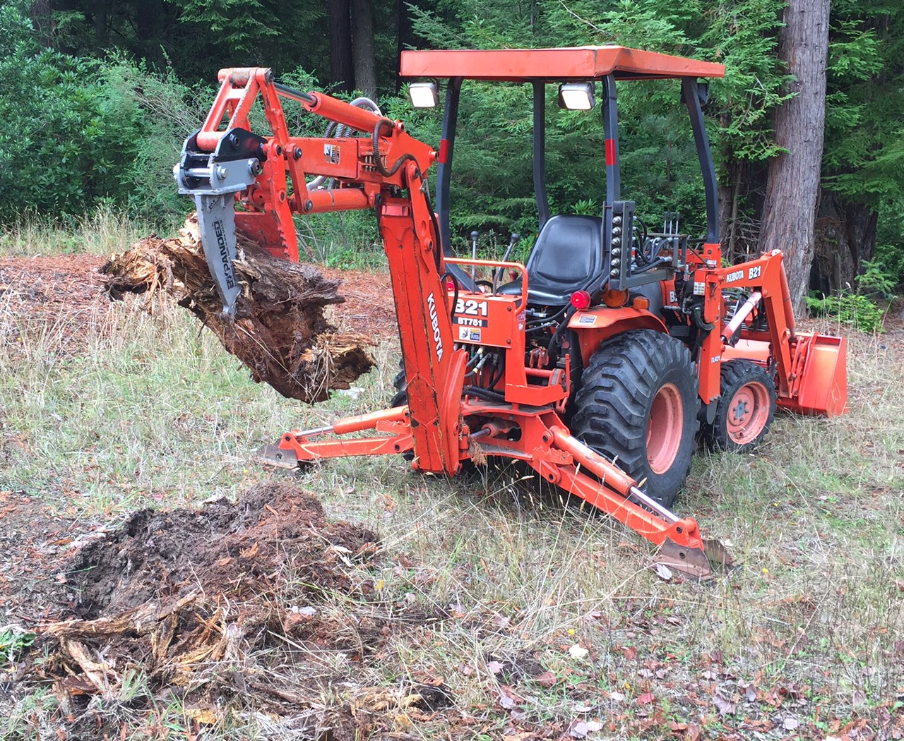

Aquamoose, your puller looks well suited to my puny NH 110 TL FEL (/7108/7308 'on paper'). I especially like your 'brush catcher' since we typically rely on curl to work 'em loose, and stuff tips. D-ring is something to notice, a nice touch.
btw, you have the tractor I 'want' and I have a HD puller that could use your FEL's far greater lift and curl power. Pivot pin & bushing on the moveable jaw are 3" vs smaller ones on taller, braced jaws with a bearing at the top too. Make both easily on the lathe, if ever. Mind you, this was nearly $1400 OTD, and many like it are as much.
Gofast, I like you pics, and now I gotta have a thumb, too. :duh: (aka "surgical grapple"?)

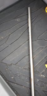

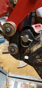

I did a small change on the pin I take out on my QC. I welded a flag on it so you can get ahold of it to pull it out.
I know the pin steel is not good for welding but this is not structural at all.

I took it out yesterday and put it to work.
I think I am going to adjust the tip so the thumb will close more so I can get a better grip on smaller stuff.
I have the power to rip out small stuff if I could grip it tighter.
I under estimated how useful the thump would be with this. It is supper useful and with a small change I should be able to make it work better.
