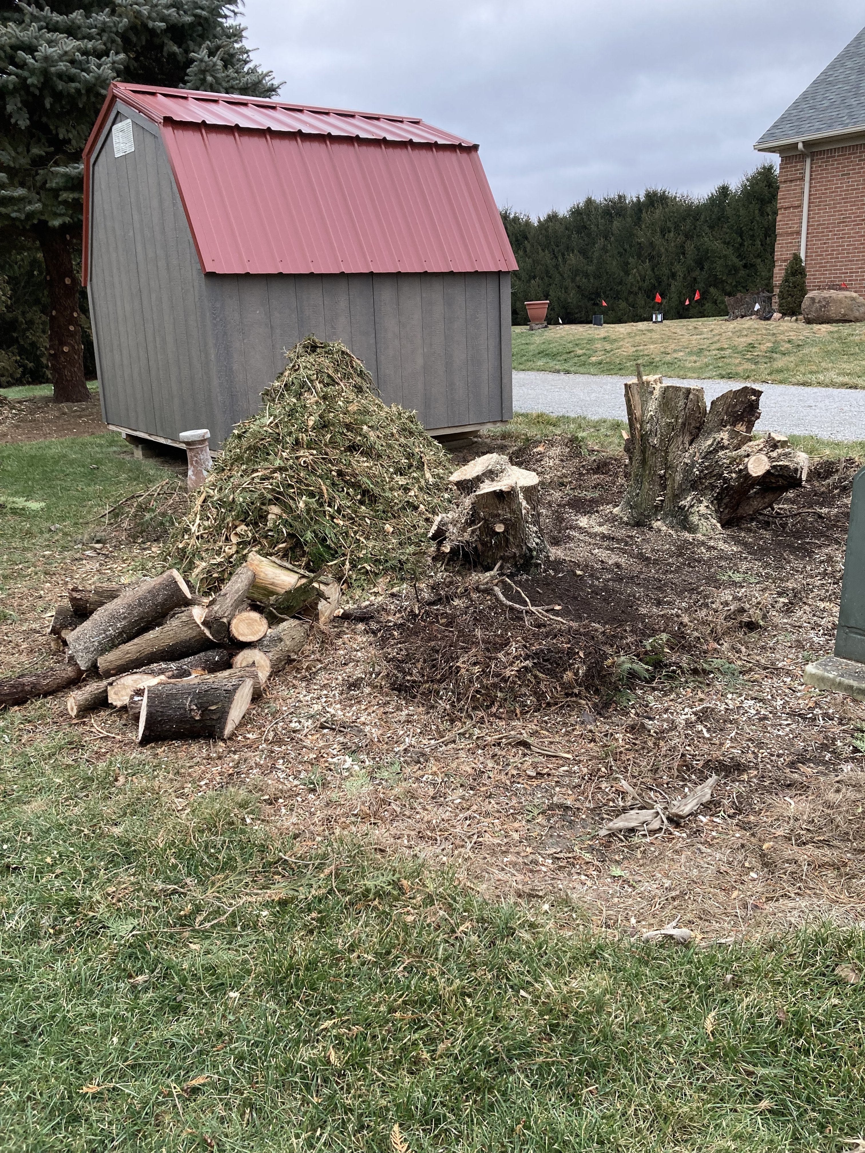

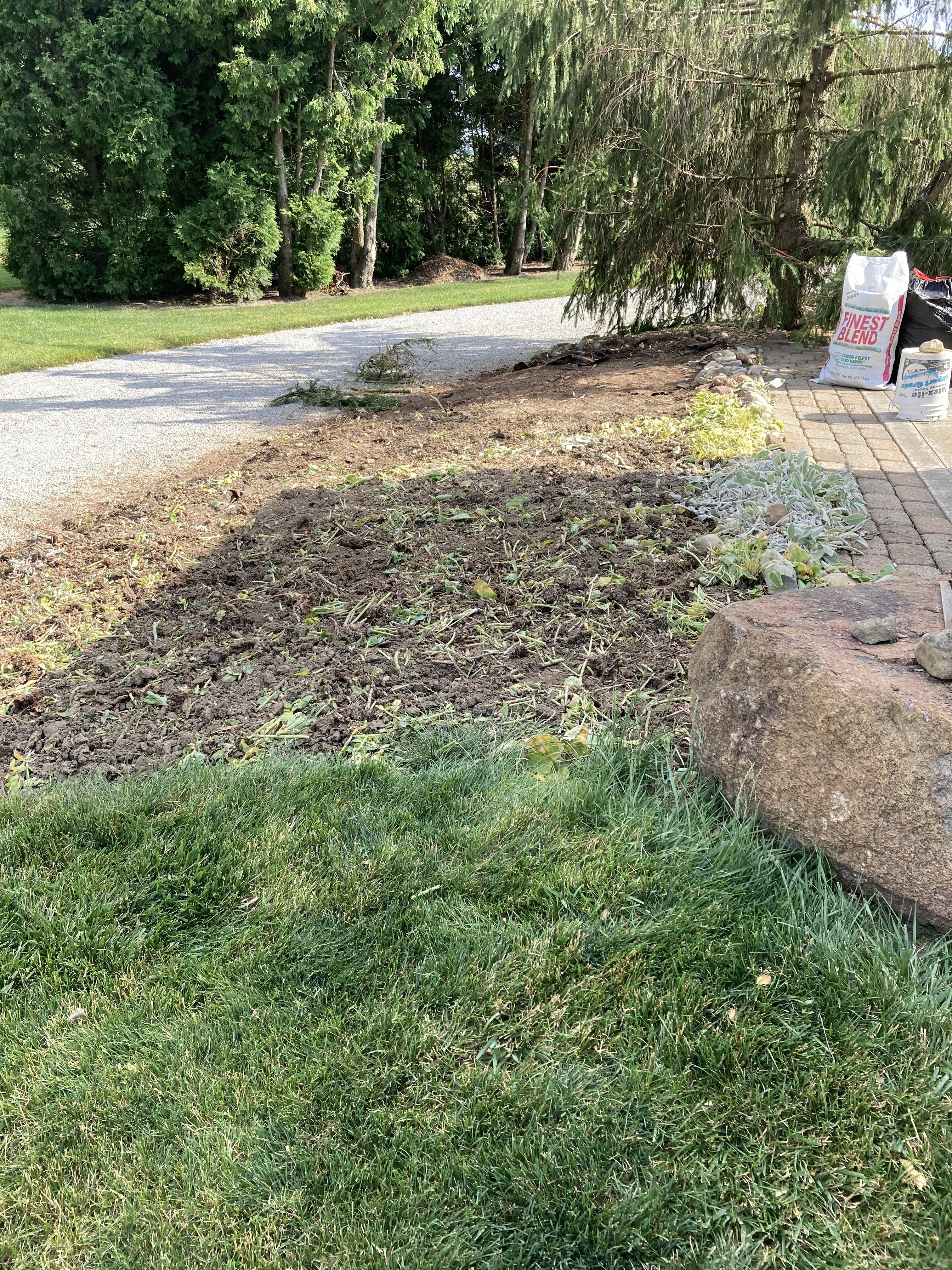

I have a (Land Pride) stump grinder and run it on my MX5100. It's an amazing piece of equipment, runs smooth and vibration is no big deal. You adjust the pressure flow on the machine to equalize flow so it grinds smooth and it's as easy as pie. Plus, after you get in position to grind, the unit drops to the ground and stabilizes things. You don't grind big chunks but nibble the amount you're comfortable with.
I bought this because I have a lot of stumps to grind at varying times over the months and years and it was my best option. Burning stumps was a time consuming hassle and a backhoe made a mess and left both a stump and a hole.
Renting a stump grinder is great but rental was just under $300 a day, I would need to go get, take back and rent multiple times. Plus deal with the process. By buying, I could get payback pretty quick and then have the residual value to sell later.
It's worked great and I think I've posted a pic of the grinder before. Maybe not. Plus, I could easily turn this into an income stream but I'm slowing down. There are many stumps around and people don't know what to do. :unsure:
This is where two 35' Norway Spruce were. But not now. There were lots of nasty roots so I just flipped dirt where I could with a shovel, smoothed it and left it alone. Seeded, watered and grass. My wife wanted one stump left for a flower pot.

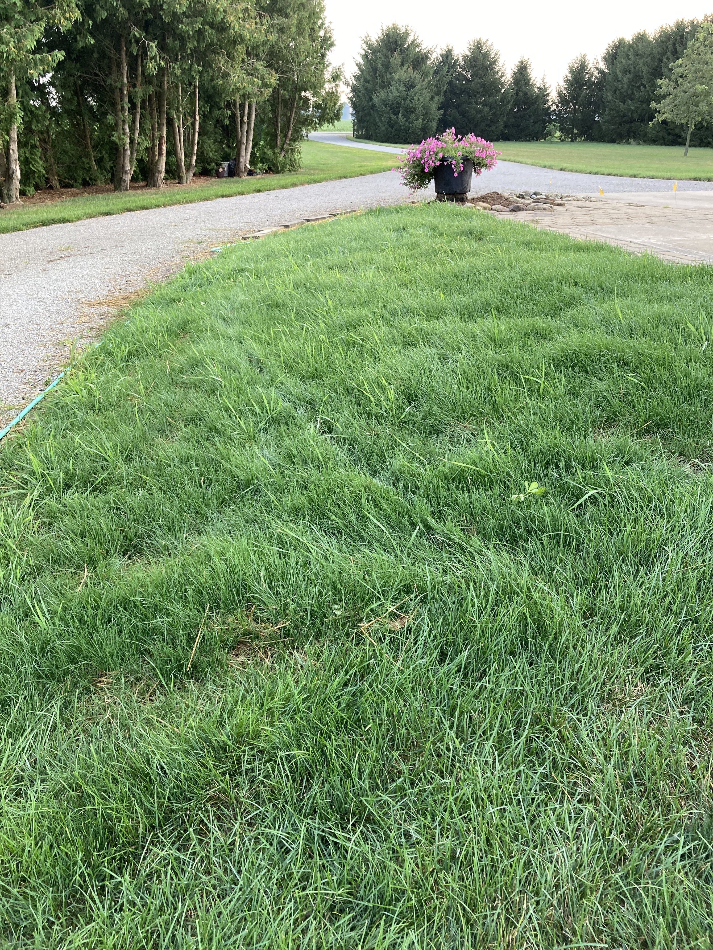

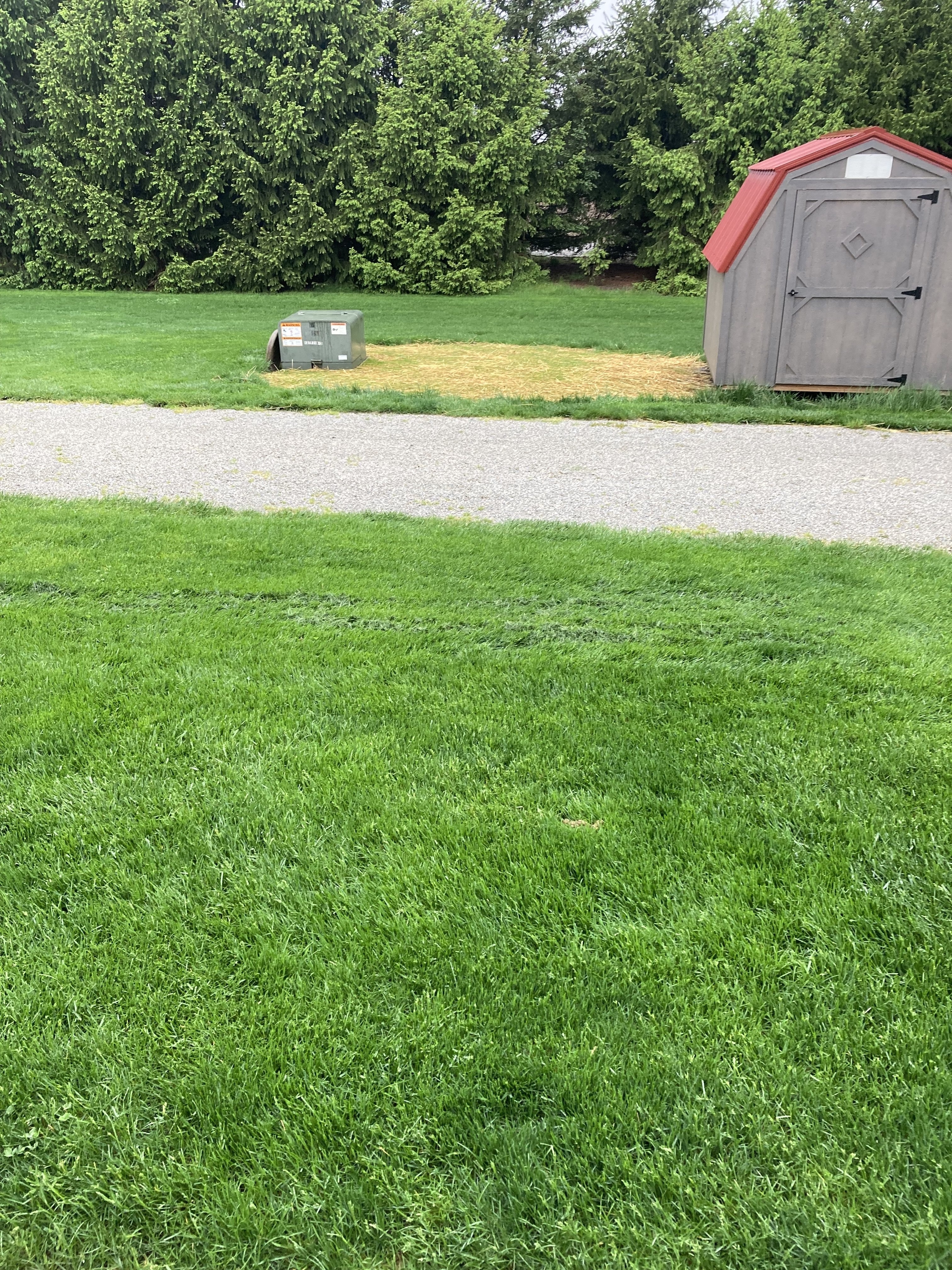

This is where there were two 30'-35' American Arborvitae--Northern White Cedar. 30 minutes to grind these.
Also. you've got to be careful with sub-surface wires and call the I-800 DIG number so they can mark stuff. Old timers randomly ran farm wire a few inches under the ground so watch out.

Looking at the last two photos, I was just thinking it was a brave of you to stump grind adjacent to a transformer pad! I'm glad that you had a call out to 811 to along with the photos.
Thanks for the post and photos!
All the best,
Peter
I was there when the line was originally put in and made sure I saw the ditch and the cable in place. I wanted 36" in down and it was.
The 1-811 dig guy sprayed and checked at 37 1/2" deep but the tree was right over the line. I ground a couple inches below grade and called it good. Grass will grow enough and few will ever know.
