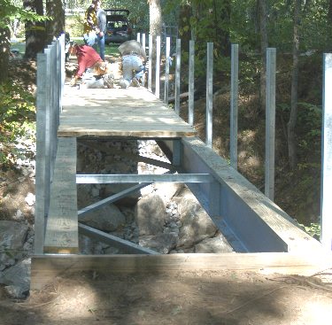

Even if he uses 20' steel beams the W8x24's weigh 35 or 36 pounds per foot. Getting a 700# beam into a precise final position is not my idea of a fun day.
After all this discussion, the idea of a wooden footbridge maybe 4' wide for people, at the top of the dam, and then a way to drive the tractor across the spillway a lot closer to the base of the dam is sounding a lot more desireable. And a lot more cost-effective.

W8x24s weigh 24 lbs. per foot - the designation means 8" deep (tall) and 24 plf.
This bridge can certainly be designed as wood, steel, or precast concrete. Which is more economical depends on local suppliers and the labor involved.

For a foot bridge four feet wide, I think that PT 2x12's on sixteen inch centers with 2x8 or 2x10 decking with blocking at three points will be plenty strong enough for a ten foot span.

I bought a piece of flat stock today from the steel supplier and asked what I beams cost. He had these in stock.
8 inch 18 lps per foot at 20 feet is $168 each
8 inch 31 lbs per foot at 20 feet is $298 each
I don't know what I was expecting, but that's allot cheaper than I was expecting.
Next I'm gonna have to find out what PT 2x12's are going for and do a little math.

I went by the lumber yard today.
PT 2x12 that are 20 feet long are $36.89
I'd need more of them, but the price difference and ease of use sure points to using four of these for a foot bridge on 12 inch centers with a support in the middle.
Any thoughts?
Thanks,
Eddie
/ I Beam help needed #79
I would suggest comparing the 2x12x20 with some 2x12x10. I'm guessing the price/ft is the same, but my experience has been that the longer the board, the more crooked, warped, knotty, etc. Would it be about the same work to make 2 10' bridges vs. 1 20' bridge?

The ten footers were actually a little cheaper per foot.
PT 2x12X10 were $16 each.
Not allot, but I was both comparing them in price to the 20 foot I-beams and I thought they would be stronger over the full run. I hadn't thought about straightness on them and I've never used 20 footers before.
