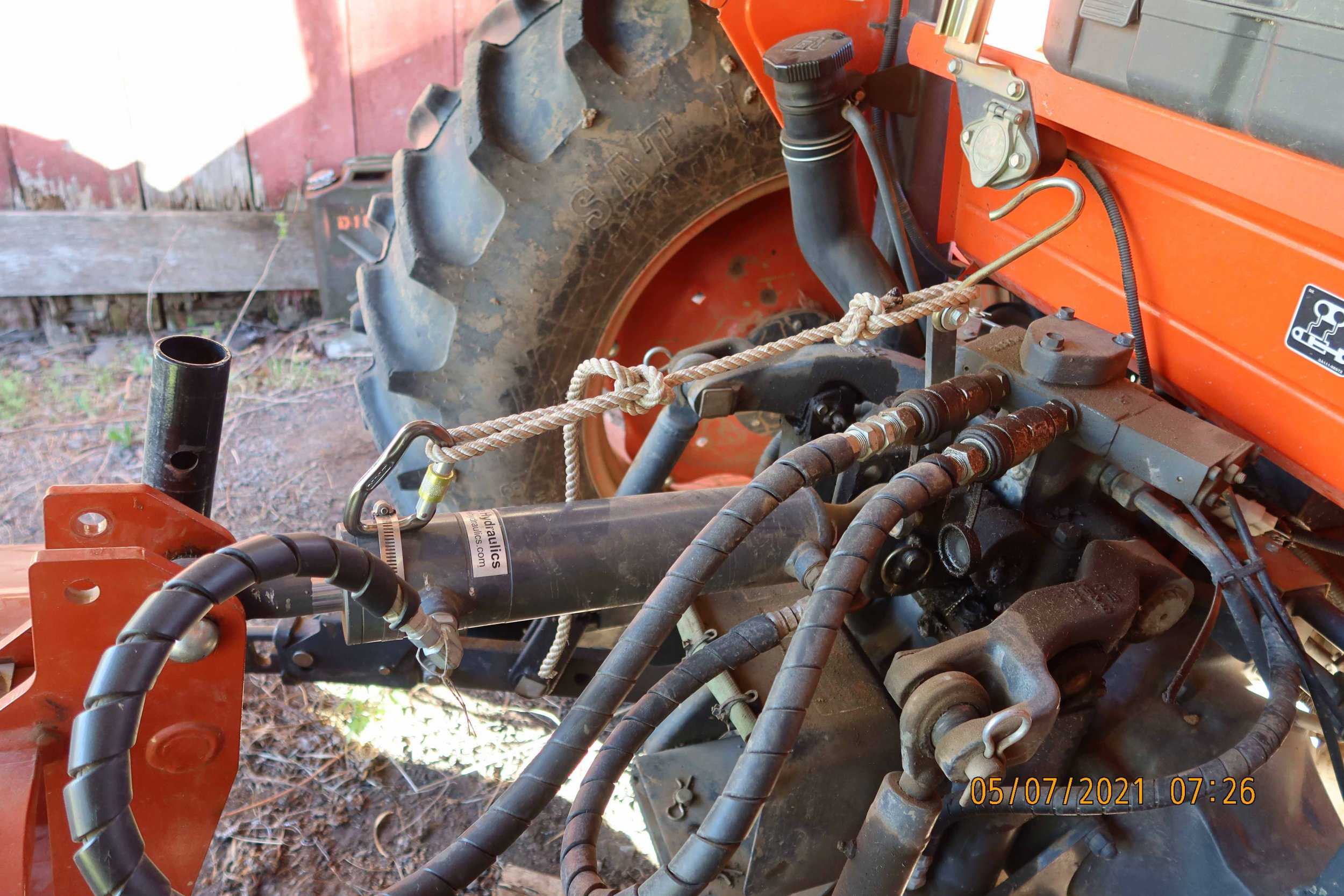

Here is a triple diverter. This tractor has a single factory rear remote. (Only 1 rear remote is available from the factory)
4 sets were needed to control all the different hydraulic functions,T&T and offset & angle on rear blade & rake.
If a person goes with a control grip with all the controls in a single point, it is actually more convenient than having 4 separate levers to operate. All 4 functions can be operated and never removing your hand from the main control lever. :cool:
There are some companies that only offer the separate rocker switches to control the different valves, but even that can be a good alternative. (y)
