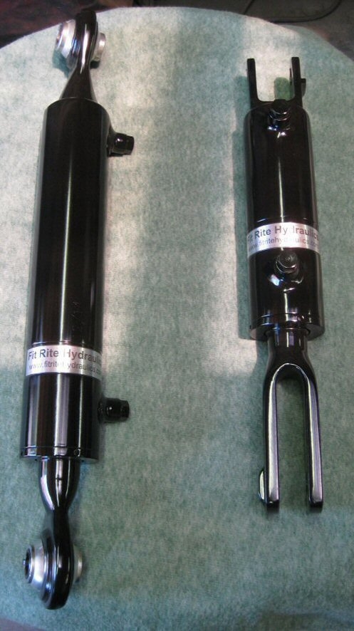

Fair enough. I would recommend checking out Fit Rite next time. Small operation run by one of our own. Custom made to your specs.
I have no affiliation other than the owner posts good stuff on here and deserves our support.
Well heck you aren't that far from me. I'm just south of Ben Wheeler.
