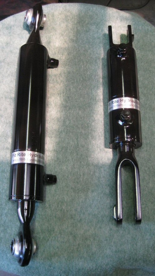

Definitely a factor in choosing my T574. It's open station, but has the control lever, too. Supposedly, you can add them easily.
I'm probably going to need to spend more on mine as I need at least 2.5" cylinders.
   / I just ordered out a 2nd VEVOR hydraulic top link #26
Something similar to these pictured.
If you need more outlets, I can provide poppet type diverters that DO NOT leak down.
I've got 2 sets. I don't need more for the box blade.
