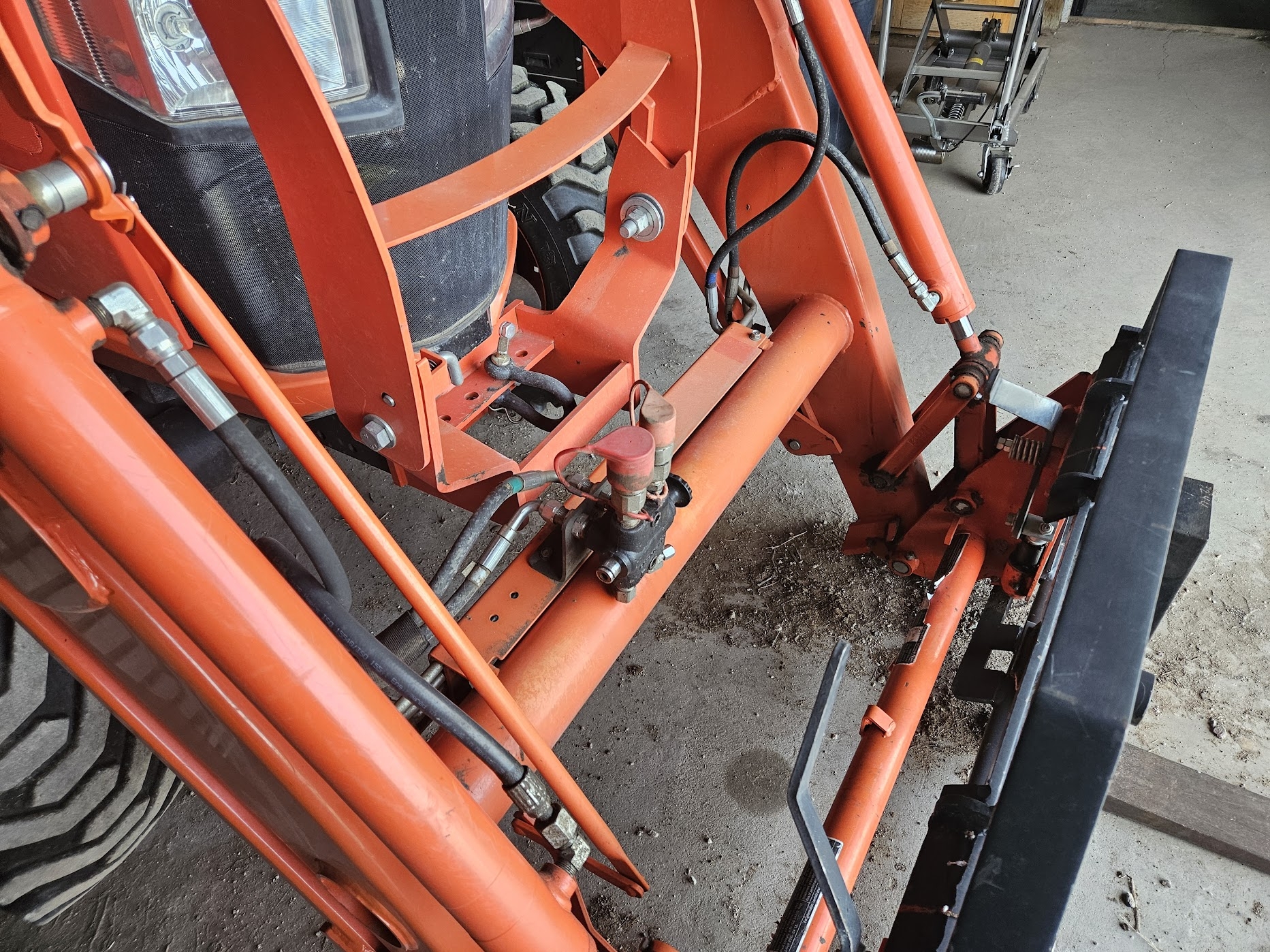

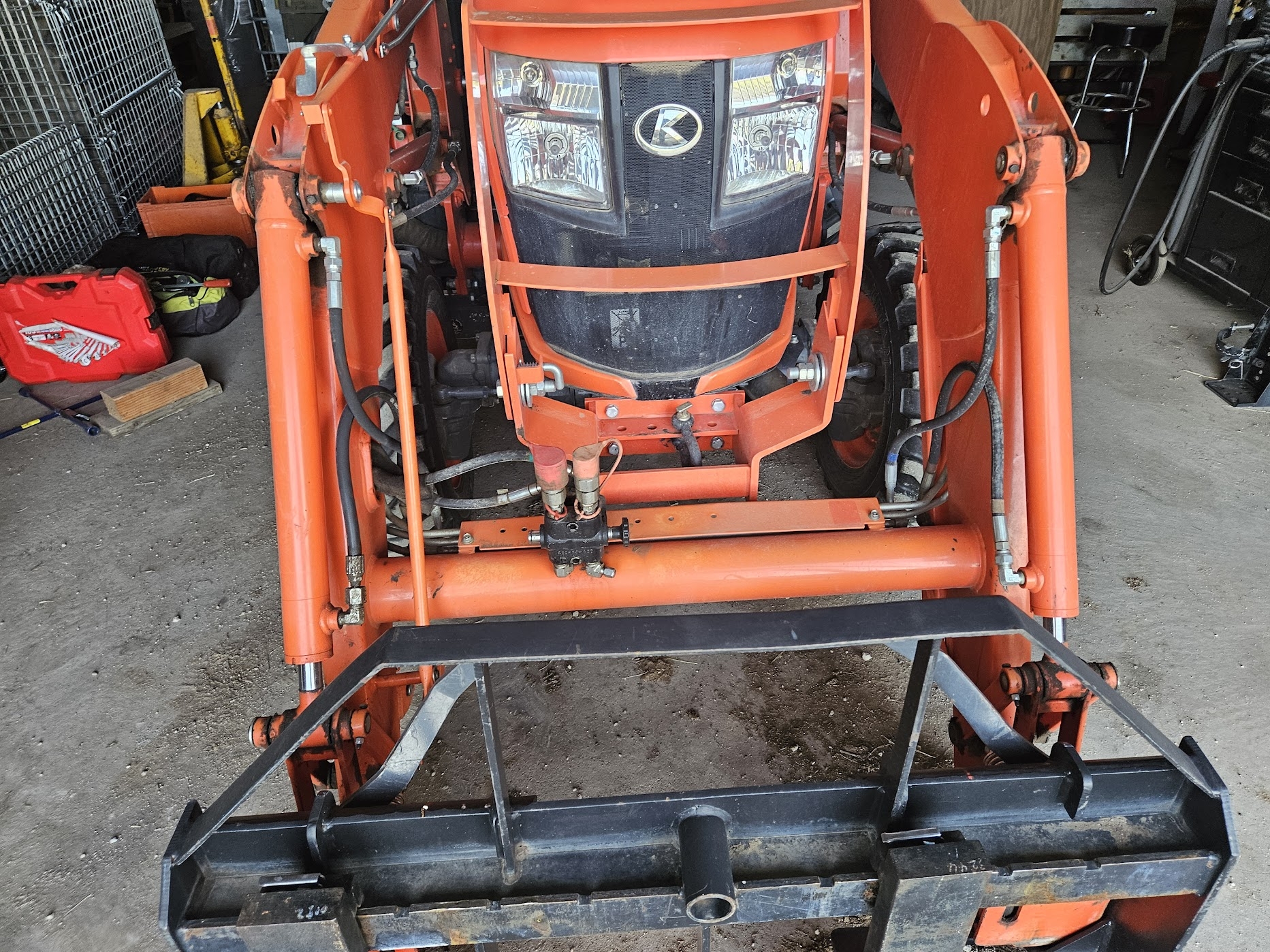

I put an electric one on my previous tractor. Linear actuator for power SSQA?. I have picked up a manual diverter & small cylinder to do it hydraulically on my new (well, now at 1,000 hours) L4060. I installed the manual diverter on the boom on the 3rd function. But I have never gotten around to mounting up the cylinder & making hoses. Really should finish that project one of these days
By reusing the 3rd function I'll save some cost & plumbing. Just leave the diverter set to the power SSQA. If you ever need to hook up a hydraulic implement, hitch up first. Then get off the machine to hook up hoses & then hit the diverter at after the hoses. Reverse order to unhitch. Remove hoses, flip diverter & you are back to power SSQA. No need to run a whole separate circuit for just the SSQA & you have to get on or off the machine to deal with hoses for hydraulic implements anyway.
