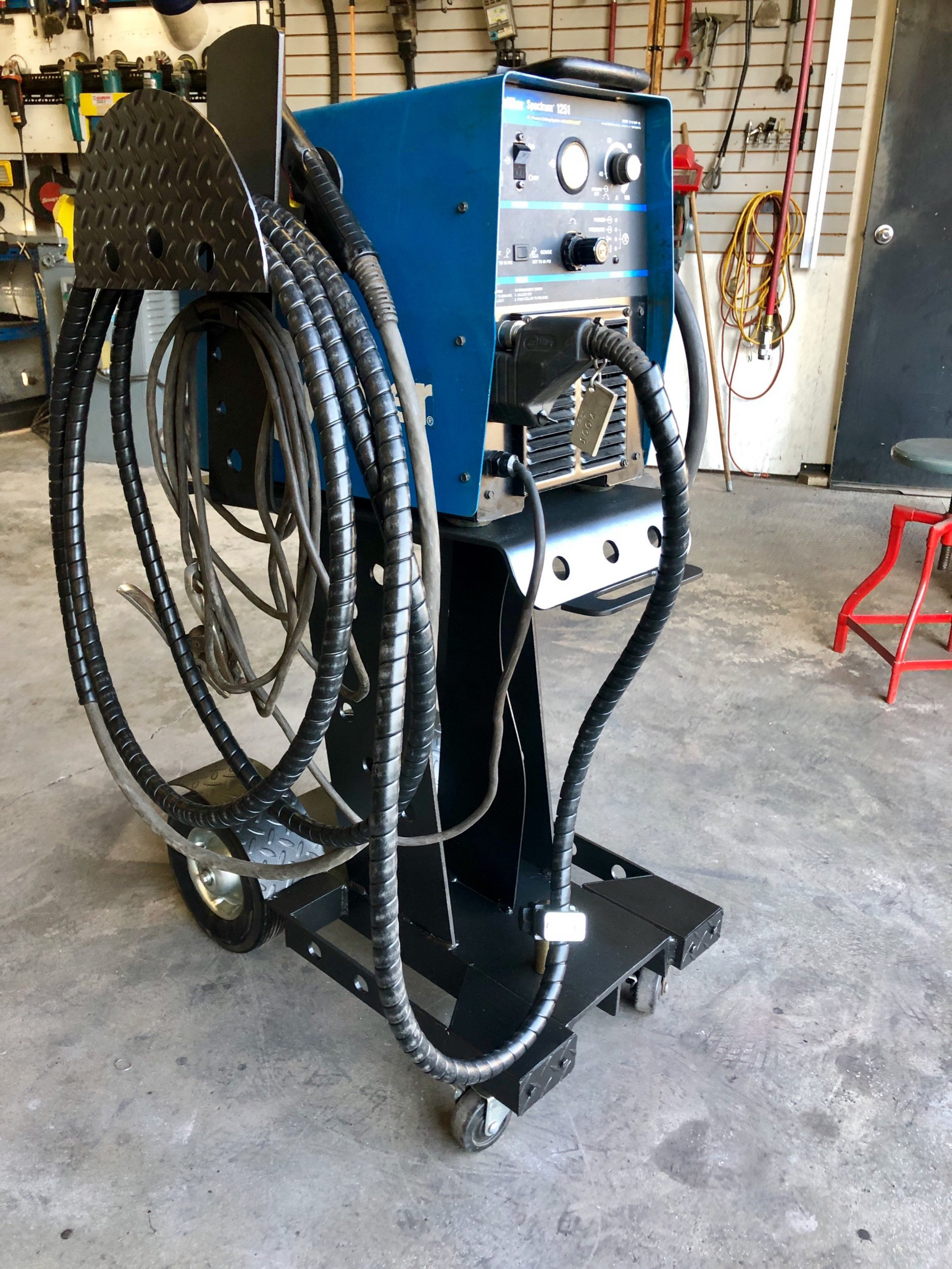

I got a roll of 1" black nylon hose protector on Amazon:
The trick - for me at any rate - is to have is to have a roll of it on hand. You can buy it OEM on some hoses - for about 4x the cost.
Electriduct 1" Nylon Protective Hose Sleeve - 25 Feet - Black - $30.00
Then whether I use OEM or have replacement hoses made locally, I simply slip a length of this nylon over the hose and zip tie it to the metal ends before reinstalling. It makes hoses last twice as long.The trick - for me at any rate - is to have is to have a roll of it on hand. You can buy it OEM on some hoses - for about 4x the cost.
