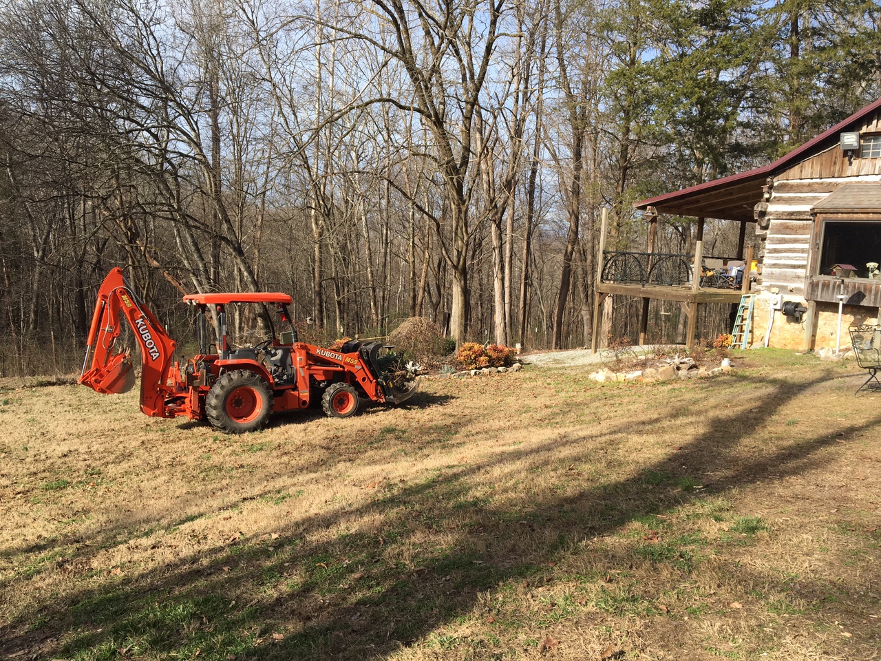

Taking the Christmas tree to the fish pond.

Is that M59 really beefy enough to haul away that massive Christmas tree?
/ Nylon Protective Hose Sleeve #11
Having fun:). Road to pond is rough, steep in spots and often a tree across the path.
