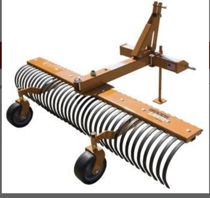

I got my bush hog 7ft landscape rake for $200 from a neighbor. When he asked if I wanted the rake for that amount I almost broke a finger trying to get the money out of my pocket fast enough. One of the best tools I got. Right now I'm trying my darndest to build a set of gauge wheels for it. I'm picking rocks off the property and maintaining the gravel road with it. And I have the 3 way gannon also
   / How to use a Grader Scraper #56
scootr, Please detail your gauge wheel build as you progress. I will follow "eagerly". I've got a woods 60" rake and I sure wish I had gauge wheels for it!! Would love to have some ideas on how to build a set. Thanks, Greg
