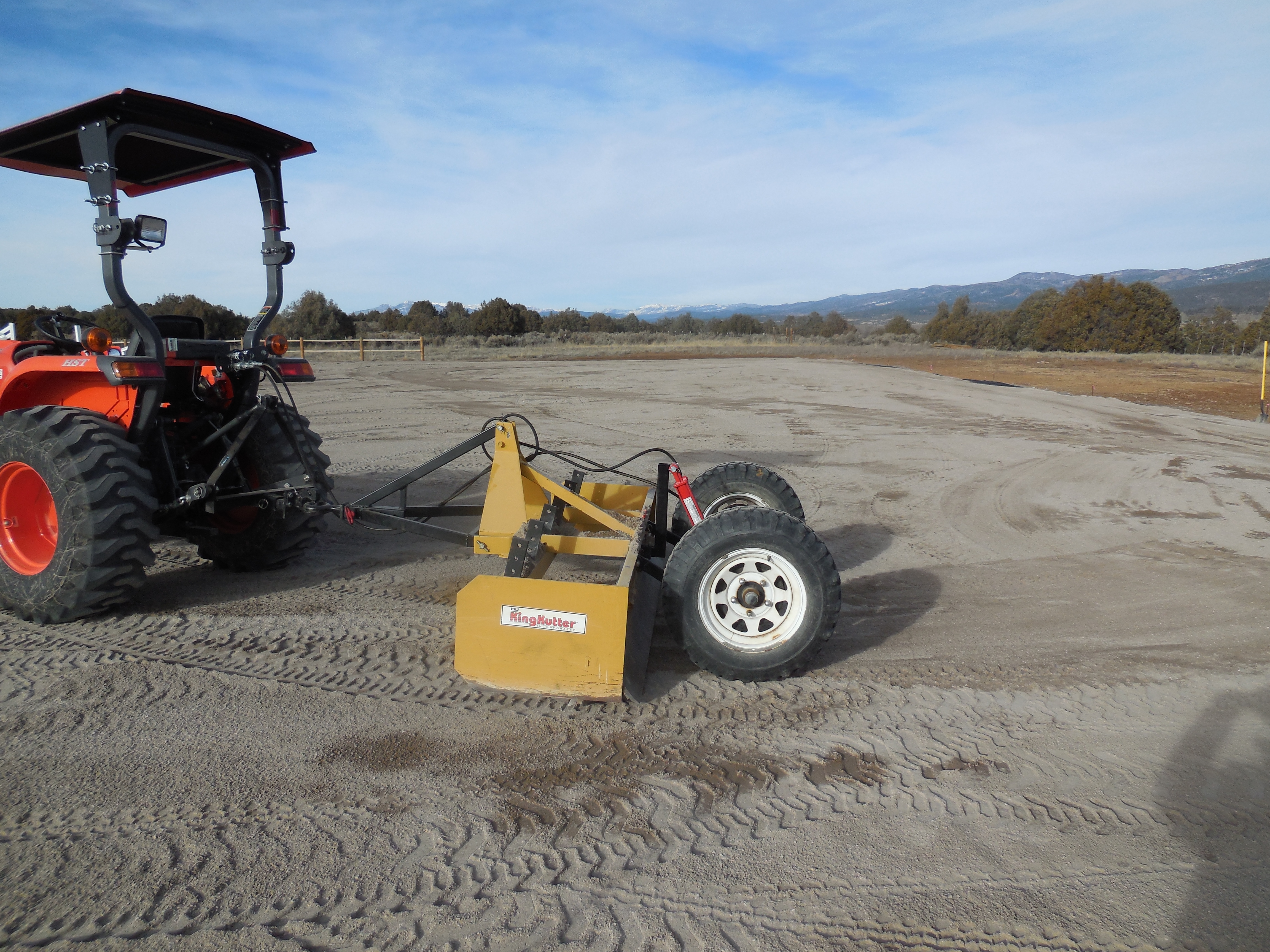

When creating my first towable I expected to set the height with the hydraulics for the axle behind the blade.
Wrong. That's more of a rough setting, then the height can be fine tuned to perfection with the pintle hook on the 3-point.
It worked so well that I started to use an extension, about 60 inches long, since the longer the distance from the tractor's axle to the cutting blade, the better the precision.
Since that way even a 1-foot hump has very little effect on the blade, and the wheels behind rides on a now smoothed surface, it's rare that I need to make a second pass.
After all, there's a reason road graders have a long distance between the front axle and the blade. Oh, and large and/or wide tires also help quite a bit.

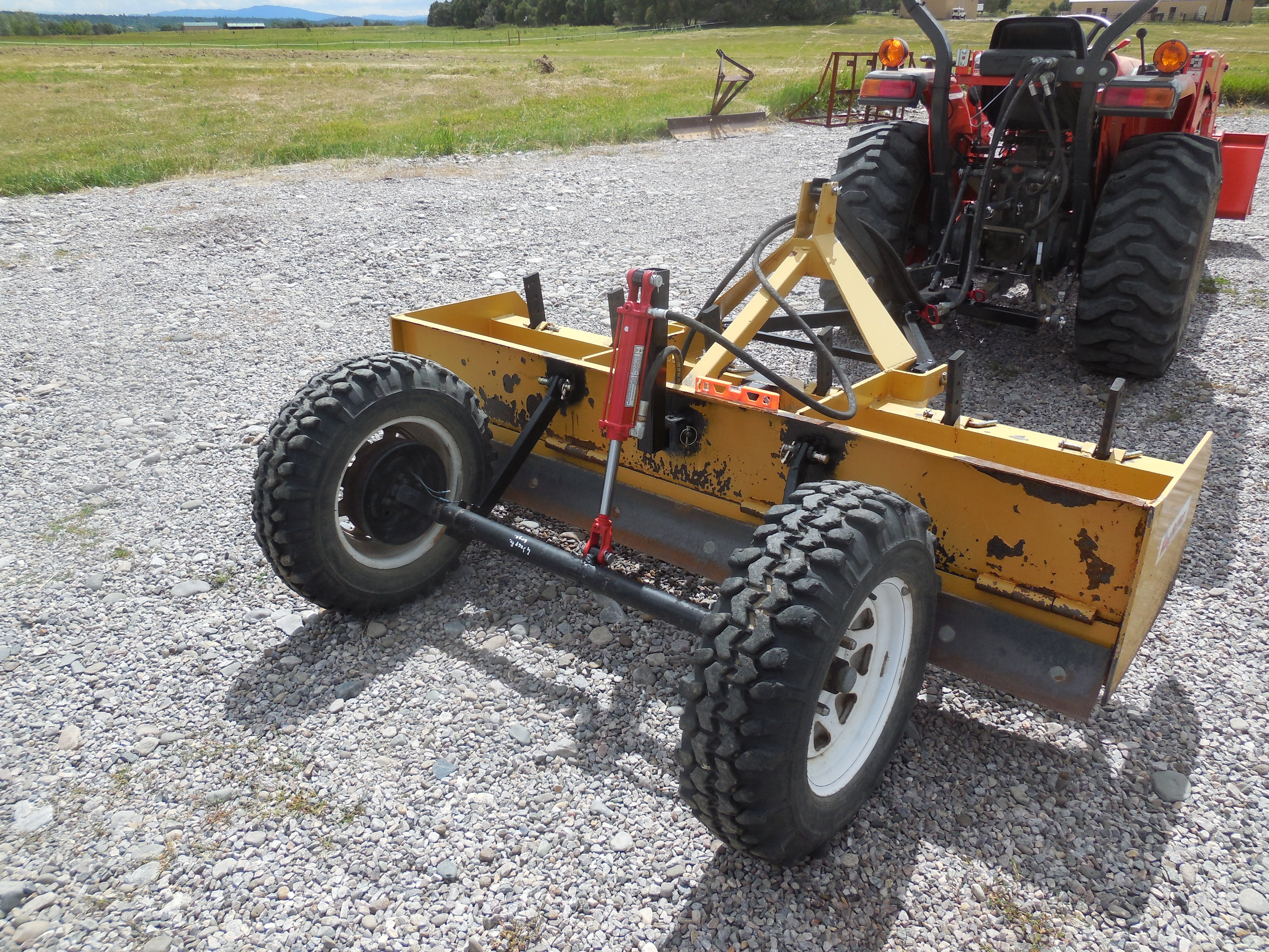

/ wheeled three point box blade #12
Here it is...without the extension.
An old trailer axle and some scrap metal put to use. Had to buy the cylinder since I didn't have one the right size.
/ wheeled three point box blade #13
I am thinking of adding wheels to the back of my box blade
I have wheels in back of my 8' box blade, :D:
