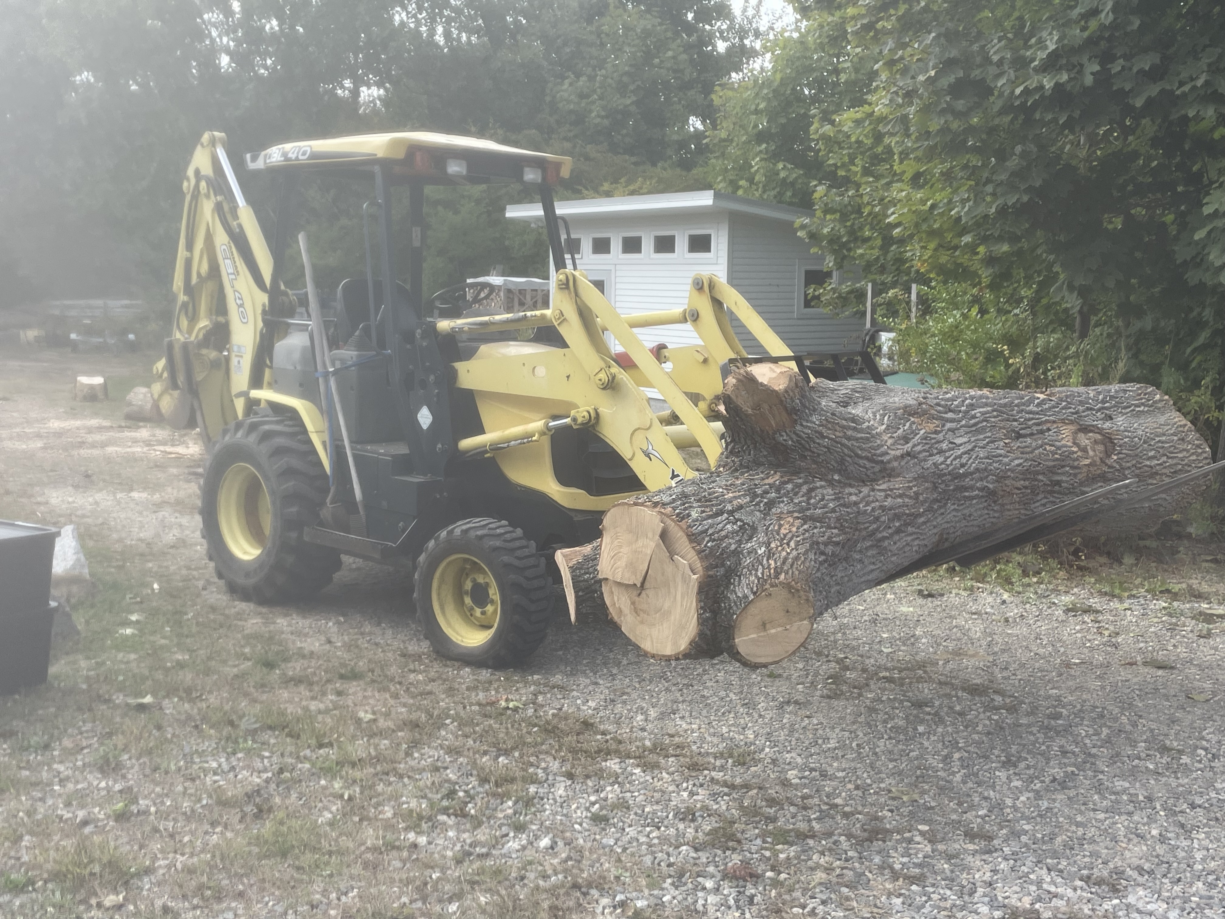

Do you have the CBL40 3-point hitch option, and do you ever use it?
/ How to remove pin
#12
It has it, but I don’t think the backhoe has ever been off. Although I did see a york rake kicking around so it might get taken off every once and awhile. Not my machine.

I’m borrowing a yanmar cbl 40 from a friend. The deal is I grease and change oil. I was not able to get the thumb cylinder at thumb to take grease. Fitting is ok. I did everything I could do. Next step is to remove the pin. Before I start bashing on things I’m wondering if the pin has caps or something on it. The retaining bolt comes out fine, but the ends of the pin have little threaded holes. Are those caps that need to come off to access the pin or is it the pin itself?
