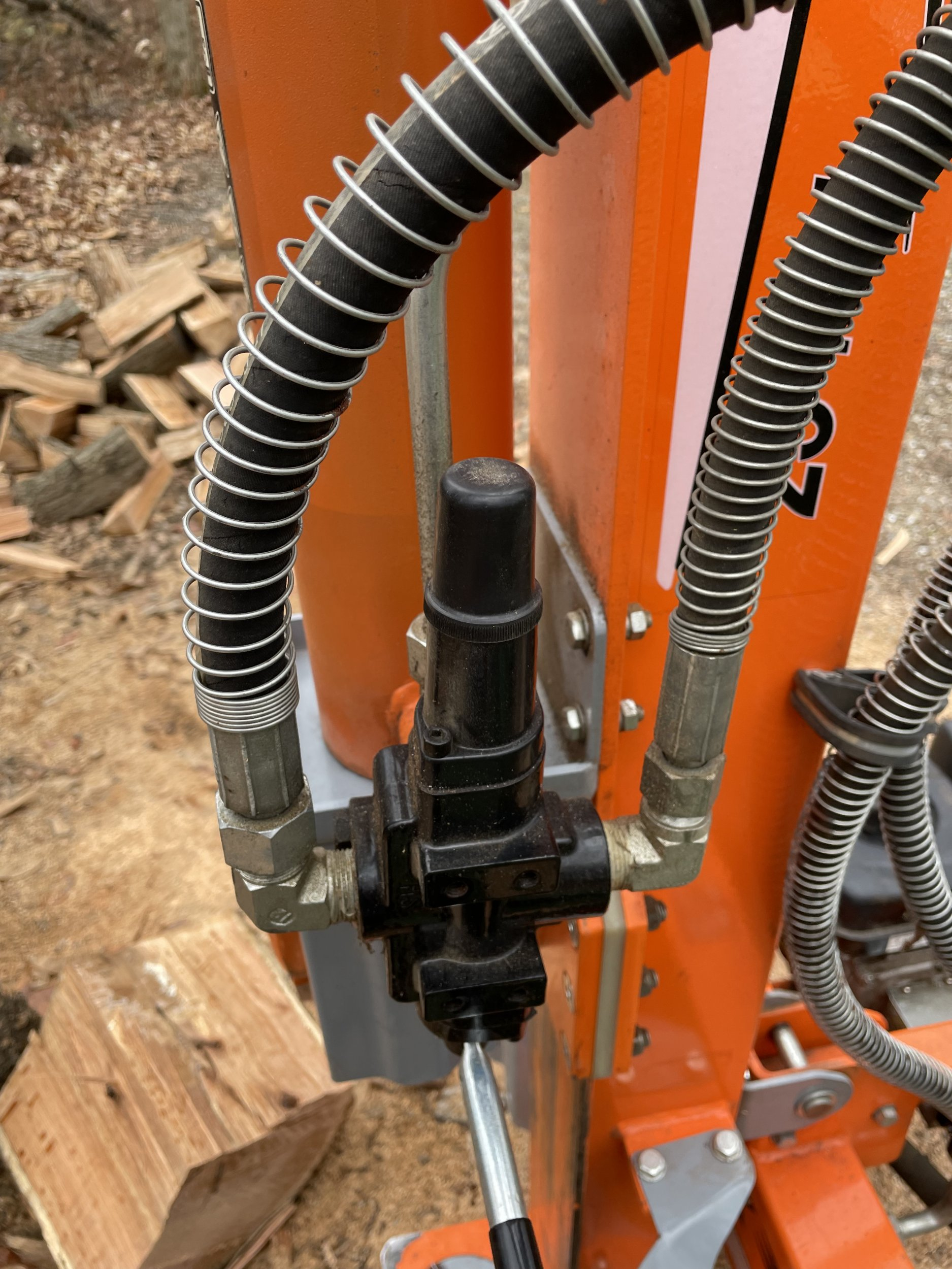

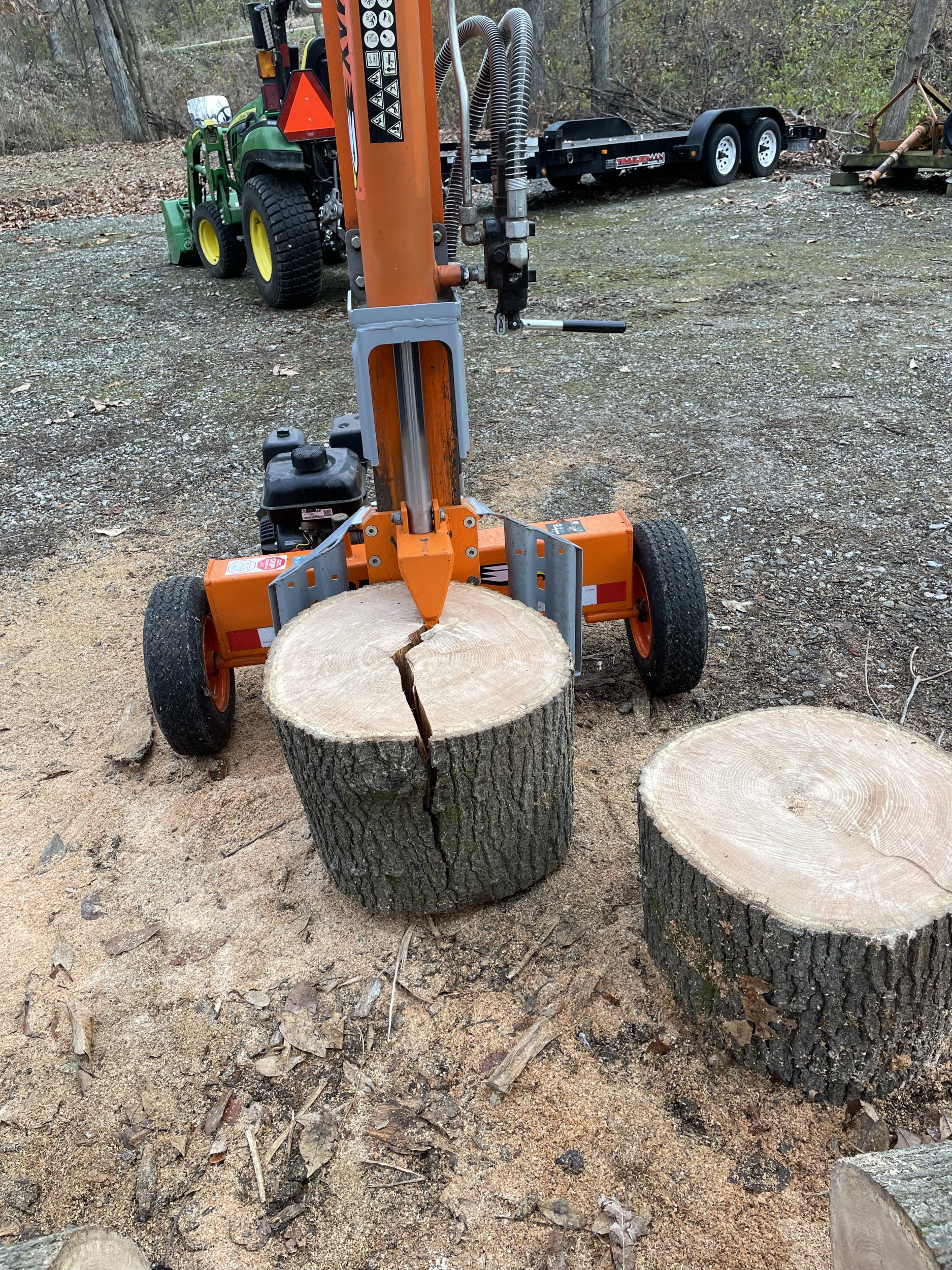

Kind of a minor issue with the auto return on my splitter. In the horizontal position the auto return works fine. In the vertical position it doesn’t. It might return a few inches or most the way but hardly ever all the way. It goes into the detent but then pops out. I think it’s because when my splitter is vertical it shakes a lot. The hydraulic cylinder is pinned at the top but it has some play. I think it’s suppose to be this way but when vertical the hydraulic cylinder shakes a little and I think this just shakes it out of detent. I’m not sure about this.
A couple of pictures. One close up shows the valve, which has a cap on top. With the cap off there is an adjustment, which shows in the last picture. I assume this controls the pressure but am not sure. Either way not a big deal, I’m just wondering if there is an easy fix.

That should be your detent adjustment. Loosen the locking nut (big) then tighten the detent adjustment (allen), righty tighty...to tighten your detent. 1/4 turn at a time and don't loosen it while the system has pressure/flow.

So that adjustment on top is for the detent? That’s what I was hoping to hear.
I got back to using it today and this fixed it, one quarter turn.
