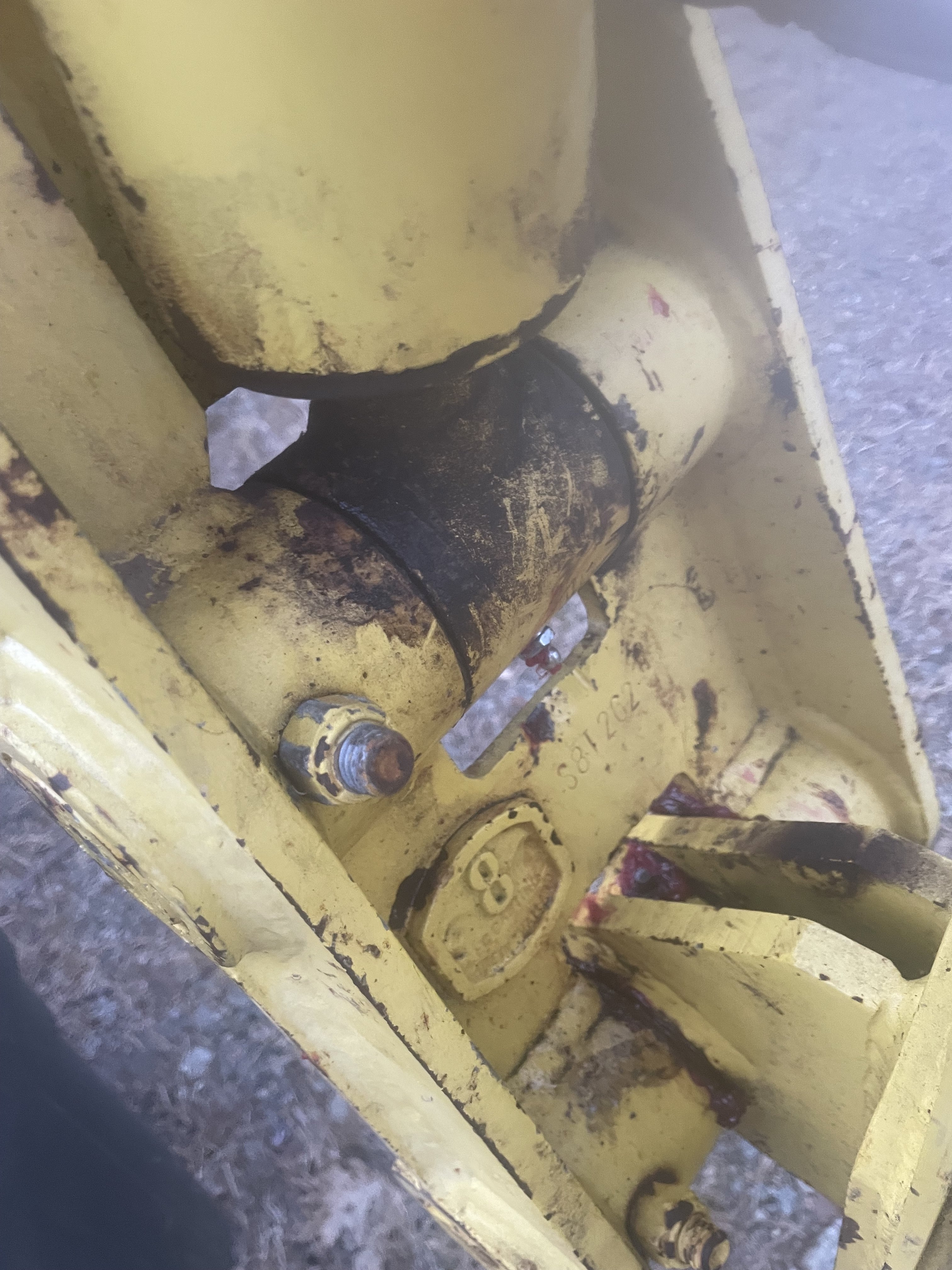

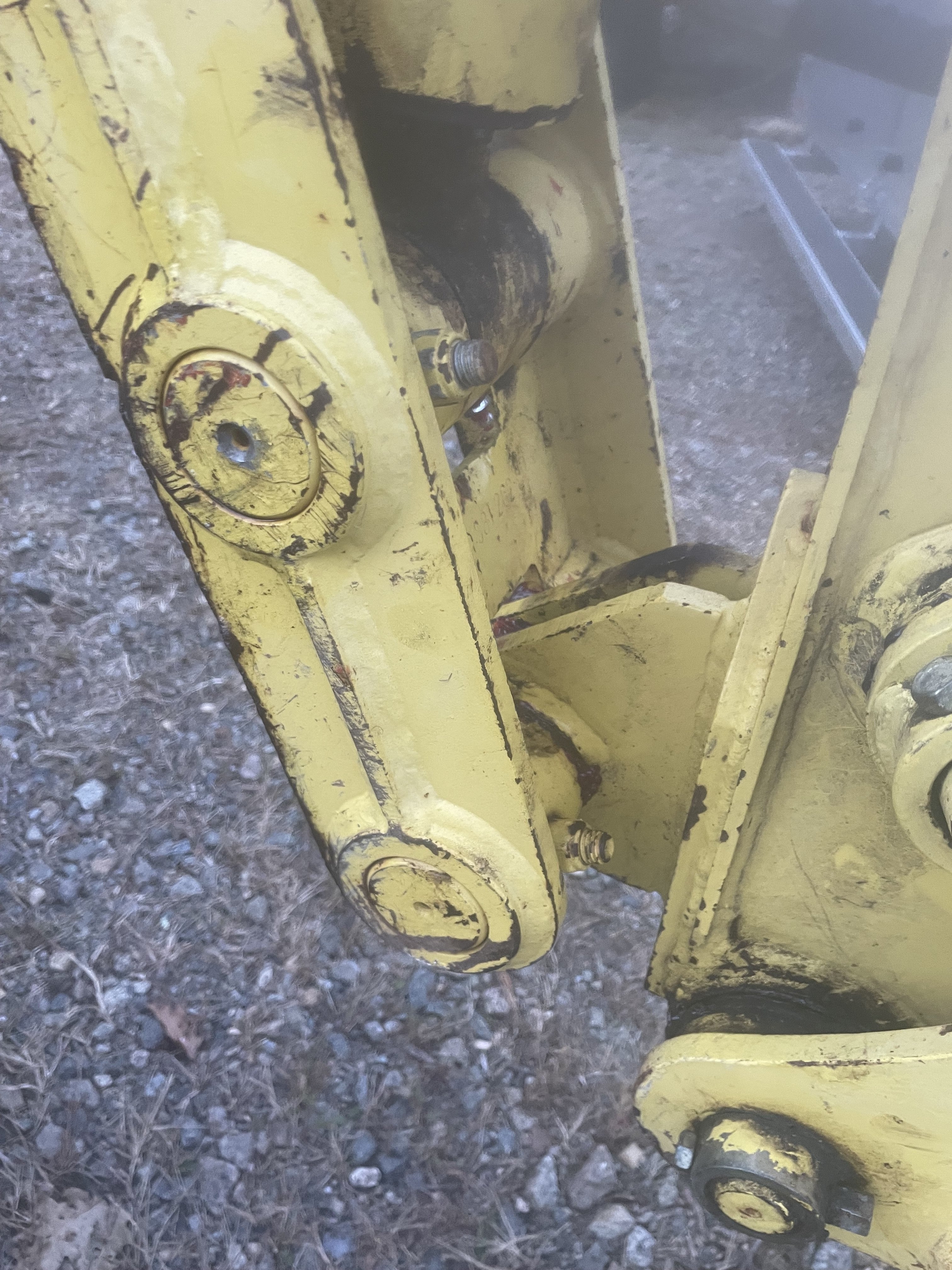

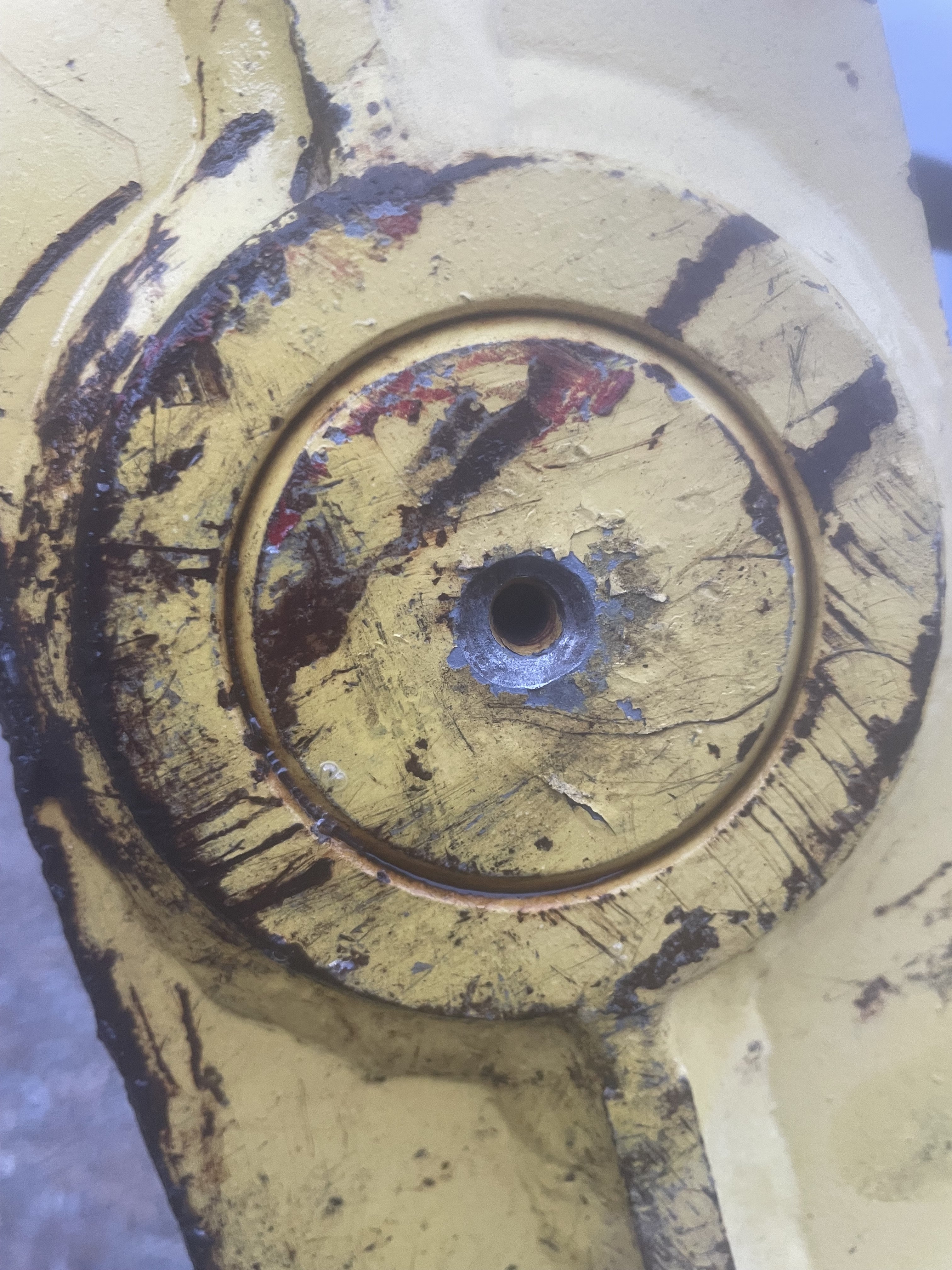

I’m borrowing a yanmar cbl 40 from a friend. The deal is I grease and change oil. I was not able to get the thumb cylinder at thumb to take grease. Fitting is ok. I did everything I could do. Next step is to remove the pin. Before I start bashing on things I’m wondering if the pin has caps or something on it. The retaining bolt comes out fine, but the ends of the pin have little threaded holes. Are those caps that need to come off to access the pin or is it the pin itself?
Thanks,
Nick.

I will add that the cylinder does move around on the pin, so I’m assuming the pin is rusted up on the sides to the thumb.

Looks like you need to remove the bolt in the last picture and it should come out with some persuasive hammering
/ How to remove pin #4
I usually try removing the grease fitting and drilling the old grease out behind it before I remove the pin. Also put the grease fitting on the grease gun while it’s removed and see if it flows through easily. I’ve seen them get stopped up.

Might try cleaning out as much old grease as you can, then make a half damn on the hole with grease. Spray penetrant in the hole, replace zerk and try and pump grease. You'll get some resistance, but hold pressure on it. Once the liquid starts through, grease will follow. A decent gun will produce 12K psi, so should push the liquid through. I've had a 99% success rate using this method.
That is, unless the bushing has spun away from the hole.

Fitting flows. I took it off and sprayed penetrating fluid in there with compressed air. Nothing. I’ll try scraping out the hole. Kinda crappy access.

Once keeper bolt is out nothing should be keeping pin from moving but rust.... Did you try running a small drill bit (under size- by hand) down pin to clear any old grease out of passage?

That pin might not come out easily. I've had some luck on similar pins with an old heavy two-jaw puller with long enough legs. The center of the puller will sometimes push on pins enough to get them to move. It usually requires torch heat + hammering, too. The counter sunk hole helps locate the puller center bolt

It’s really a sweet little machine. Very solid. My ford 1720 is a joke compared to it. This one only has about 475 hours on it. I was able to get the fitting to take grease and I’m not going to bother with trying to get the pin out. We can cross that bridge when we need to. Thanks for all the suggestions. I went back in and cleaned out the hole better with the grease fitting removed. That did the trick.

Would like to second the use of an impact tool with penetrating oil. first briefly heat the zerk, then run two or three rounds of oil with a hammer. return the next day, repeat if necessary, usually works.

I worked many years as a field service heavy equipment mechanic. Heat the pin boss with a good torch , get it good and hot, oil the ends so it draws the oil into the space between the pin and pin boss . hit the pin boss with a heavy hammer, then try flush greasing. If the pin boss does not have grease fittings you may want to drill and tap , and add grease fittings to the pin boss. most pins I have worked with in the past were drilled to provide lube to the cylinder end and not the attachment, grease goes to the middle of the pin and is forced to the outer ends. . after torching out a few of these I started adding grease fittings .

Why would you try to do this when pin is stationary in boss.... Actually what you really want to do is clear grease passage in pin so end of ram is lubricated on pin....
